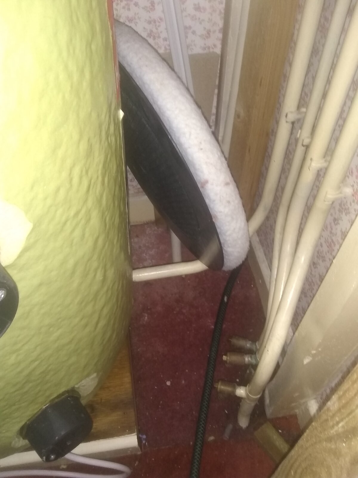

Pic of the bottom feed.
It has been painted white, I guess I need to scrape the paint off before putting on the self piercing tap?

Depends.....
I can do a bit of plumbing, (Just) so i'd just drain it off, and add in the cock whilst i was fitting the new immersion.
However, whilst a tap will work, it does interfere with the flow rate through the header pipe and isn't the most secure of tappings so is a risk of leaks in the future. I'd use a std compression tee. Easy enough and reasonably secure. I imagine the solder and flux addicts might not agree.....
Beware those self-piercing taps- the disc of copper it punches out has to go somewhere.
I fitted one at mum's house probably 20 years ago (for a dishwasher)- sealed fine, dishwasher works, hurrah. Turned the kitchen tap on to fill the kettle up (v good mains pressure), it wouldn't turn off. Water off again, stripped kitchen tap- there it was in the tap seat, 6mm or so copper disc.
Far better to drain as advised above then tee off the bottom tube & fit a drain valve as part of the job
