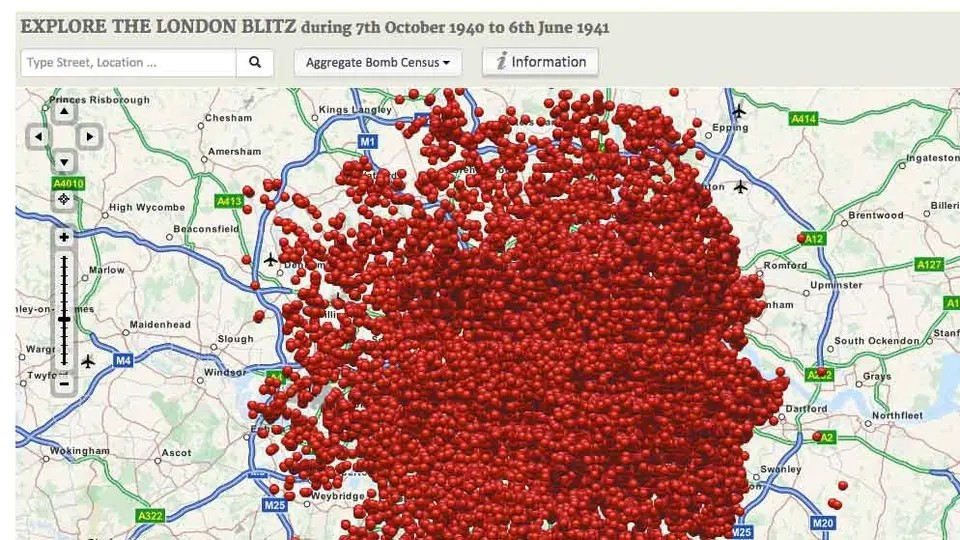

North East London is definitely near all of those. You have heard of the Blitz?
You'll have to explain the significance as we are surely not close enough for any of those things you mention to be causing the smell in our property but not others around!
Wartime bombing ripples the ground and shakes the houses. Your London clay moved. It is quite normal for drains to be broken where the pipe in the soft ground rigidly joined to the house. The pipes were made of fired clay.
Sometimes builders cover up problems so you can't see them, it is less arduous than repairing the fault.
I don't know how many of your neighbours have dug out and repaired their drains in the last 80 years. It might be quite a few.
Is there a red blob near your house? This map shows only a 9 month period.
