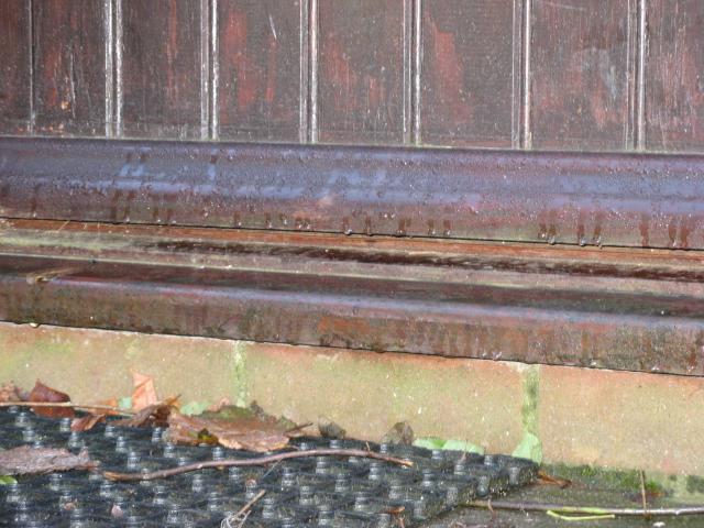

Hi all
Got a bit of a gale coming from the bottom of my front door and wondered if anyone can tell me what the best option would be to seal it. Seems there are quite a few to choose from. Not even sure if it is best to get something that fits to the outside or inside.
Pics below...
Many thanks
Max
If the door is not used much, get one of thos snake fabric things, will look nice & its quick & easy.
The door is used a fair bit. We use the back and front doors as much as each other.
We were planning to get a snake fabric thing to put to the door when we are indoors. But we were hoping to go belt and braces and get something else as well. Plus, if there was another draught excluder it would help keep the cold air at bay when we are out.
Cheers
The draught will be coming over the weather bar try some foam under the door on the part of the rebate that closes onto the weather bar, alternativley change the weather bar for one with a weather seal attached
