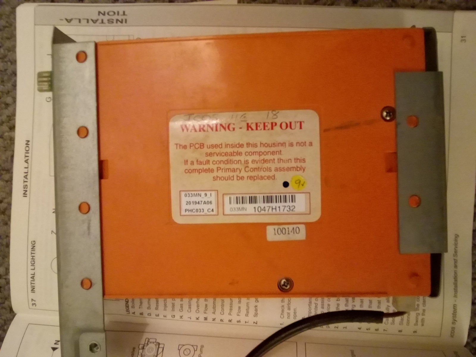

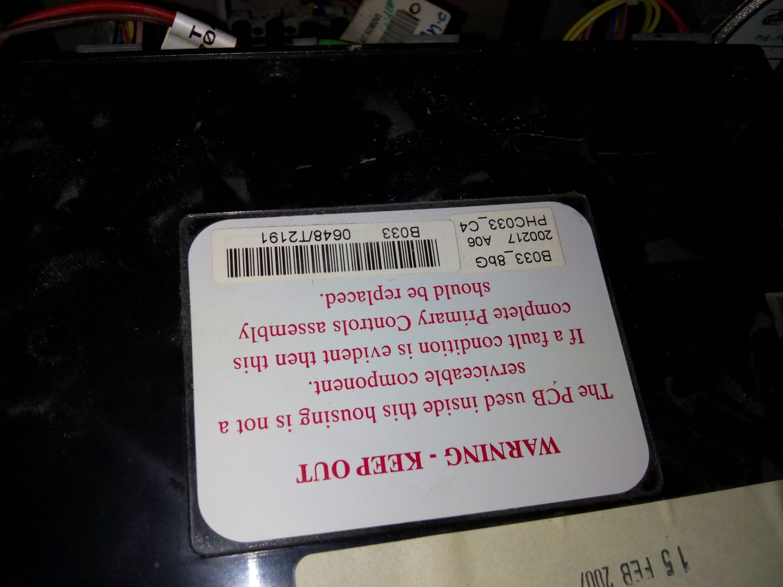

So, an engineer came while I was still at work. He told the Mrs, the PCB was dead (and a high figure to replace it, though recommending a new boiler).
We were given three years ago by another engineer a used PCB (from a functioning boiler he replaced elsewhere) to keep as a spare part. The chap today first claimed this PCB we kept was a different board, then that he measured it and it was dead anyway.
I attach photos of the two. The numbers at the bottom are identical, so are they replacements for each other? And I got a multimeter, can I test myself whether the spare PCB (orange) is defunct?
