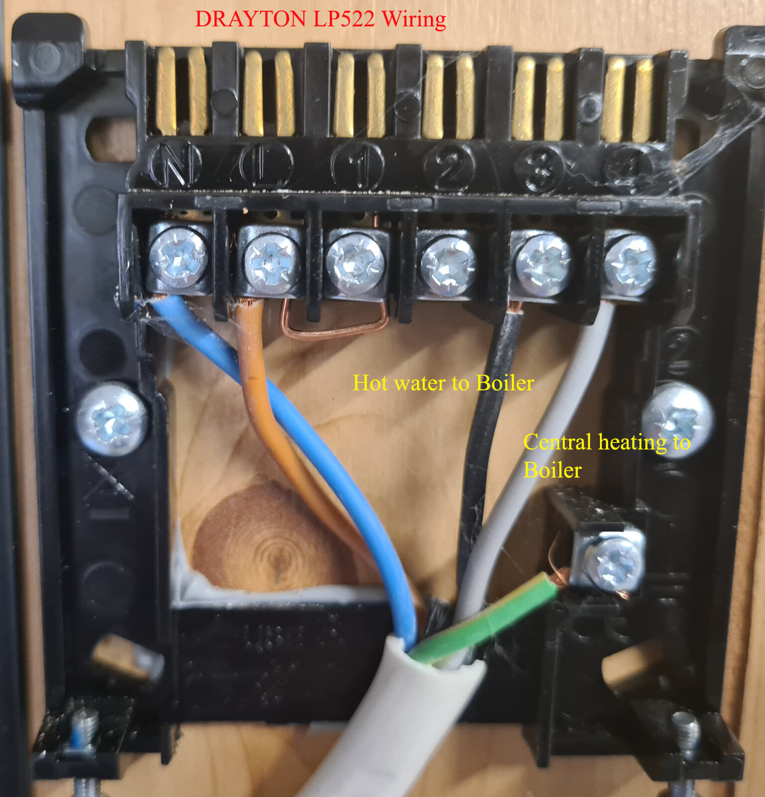

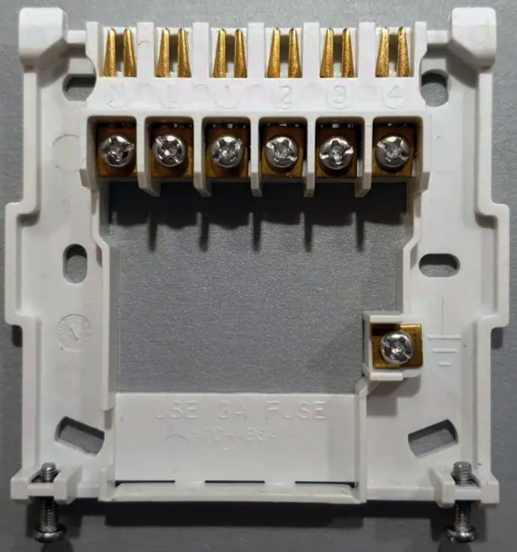

Hi im after a little help
I want to wire in a Drayton Digistat SCR to a Drayton LP522 programmer for the Central heating current programmer wiring is shown below , I understand the L N & earth wiring from the LP522 to the SCR its just the heating wiring Im stuck on, thanks Simon

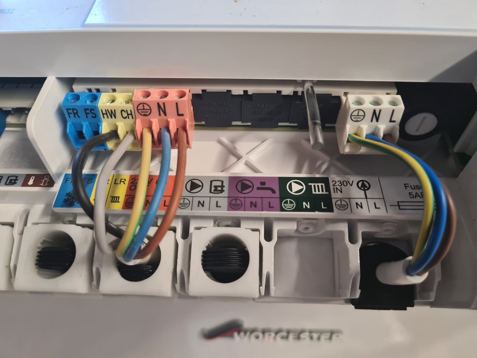

Chris its been wired into a Worcester Bosch Green star Heatslave oil combi by the installer, its in my elderly mothers house with no wi fi eatc or else would have gone down the hive route

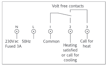

What you need to do is alter the wiring, so the grey from 4 on LP522 goes to the common of the digitstat and then the heating on from thermostat goes to the LR at the boiler.
The LP522
and the SCR
need the N and L connected in parallel i.e. L to L and N to N, and the wire from 4 on the LP522 goes to 1 on the SCR and a wire from 2 on SCR to 4 on the LP522 in other words in series.
