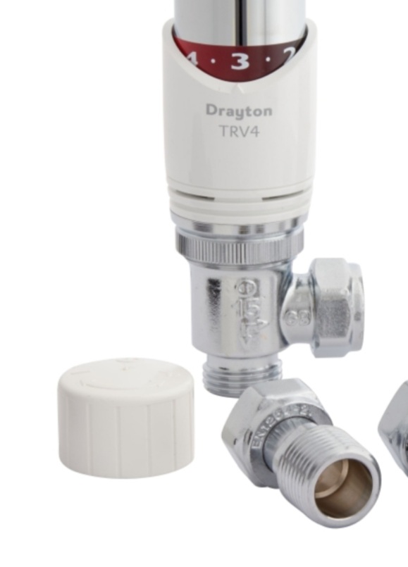

Hi,
I’m trying to drain and remove a radiator. One end is a Drayton TRV4x
I’ve turned it as far as it will go. It has a frost setting and no further.
this hasn’t isolated the rad. When I pull it out the valve water shoots out.
how does one go about isolating from this valve as I can’t seem to do this
thanks
Hi,
Something doesn't seem right with the valve! It probably should be shut off at the frost setting (unless your house is freezing!).
Do you by any chance have a cap like this lying around?
it would have come with the valve originally, and should provide a positive stop to the valve (with the head removed).
What I've done with mine was to put it on max, remove the head, unscrew the bolt that connects to the valve (count the turns so that it can be put back to where it was) as much as you can before it comes out, refit the head and close it off then.

Remove the head and use a zip tie across the pin. You might need to use a widget on the pin to keep the tie in place.
Once tight, try again. If it still leaks, the valve is toast.

If you don't know how to remove a trv head and find the videos too much, leave this for the plumber.
You need a little bit of DIYabillity to remove a rad and not create havoc in your house....
I tried pulling the head off but it doesn’t move. Are you saying under the head there’s just a valve like the other side and I can just turn it shut manually?

Go and watch YouTube re: trv videos.
You have a head and a body.
The head is simply attached to the body via a screwed collar.
The body is integral to the plumbing.
You should be able to simply unscrew the collar by hand. If its tight, use a rag for grip.
Lefty loosly, righty tighty....
And whist you about it check and make sure the valve/collar was properly located and tightened up as this may have stopped the valve closing the water off completely in the 1st case

so all I have to do:
remove the trv as shown
Manually turn the valve clockwise till it is shut (I have done this already with the other end)
Then drain radiator down bleeding it in the process.
simple as that?
