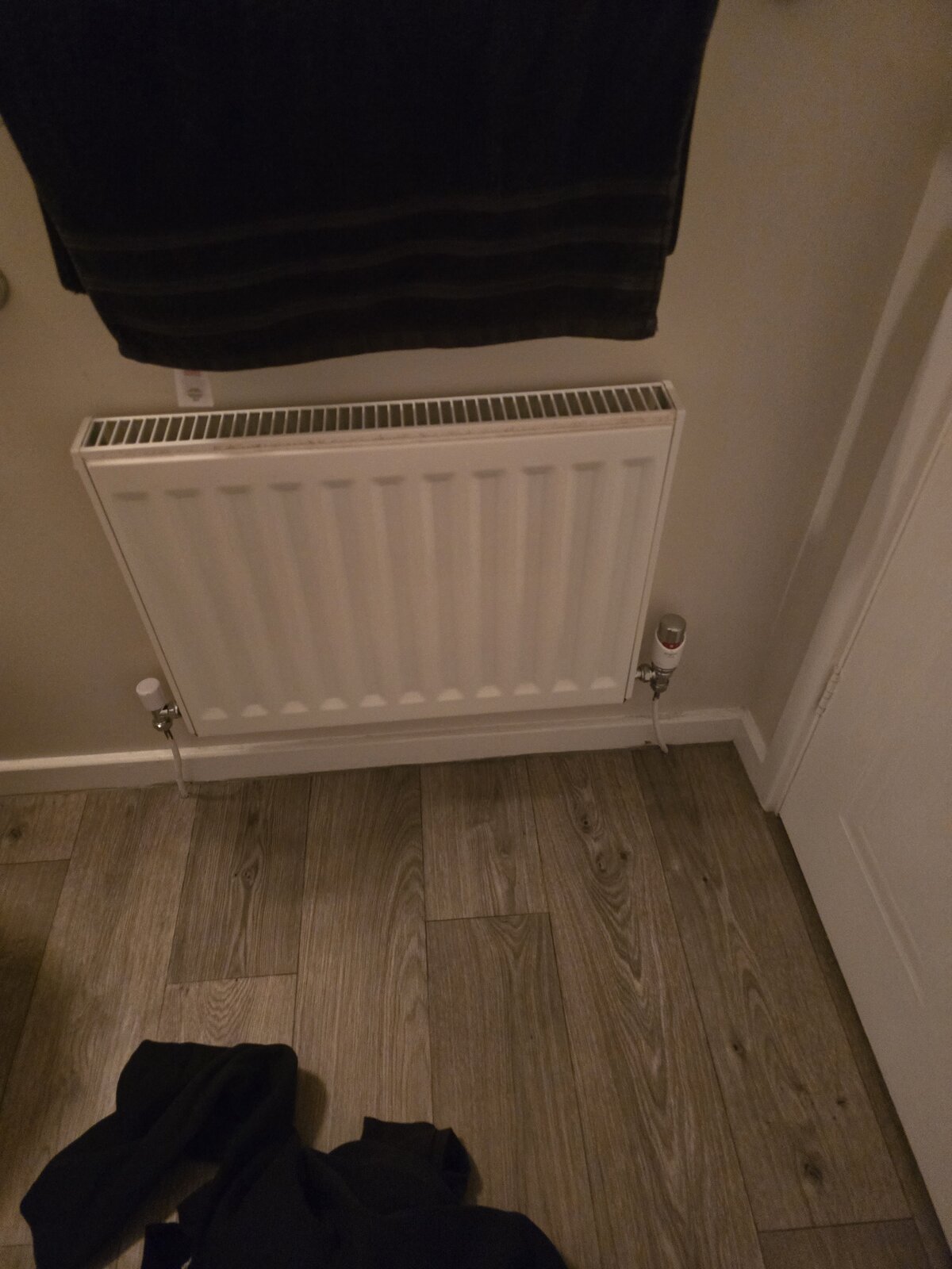

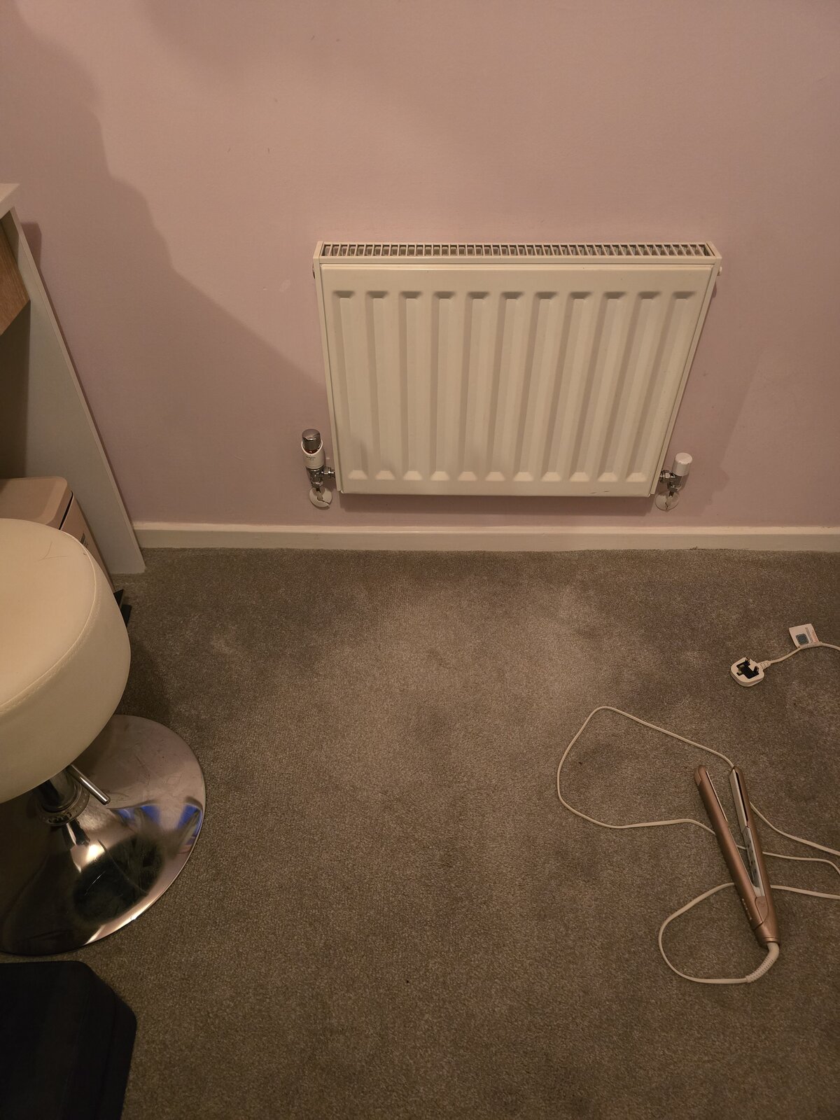

I've fitted drayton 15mm trv4 with reducer onto 8mm microbore. I've put the valve heads on setting 4 and the radiators heat up then switch off and the rads go cold and room goes cold but doesn't seem to switch back on but if I remove the valve head then the radiators get very hot
Yeah it's getting air flow the radiators are under the window but we have got blinds
Can you post a photo of the valve and the surrounding area?

Could be faulty trvs but maybe speak to Drayton technical? I don’t see an issue with the installation

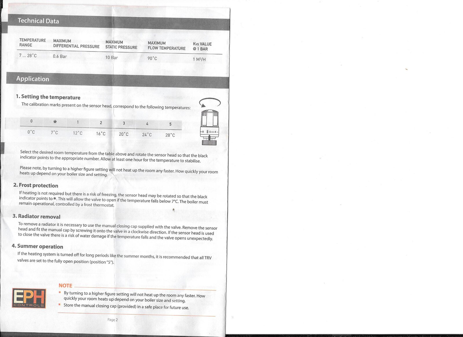

Any idea of what the setting(s) are now, is this internal "lockshield" fully opened and if so what number is it showing?. Normal TRV's will control pretty well as long as the boiler is firing continuously, I've used EPH for years, nothing special but they do give excellent control, maximum setting on these is 5 and a setting of between 2.0 and 3.0 gives me room temps of 16C to 22C, all are installed horizontally, on the rad(s) return as I reckon this gives a more representative room temperature but this has nothing to do with your problem which seems to crop up fairly regularly.
