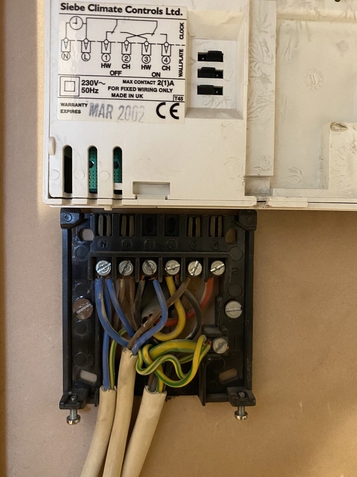

Hi Guys,
can someone help me please? I’m trying to install a nest thermostat in replacement for a British Gas (Drayton) UP1
I haven’t got a clue where any of the wires go :(
Any help will be appreciated

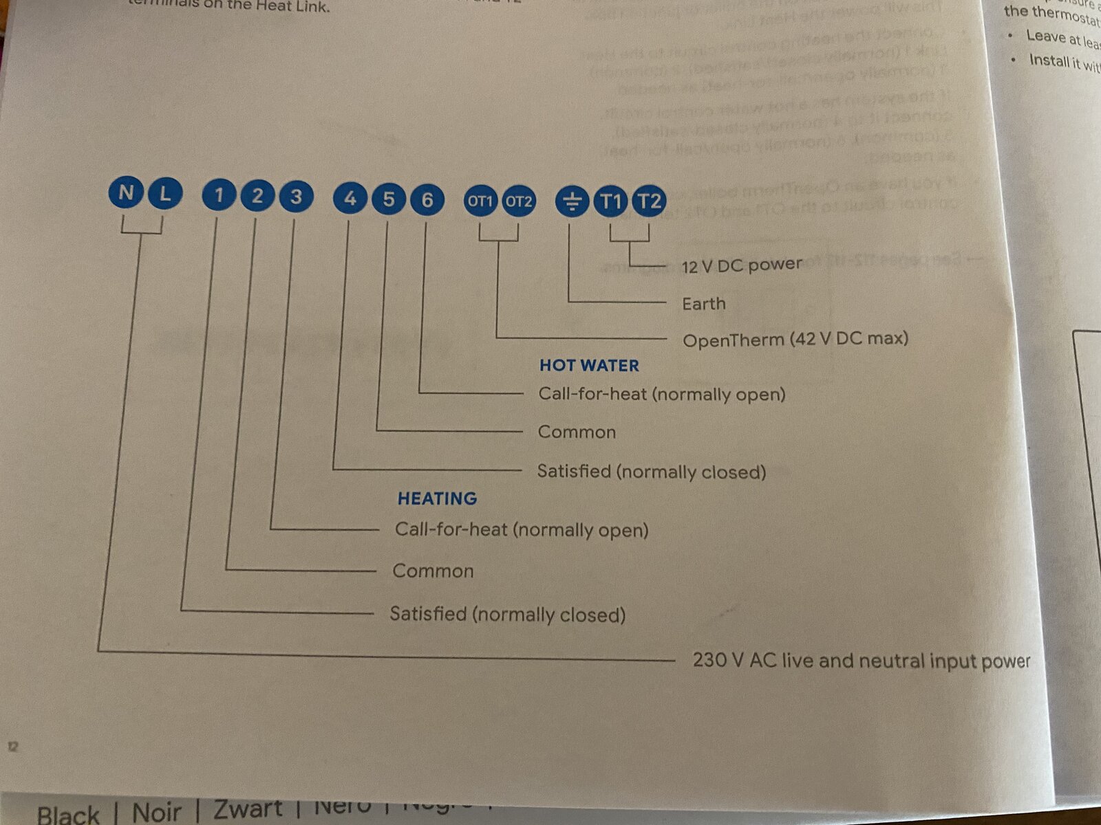

N to N
L to L plus 2 and 5
1 to a junction block, using the wiring diagram it would be 4 however there is no terminal with UP1 so seems likely just used as a junction.
2 to a junction block, using the wiring diagram it would be 2 however there is no terminal with UP1 so seems likely just used as a junction.
3 to 6
4 to 3
T1 and T2 go to thermostat unless being powered using a cradle and USB.
OT1 and OT2 not used.

It looks like you may have a y-plan system. Also Nest doesn’t connect to eBus on boilers.

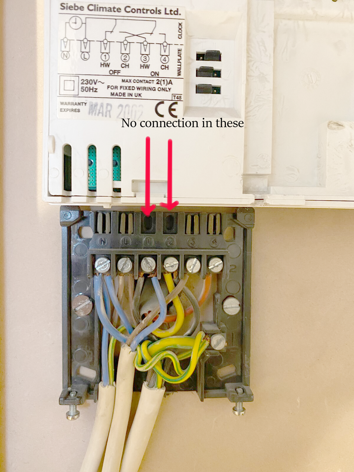

If you look
terminals 1 and 2 do not connect to pins on the programmer/thermostat. So you would need some terminal strip for those wires, Also to get those wires into Nest one would be stuck for room. I ended up with a junction box under the Nest heat link.
Nest does connect to ebus on boilers using opentherm using terminals OT1 and OT2 however not sure if you can use motorised valves and opentherm? I know you can with EPH controls but not with Drayton Wiser, but depends on the boiler, Bosch do not seem to allow use of opentherm.
Y plan need DHW off terminal and since not connected unlikely it is a Y plan.
