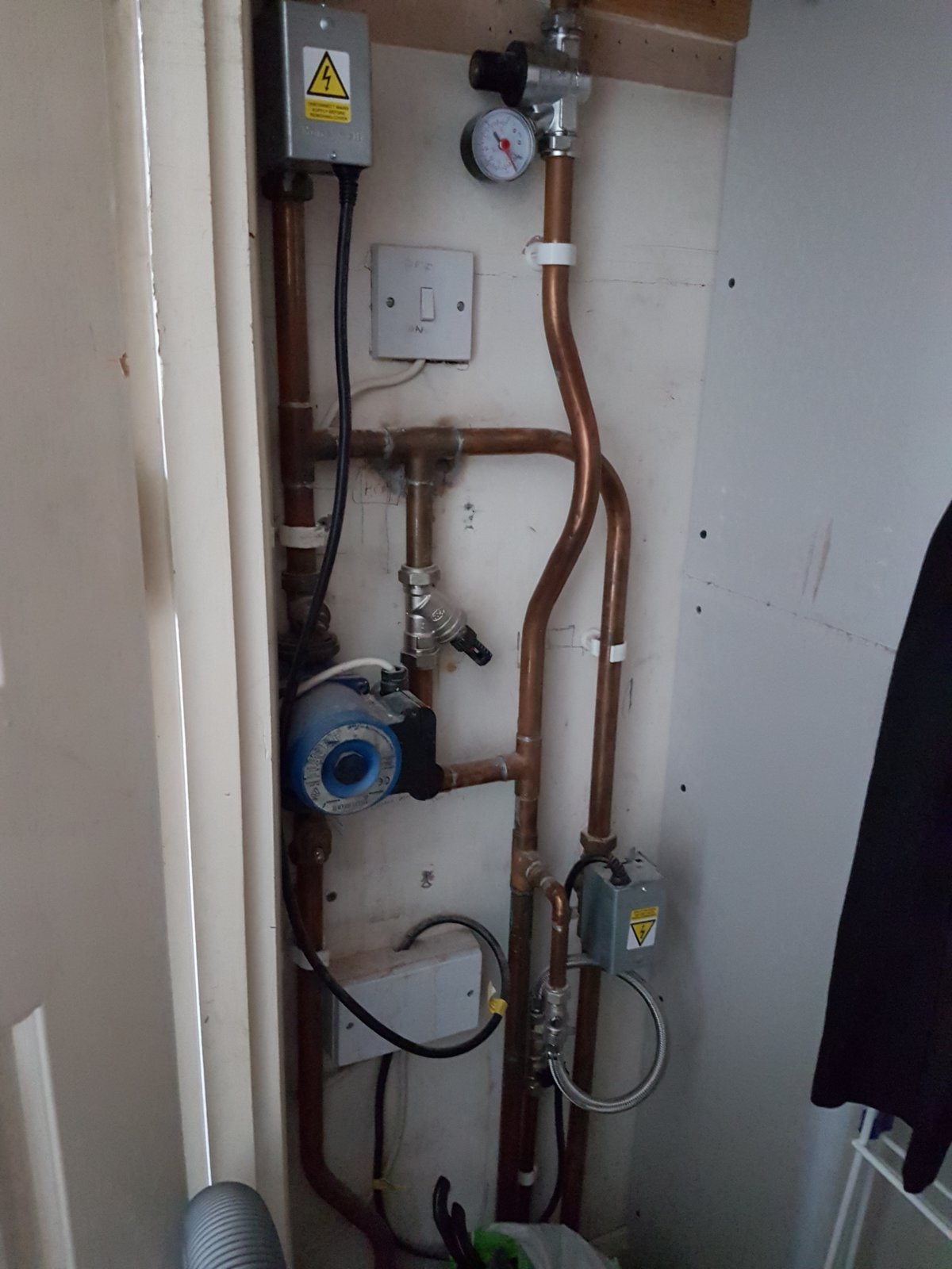

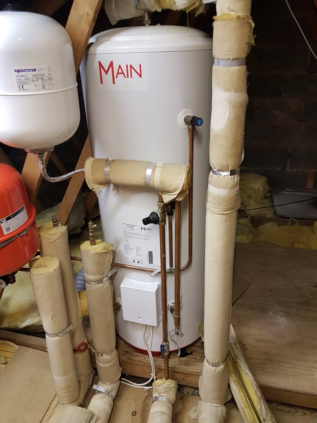

Currently, I have a Vailant Ecotec Plus 418 series boiler which is wired up to a cheapo iflo programmer (clone of Drayton LP112). There is what seems to be pump in the airing cupboard upstairs leading up to the 210ltr unvented cylinder in the loft. In the dining room there is an ancient Drayton RTE room thermostat.

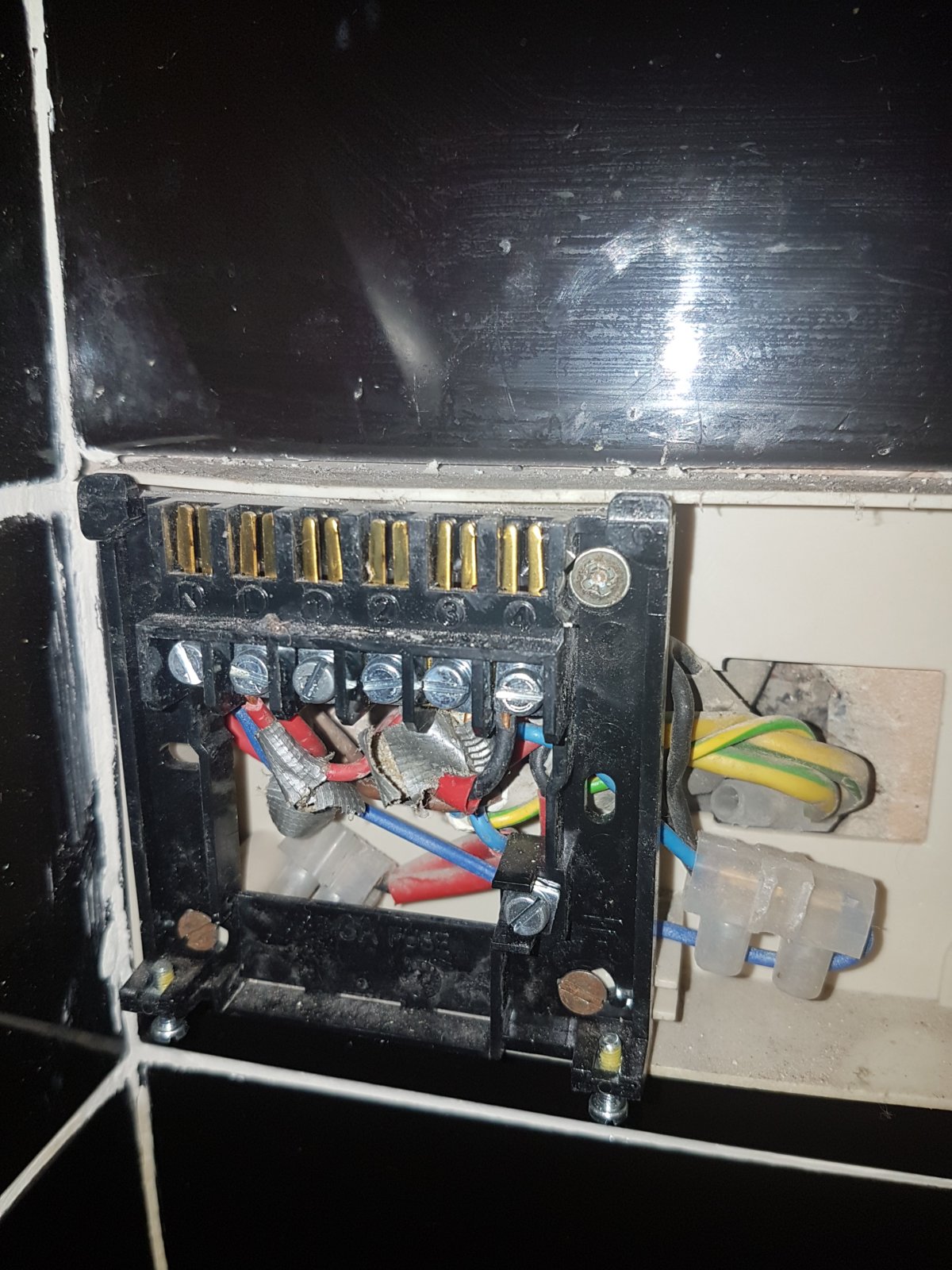

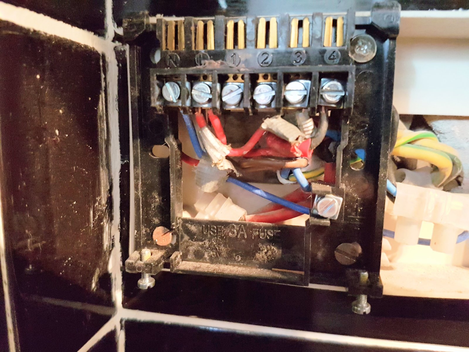

The nest instructions talk about S plan and Y plan systems, and I'm not sure which I have. Also, after taking the front off the programmer and looking at the wiring, im still none the wiser as to which might be going to the thermostat so I'm hoping someone might be able to help figure out what these are and then relate them to where they need to go in the heatlink:
Current programmer wiring:
N (Neutral) 1 Blue (neutral) cable from wall
L (Live) 2 Red (Live) cables from wall
1 (HW off) Empty
2 (CH off) Empty
3 (HW on) 1 Red (Live) cable from wall
4 (CH on) 1 Red/black (Live) cable from wall

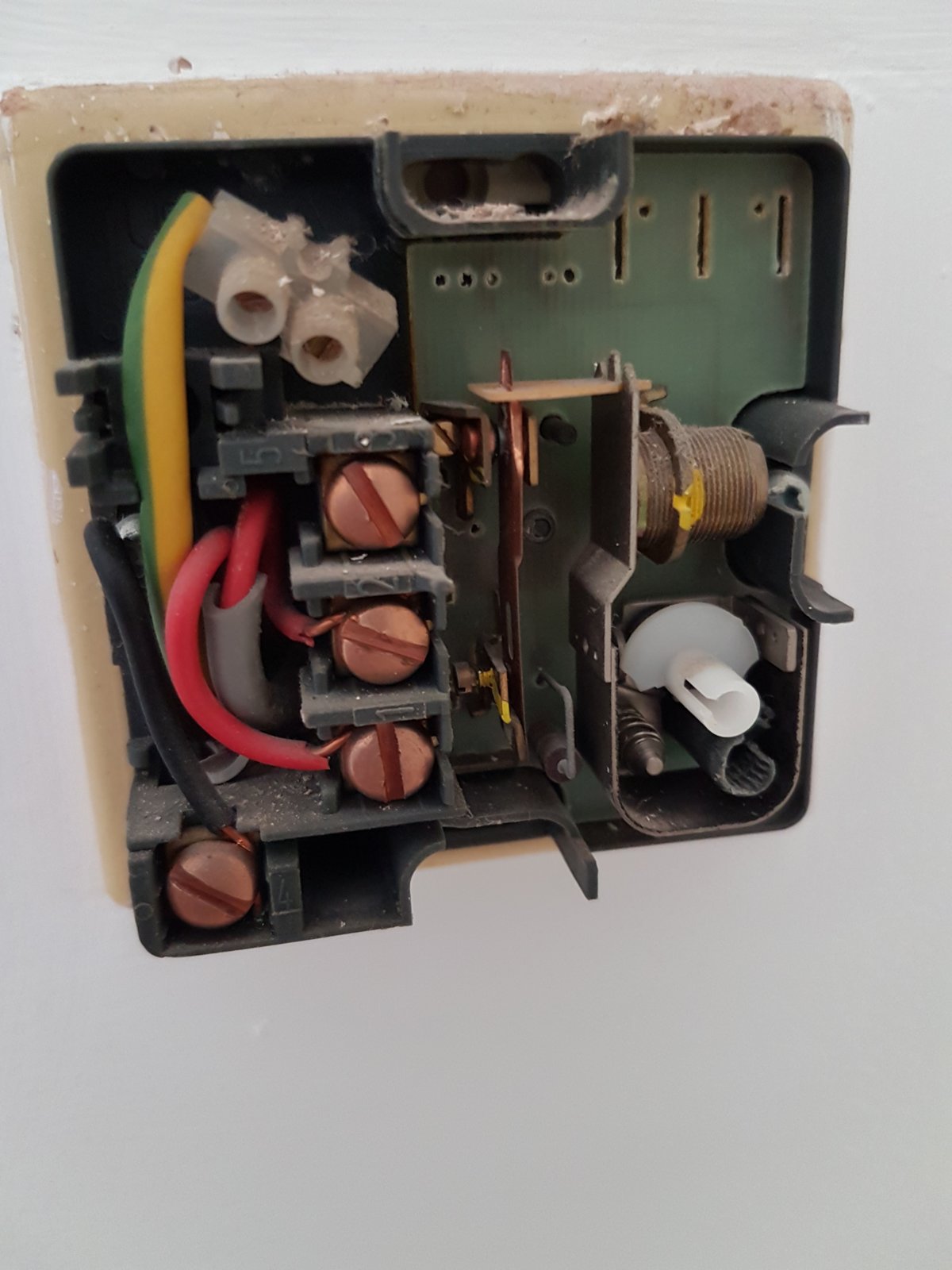

The Drayton thermostat internals are as the picture below:

Airing cupboard pump
Unvented Cylinder

C, Identify which wires are likely to be from the thermostat so they can be reused for the Nest thermostat.

The Honeywell plans also had Honeywell junction boxes with designated wires into the holes, however many builders used socket back boxes with lid and a simple connector block inside, and did not follow standard wiring.
I had one in daughters house and carefully tried to work out a fault, I tried following the wiring diagram.
for the Y system.
However the micro switch shown is actually three micro switches, it was a micro switch that had failed, but the tests I used to try and work out how wired were showing strange results due to extra micro switches not shown, I did sort it, but it was not an easy task.
