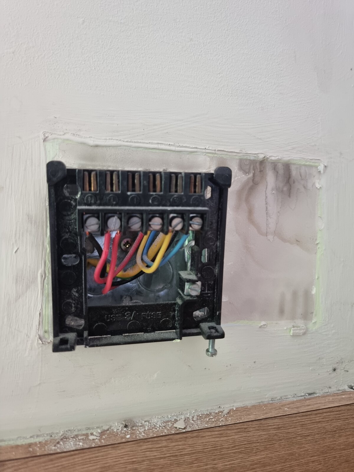

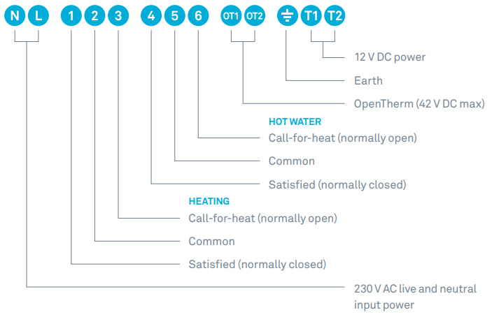

Hi,
I'm trying to remove an old Drayton programmer and replace it with Nest heatlink. I've noticed a post already on here with the same system as mine but the cabling is done differently on their programmer. I have 2 cables going into the neutral terminal whereas the other person on here had 1 and then another in the terminal next to the N.
Can someone advise on how to wire this up to nest heatlink please? I also have 2 thermostats in the house, one in hall and one near boiler. Do I have to remove these? (One will be replaced with Nest controller)
It looks to me as if you have:
One black into N
Two reds into L
A yellow into 3
A blue into 4
And an earth connection to the backbox.
The connections on the Drayton should be listed on the programmer, terminal 3 is usually Hot Water On and 4 is C/H on.

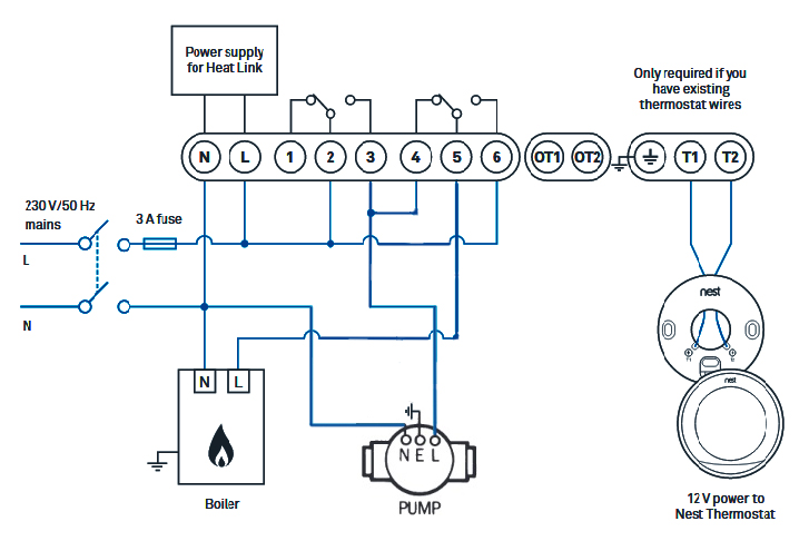

If the above connections are correct, to connect the Heat Link,
Black in N to N
Two Reds in L to L

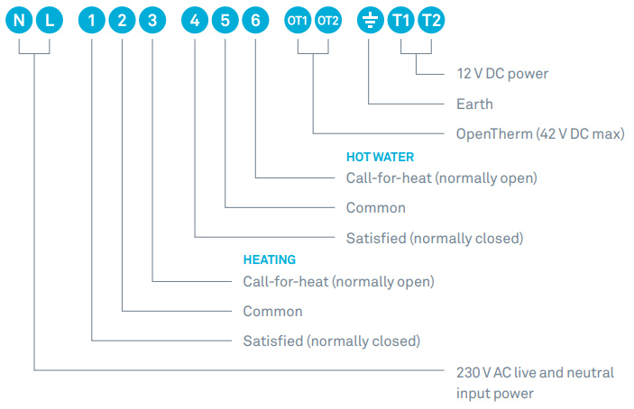

Yellow in 3 to Heat Link 6
Blue in 4 to Heat Link 3
Link wires will also need to be added between L and the common terminals 2 and 5 on the Heat Link.
This may be a little difficult, as the terminals on the Heat Link are small and you need three wires into the L.
If you are struggling, these connections can be made with a terminal block/wago within the back box, and a single wire can be taken to the Nest.
Your existing thermostats can be kept and turned up to maximum, or removed, but you will have to trace the cables back to the wiring centre and bridge them out.
If you wish to use the Nest thermostat with terminals T1 and T2 and reuse the existing cabling, some further investigation of the cabling and wiring centre will be needed.
Running a new cable may be simpler.
An earth connection to the Heat Link will also be needed.

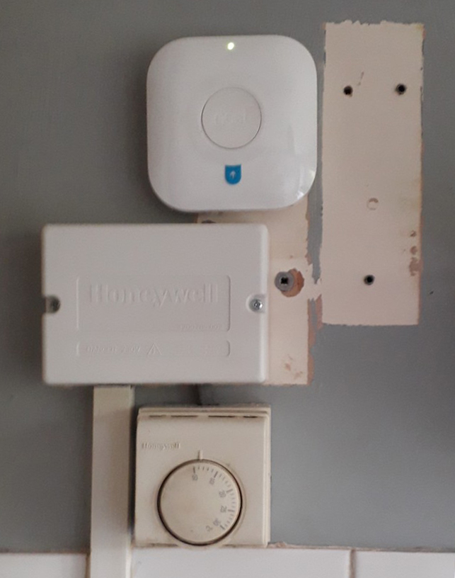

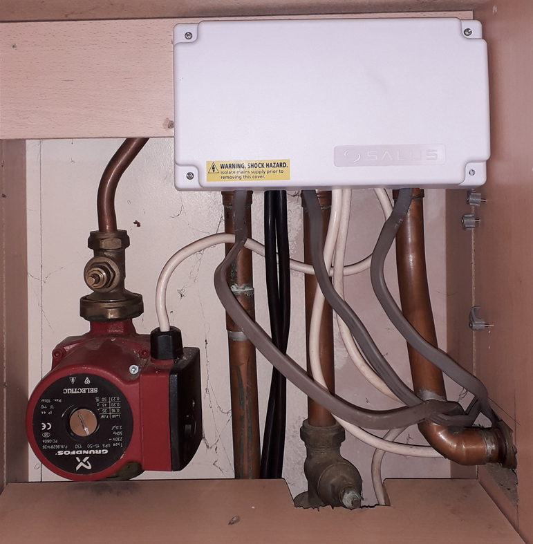

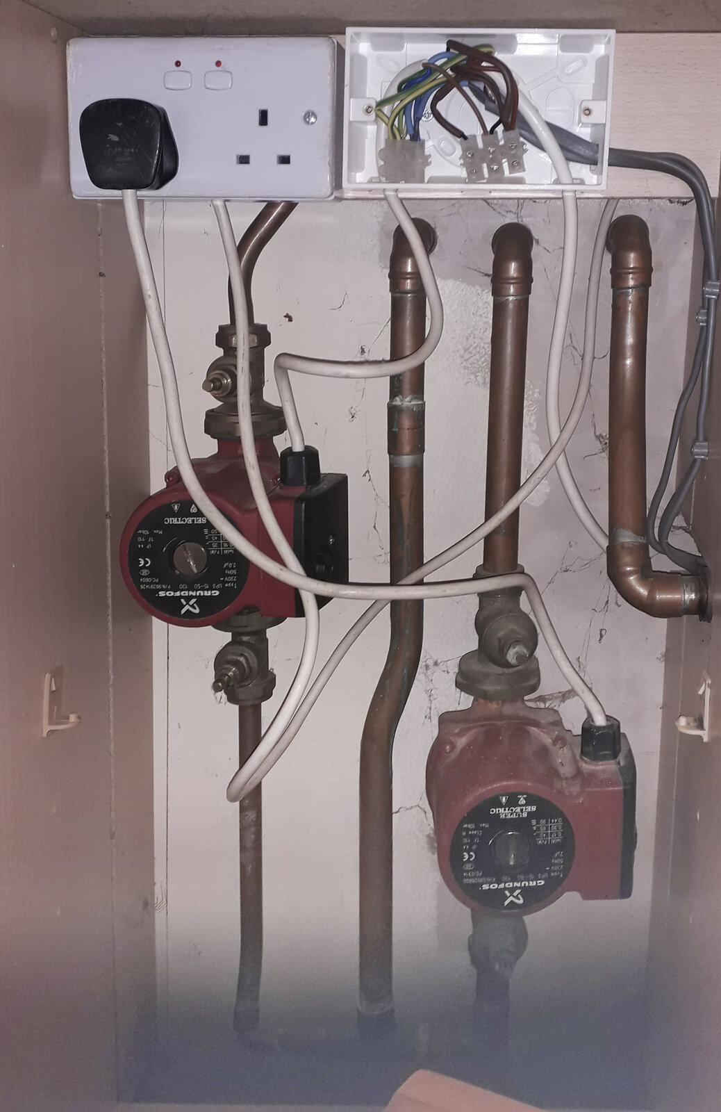

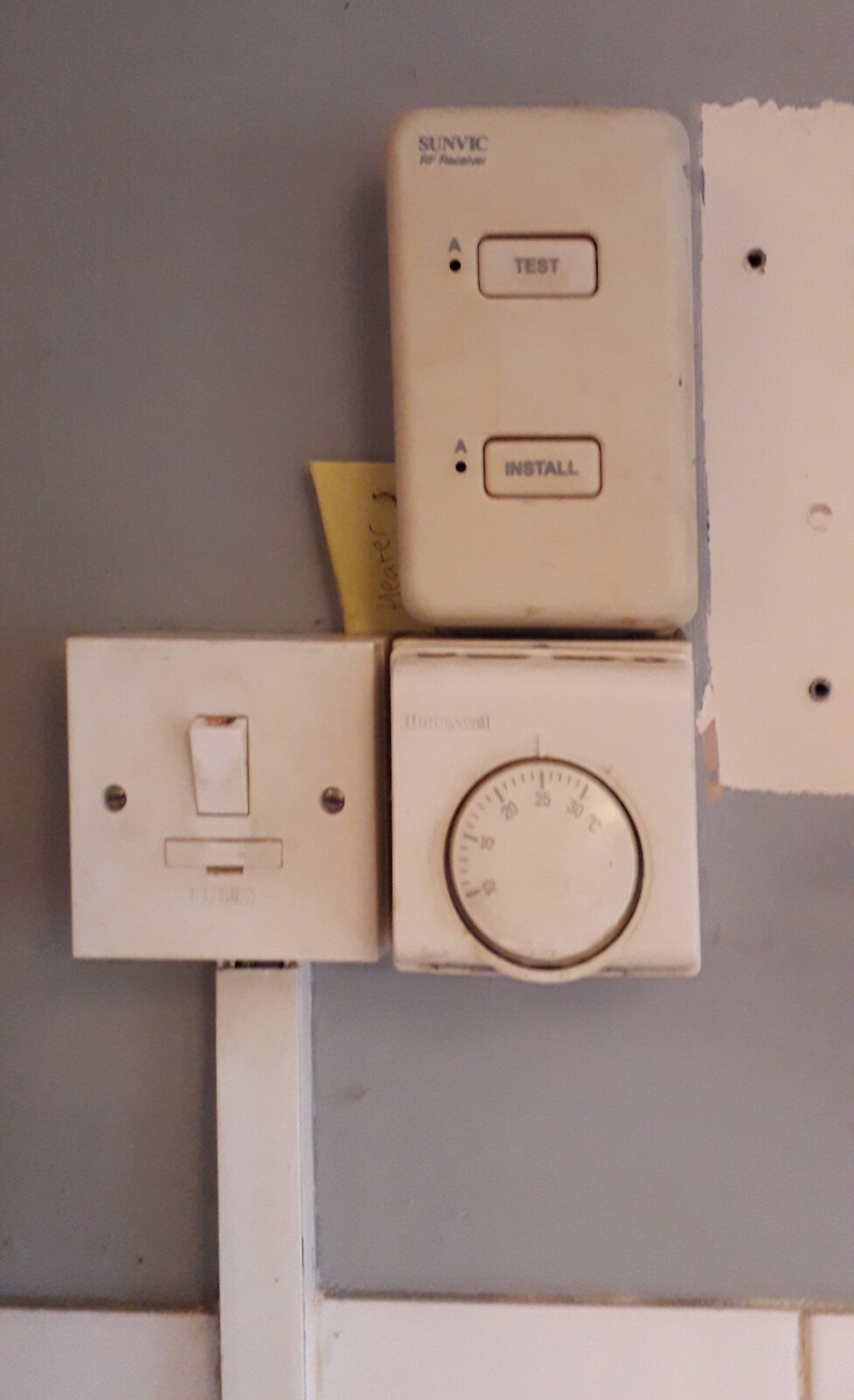

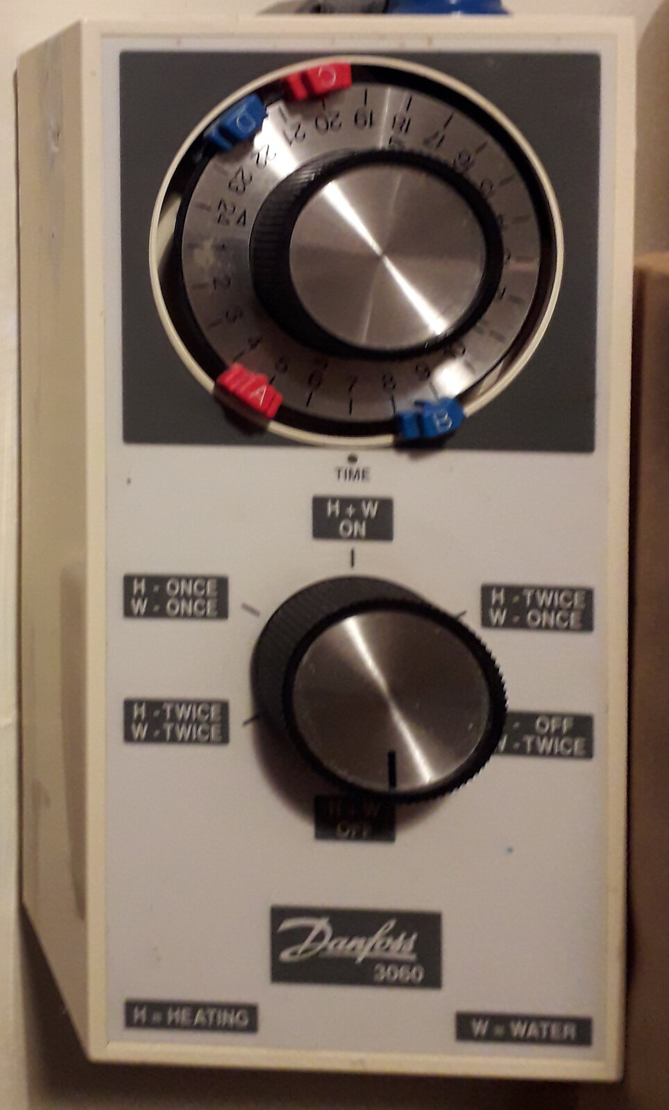

I went from this 20190619_063642.jpg to this New_wiring_centre_etc.jpg there was no way I was going to get all the wires into the Nest so used a wiring centre. Next to the boiler also needed modifying, 20190619_063750.jpg I used a smart socket while working out what needed to be done, then a second wiring centre Second_Wiring_Centre_small.jpg I have two pumps which caused a bit of a complication as the water was going in the reverse direction, so needed to all either non return valves or motorised valves, the plumber selected the latter as on the return side, not into plumbing so left it to him.
The old programmer has gone Danfoss3060programmer.jpg now replaced with a blanking plate, with a chock block joining the wires so thermostat in the hall.
After doing it myself, first job is to ensure all is working before you start, last thing you want is after trying to work out if you have done something wrong, or if it never worked right to start with. I selected Nest Gen 3 as it allowed full control of heating and hot water from the main house with just two wires going to the flat below with the boiler in it.
The wiring was all up the creak, and the Nest wiring diagrams don't tell you how to wire for C Plan, basic C Plan I had to work it out myself C-Plan_basic_Nest.jpgnot that mine is wired like that as I have two pumps, but with C Plan com is out not in, which confuses many.
Black in N to N
Two Reds in L to L

Thank you so much for your detailed response I really appreciate that. I've got it all wired up as you said and it does seem to be working, however when it is heating the green light doesn't show up on the nest heatlink. It is definitely heating though. Any ideas why?
Sorry, no idea.
The green status light should be on when the heat link is on and connected to the thermostat. The heat and hot water symbols should also illuminate in green, when there is a call to heat...
Do they illuminate when the override button on the heat link is pressed?
Sorry, no idea.
Yes they all illuminate when I press overide button. It's definitely working as normal just not the lights weirdly
