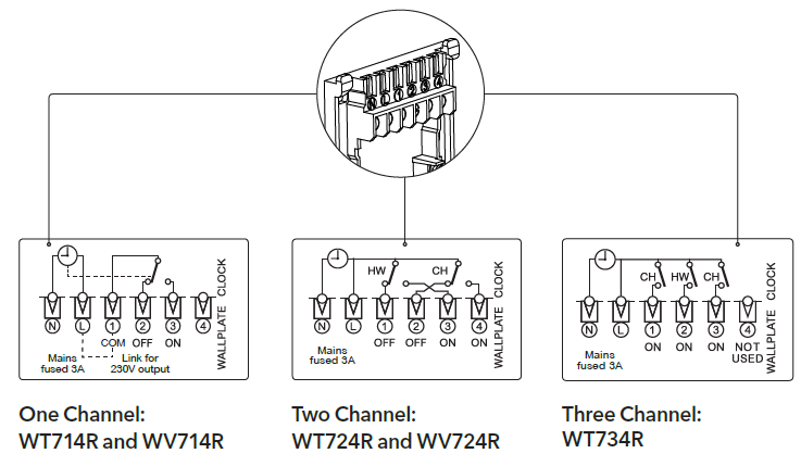

It's just a matter of moving the existing wires from the BDR91 to the the terminals of the Drayton that have exactly the same function.
The BDR is:
The Drayton Single Channel (Combi) version is:
So from the above diagrams:
BDR N = Wiser N
BDR L1 & L2 = Wiser L
BDR A = Wiser COM
BDR B = Wiser 3
There shouldn't be a wire in BDR C, that's normal.
Only if there is presently a link inserted between L & A at the BDR, will you also need to fit the link between L & COM at the Drayton. Do not fit the link if it's not there already.

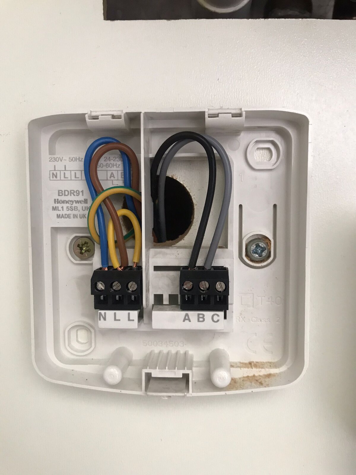

Thank you very much for a detailed explanations. However I've got presently a link inserted between BDR L1 & L2 (please see photo attached). I am not sure how to fit this link at the Drayton. Please could you clarify?

There are three Drayton wiser thermostats 1717098548920.png we assume single channel is what you have? And as the old wiring is, that is the only one which we can be sure will work, and it will not need the link wire. It does not seem to do anything with the old thermostat either.
Seen this a few times, so a fairly common installation mistake. Because both terminals are marked L some feel that both terminals should be connected to L and add the unnecessary link to join them together. When actually the two terminals marked L are already connected together inside the BDR anyway. If you were to remove the link you would find that BDR would still work.
The second L terminal is just there for convenience of wiring when required by some installations. But you don't need to worry about it. Yours isn't one of them.
Thank you very much Stem, all clear now. Will try to install today. Thanks once again!
You're welcome. In your case no links at all are required anywhere. Just the four wires to the four terminals.
