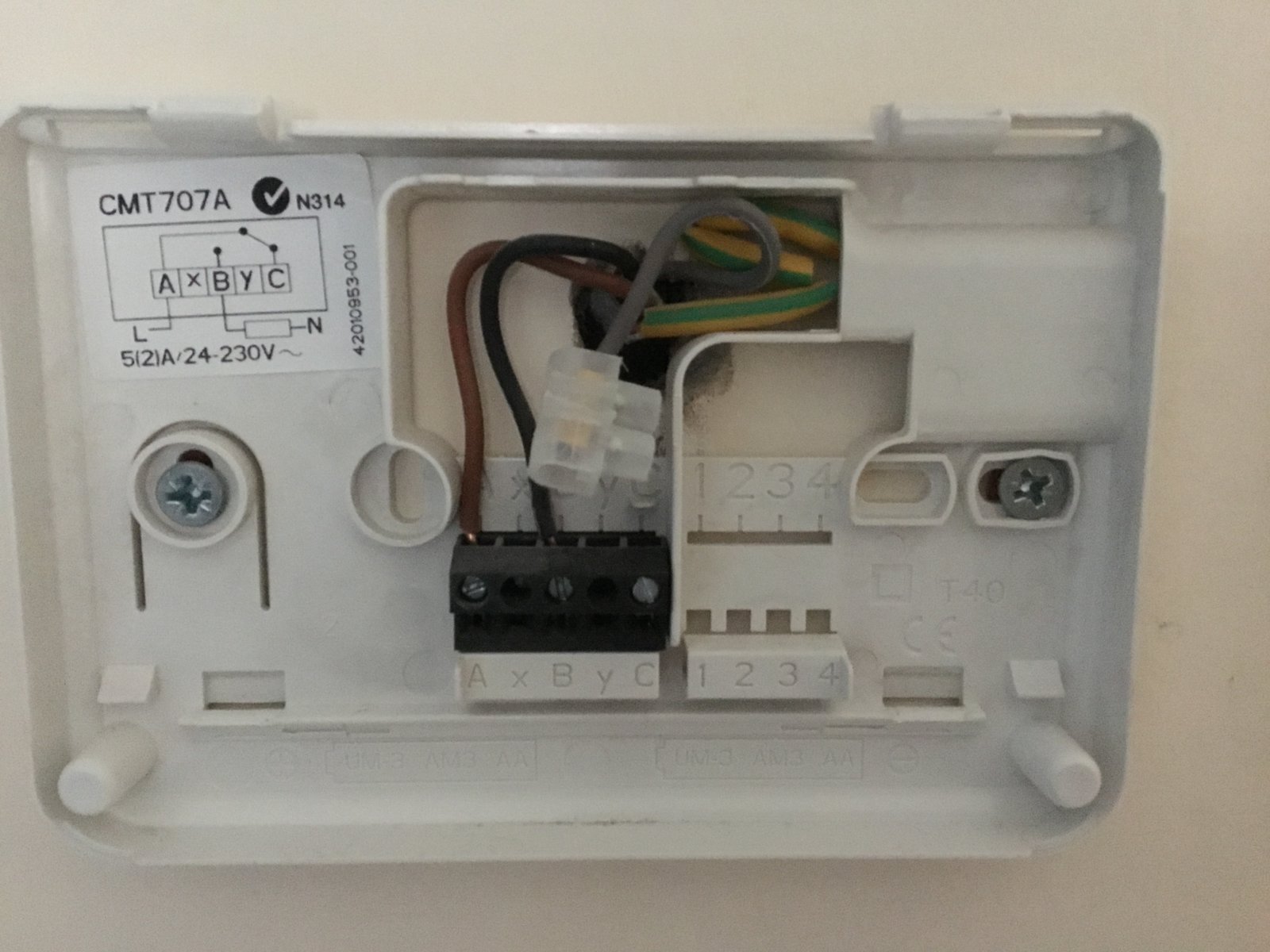

I am looking to install a Drayton Wiser smart heating system via my combo boiler, which is an Ideal Logic ES35.
I have 2 separate heating channels - one for the lounge with a wired thermostat in there, and the other wired thermostat in the downstairs hallway which controls heating to the rest of the house.
As a result I bought a Wiser thermostat kit 3, following advice from Drayton themselves, due to this having 2 separate heating channels (and a hot water channel which i believe will sit unused due to having a combo boiler).
The wired thermostats are identically wired, and have a brown live and black load connected, with a grey that is isolated (not connected) and yellow/green earth also unconnected at the thermostat ends (see photo).
I have also taken a photo of wires entering the boiler (see below).
I believe the Wiser ‘hub’ is connected to the boiler which I am planning on mounting underneath it, and the wall thermostats replace the wired thermostats (with current wires just disconnected/isolated).

New to the forum so hoping for some help please.

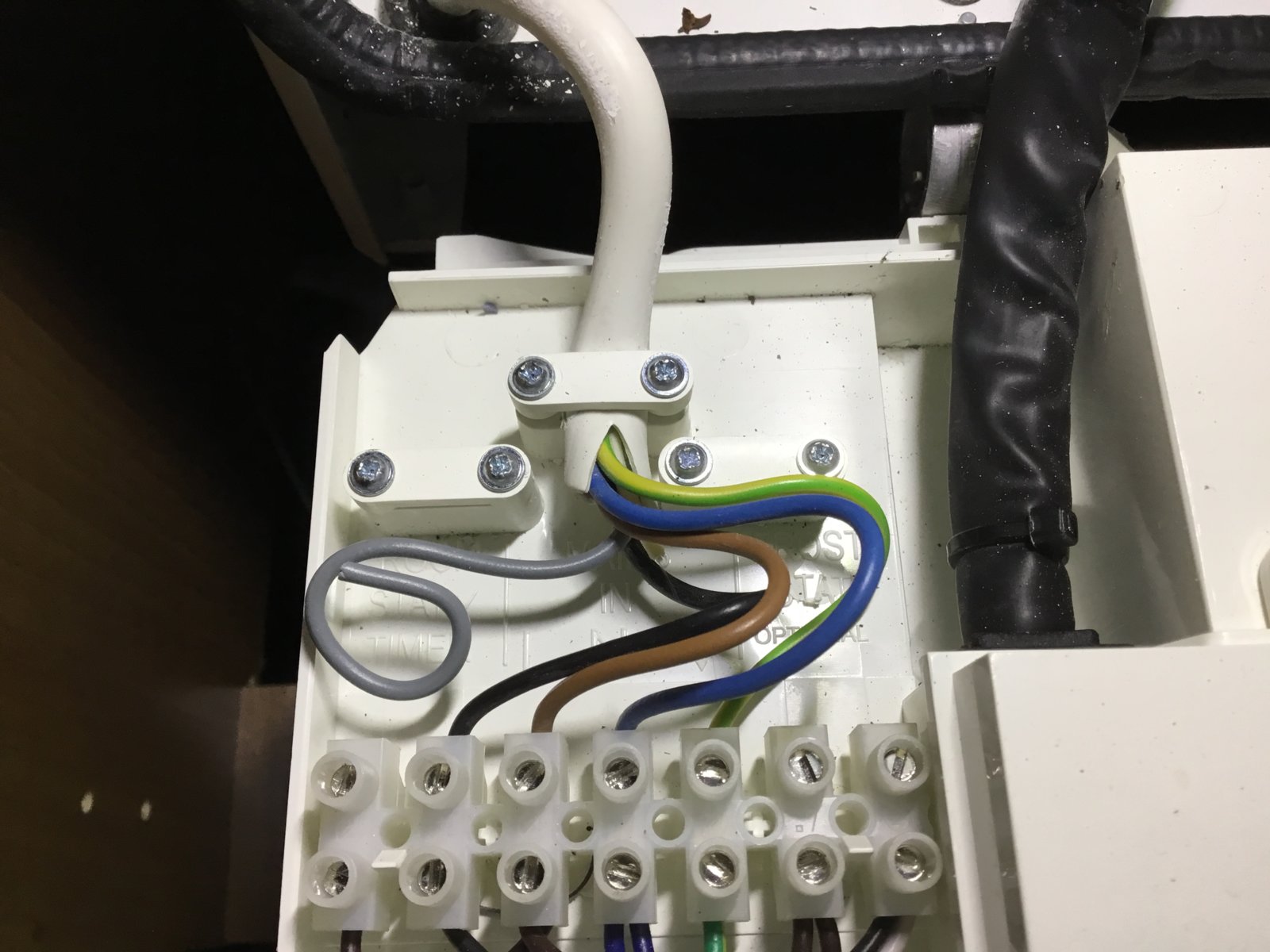

Please can someone advise which wires are connected from the boiler to the hub (see hub plate reversed below).
Also wondering if the opentherm can/should be connected? (Small grey connector bottom left on heat hub).
