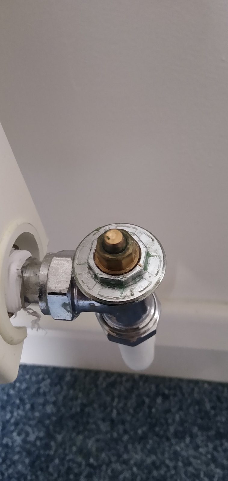

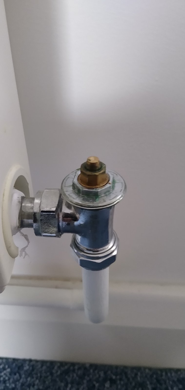

Can I fit the Wiser Radiator Thermostats to these TRV valves? I think Wiser require M30 1.5mm valves and I suspect I have Comap M28 1.5mm type. I think I have Westherm 6 TRV's, but I am not sure.
Do I need the following adapters? I hope not given the extra cost!
https://www.heatingcontrolsonline.co.uk/28mm-trv-adaptors-p-386.html
l IMG_20200415_193436817.jpg IMG_20200415_193442756.jpg IMG_20200415_193423113.jpg IMG_20200415_193531028.jpg
That's my problem. I don't know what I have. Do I have M30 1.5mm or something different?

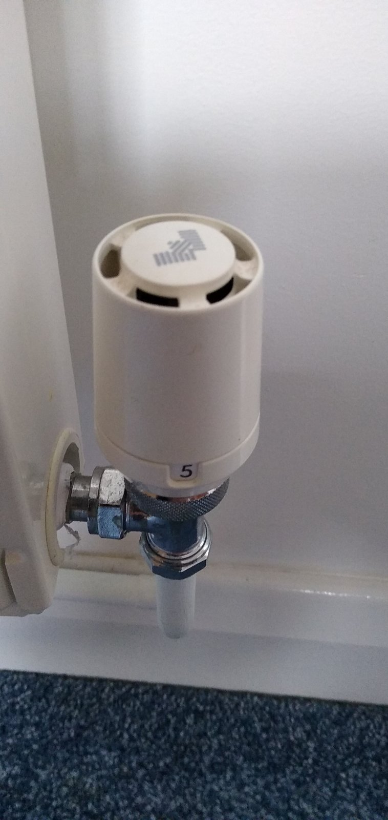

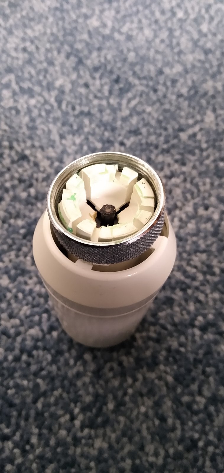

The old one does look like a Westherm which means you will need adapters.

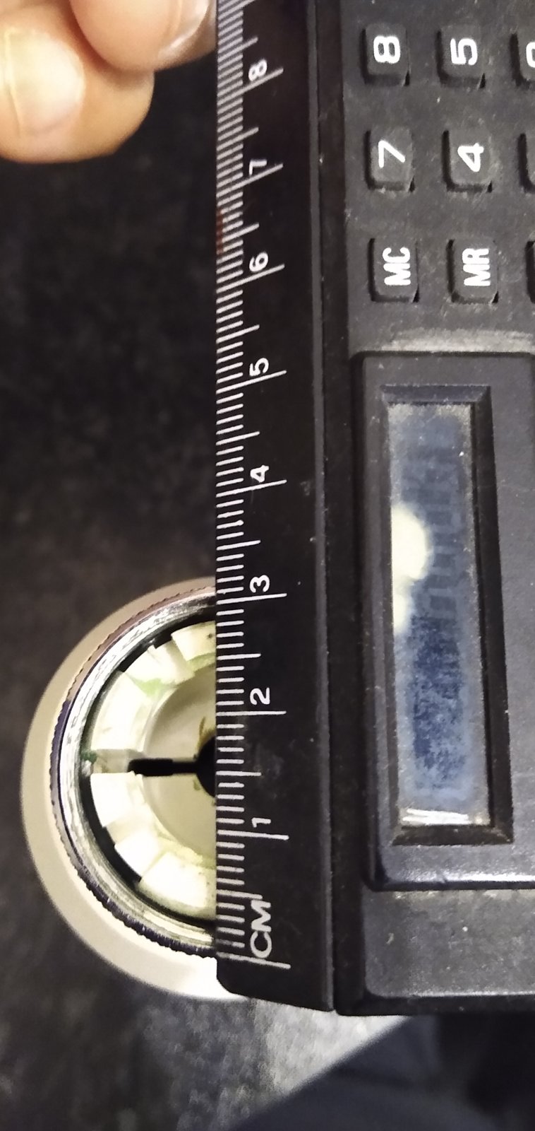

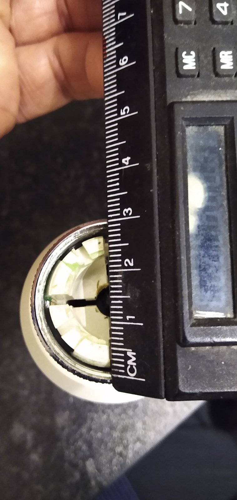

Yes, I think I have Westherm 6. Measuring is difficult, since there isn't a lot between 30mm and 28mm. The inside ring is just 30mm and the outside just over. See photos. Annoyingly I think I have to buy adapters.
Just received an email from Westherm and they have confirmed it is M30 1.5mm, hence I can fit a Wiser Radiator Thermo without an adapter. The Westherm 6 is also sold by B&Q and Tradepoint under a Regis brand, so I think the Westherm 6 is unusual in their range, since they must have just put their brand on someone else's TRV.
