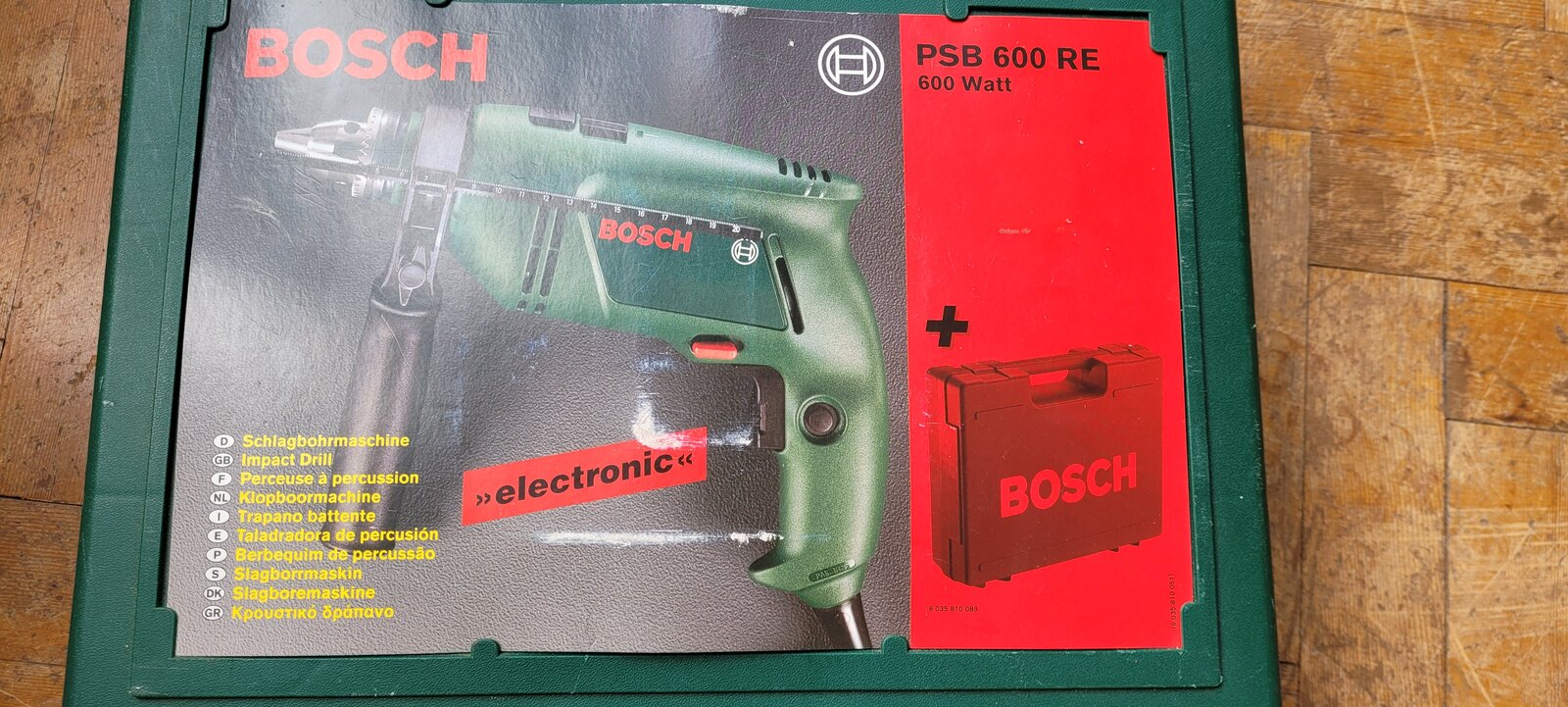

Am having repeat issues with what I thought was a half decent plug in Drill. Example when putting up shelves - one chosen drill hole will work fine. Rawl plug will slot in required 2-3 inches. Next drill hole only goes in 1 inch and won't move any further into masonry/brickwork. Really hard to judge it. Just a standard brick wall, don't think there is a joist. End up with wider hole and ruined plastering around it, unable to hang stuff.
Drives me crazy amd makes a real mess of walls, patching it up.
Do I need a proper hammer drill and special masonry drillbits to avoid this? Builders always .make it look easy.
Keep getting it wrong. Any advice appreciated.
Get an SDS drill, game-changer. Few threads on here with recommendations for entry level ones, you'll not regret it.
Why not show us what you've got? For occasional use a basic hammer drill with some decent masonry bits should be perfectly adequate.
Get a Bosch mains powered sds drill. Used mine today fitting blinds in 2 bedrooms. Makes short work of drilling into masonary.
It the attached one with what I think is a standard drill bit.

This is the one I have
I have the older version of this Metabo SDS
It has both a SDS chuck and a regular keyless chuck. TBH, I rarely use the regular chuck but it has come in useful when I am on site and don't have a cordless drill with me.
I first purchased a SDS after once having the misfortune of trying to drill into a very hard wall with my old hammer action drill, I managed to making a 7mm masonry bit glow red. 10 minutes of drilling and it had hardly left a dent in the wall. The SDS drilled the hole in about 7 seconds.
