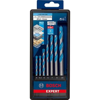

I find that SDS bits don't always hold well on 3-jaw chucks and you do end up paying a premium for them over straight shank masonry bits. In the same box as my Makita DHP481 combi drill I have a set of Bosch Multi-Construction bits like these:
They do various sets of these. Whilst I generally use an SDS drill for masonry there are times when I just want/need to carry a single drill with me to do everything - and then I'll take the combi box with a set of these. They will drill timber or ceramics as well as wood, but whilst on wood I don't really rate them, they are good for soft to medium brick or blockwork. At under £20 they aren't a bad price, and there are/were smaller sets than that, although for plugs all you should need are a 5.5mm (red plug) and a 7mm (brown plug) unless for material is very saft, in which case 0.5 to 1mm smaller (say 5 and 6mm) is useful as an addition

dont use SDS drills - i have the dewalt combi drill, 1 up from yours DCD778
and when ever i i uesd sds drill bits - i get a slight runout and they dont fit well
I use the Bosch multi construction for most things, very good in our walls - Brick/blocks and my sons brick blocks - have not used hammer action now for a while
the hole is great no wobble on the bit and rawlplugs now fit nice and tight when using the correct size drill bit
