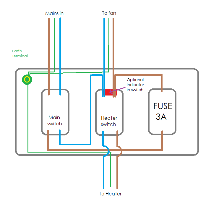

Hi,
I want to wire up a drimaster HEAT with the ability to isolate either the fan and heater or just the heater.
I am thinking of adding 2 x 3-pole isolaters; one between the supply and the fuse box, and another between the fuse box and the heater. Is this the proper way to do it ? My only grudge is that I will have two isolaters and I would rather just one.
Also, since the heater is 500W, will it be okay to pull the live feed from the lighting circuit ? I intend to use 1.5mm for the wiring.
Use a grid switch with 2 x DP 20A switches? Two isolators in one faceplate that way (assuming they are fed from the same circuit)
I have just read the installation manual. It is essential that you configure the wiring so that it is not possible to have the heater on without the fan.
The unit is 500W max so it will be ok to use the lighting circuit providing the lighting circuit is not already heavily loaded. You will have to add up the existing wattage to find out. The manufacturers also specify a 3A fuse be fitted in the supply.
If the cables are to be buried in a wall they will require 30mA RCD protection.
I would use a grid setup as suggested above, with a fuse module and 2 20A double pole switch modules all in a 3 gang plate. I would also have a neon in the heater switch.

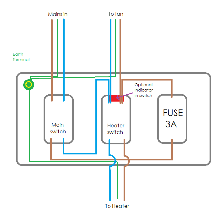

See attached wiring diagram:

Thanks for the diagram. After Iggifer mentioned grid switches, I was already looking into DPs and was planning on doing something like that but also add a light DP to that.
You mentioned the RCD if the cable is buried; what if I run the cable down the same path where one of the lighting switches is run ? I plan on getting rid of the single gang light switch and just replace with it a grid switch (with DPs for light, fan, heat(+neon) and fuse).
That's fine to put it all in one 4 gang grid switch, it's what I have done home here but with a wall mounted heater and light switches. You will likely only need a 1way or 2way switch module for the light which will be much cheaper than a 20A DP module.
If the cables are concealed inside the wall (i.e. not in surface trunking) either plastered over or inside a stud wall for example, then RCD protection is required. There are a few exceptions to this rule but it is unlikely you will meet the requirements for them.
