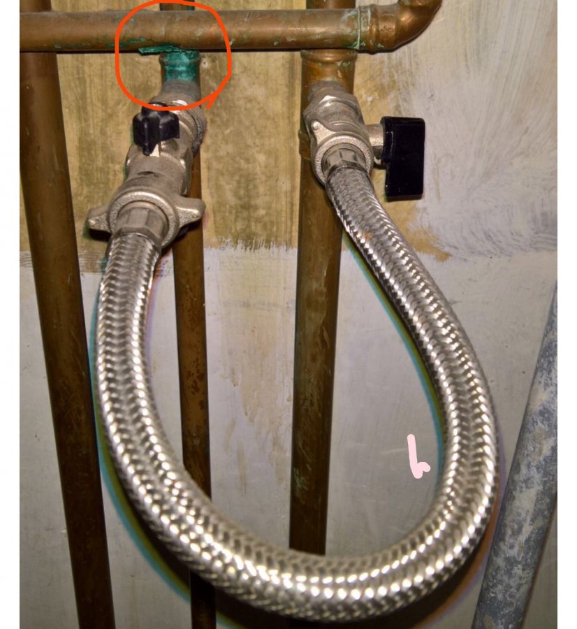

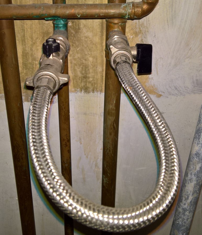

Hey all, so my water pressure dropped to zero after bleeding out the rads. This flow pipe was already connected and I just turned the lever on the right to let water in. The dial went up to 1.5 bar so turned it off. I then turned off the black lever on the left to shut off the water at that end.
I left it still connected for two days when I came home water had soaked into the floor below. Seemed to be dripping from the right side connection. Also the pressure had dropped by just under half a bar.
So disconnected it and put a cap on the boiler end. Though the flow pipe still seems to drip every now and then at the open end on the right. It is advised this should be left detached but I don’t trust it without a bucket underneath. Any idea why the sudden drips whilst connected and disconnected?

Make sure the thumb turn on the RH connection is tight.....if it still leaks there may be a perished rubber washer on the filling loop flexible hose.
Once you have sorted the pressure, turn both black valves firmly off.
John :)
cheers John. So in theory can I take the hose off and no water should leak out? Can I just replace the runner washer?
If that was my plumbing I would be cleaning off the oxidisation before the tube perforates and making sure they were not rubbing.

good point! Will need to look for ways to clean it. I'm away today so hoping I don't come back to a big bucket of water!

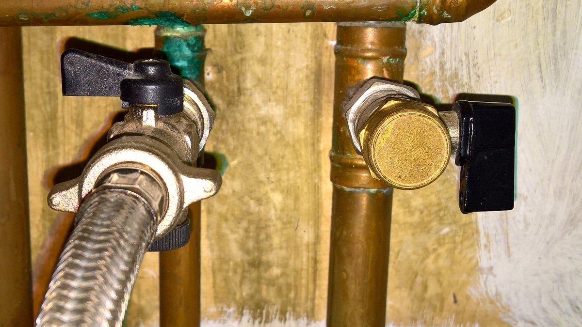

Hi dilalio. Would you be able to find a link for one of these pressure caps? I'm not sure if I'm looking at the right thing. I did by an end cap in the plumbing shop. It just screws on with no rubber inside. Could I just put a rubber washer inside it? See pic.

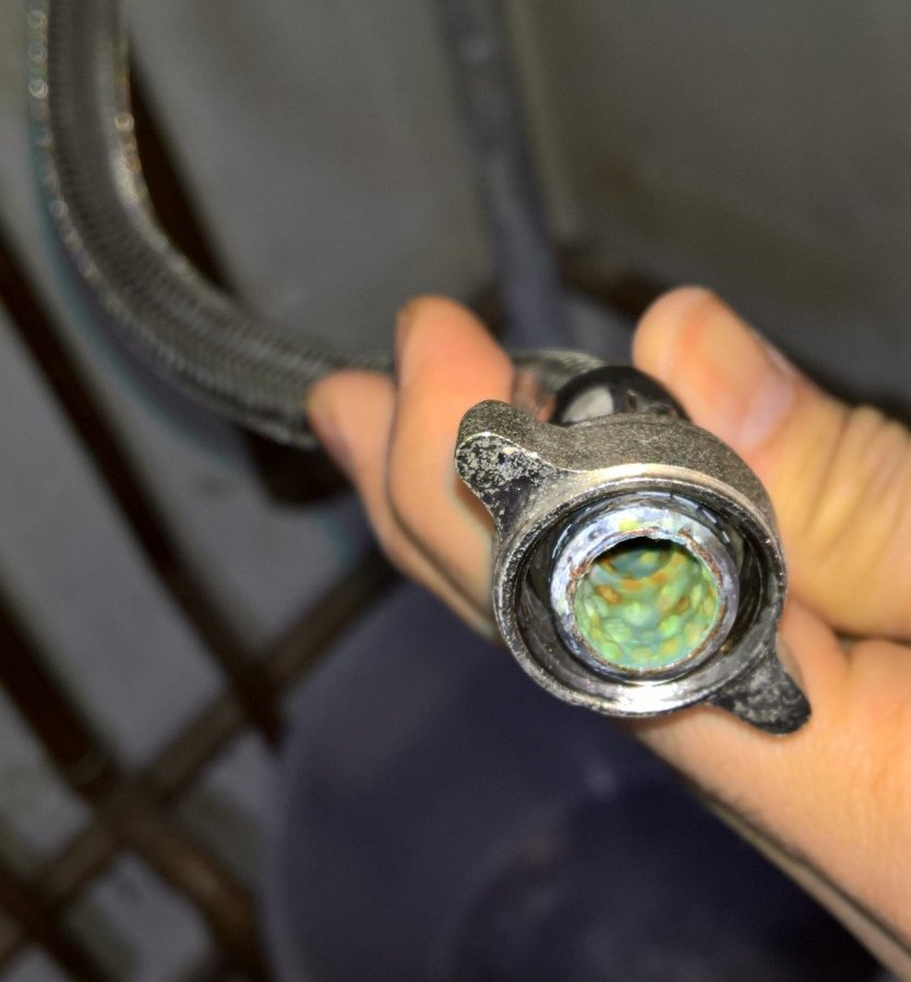

Also I'm seeing lots of blue green inside both the flow pipe end and the lever valve end the cap is on. Is this bad? Do I need to replace the flow pipe and valves or can this be cleaned out?

Better for the archives and future readers if you refer to the component by its proper name: It is a Filling Loop kit.
The cap you have on the right is a compression cap. Just get another one for other side and a couple of rubber washers to go inside them.
The Green you see inside has been caused by a trickle of water from the lever valve letting by, which has reacted with air.
Until you have ruled out leaks elsewhere on the system, I would just cap it all off for now and replace the filling loop when you've confirmed/eliminated other defects.
