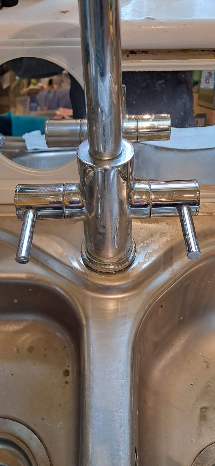

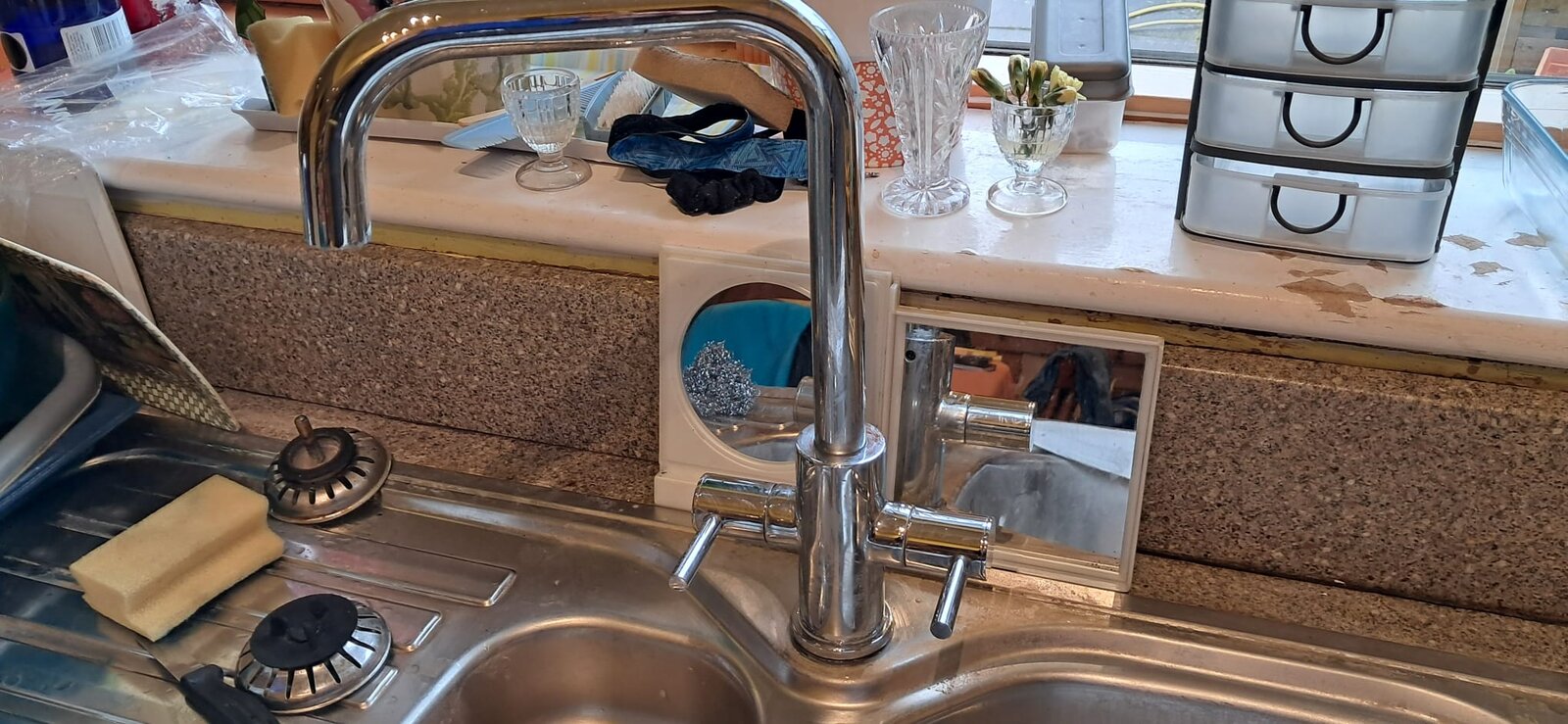

Trying to stop a dripping tap - I have watched various Youtube clips showing removal of grub screws but our tap has no grub screws to removed the h&c levers. Have tried shear brute force to pull them off but no luck. Any tips or advice would be very welcome
Possibilities:
1. The operating levers, (thin, chrome) unscrew and there are grub screws underneath.
2. There are grub screws at the back of the handles hidden by push in inserts.
3. They do just pull off. Unlikely, but try pouring hot water over the handles before pulling.
