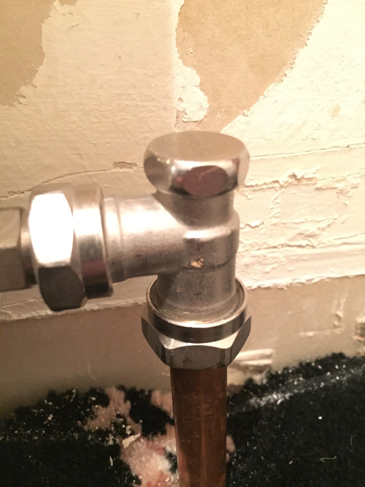

Im in the middle of decorating my hallway, and when I was removing old skirting board from behind radiator I must have knocked it. Now its dripping slightly at the valve. Tried nipping it up but still getting the odd drip. Could it be the olive had come offseat and needs replacing?

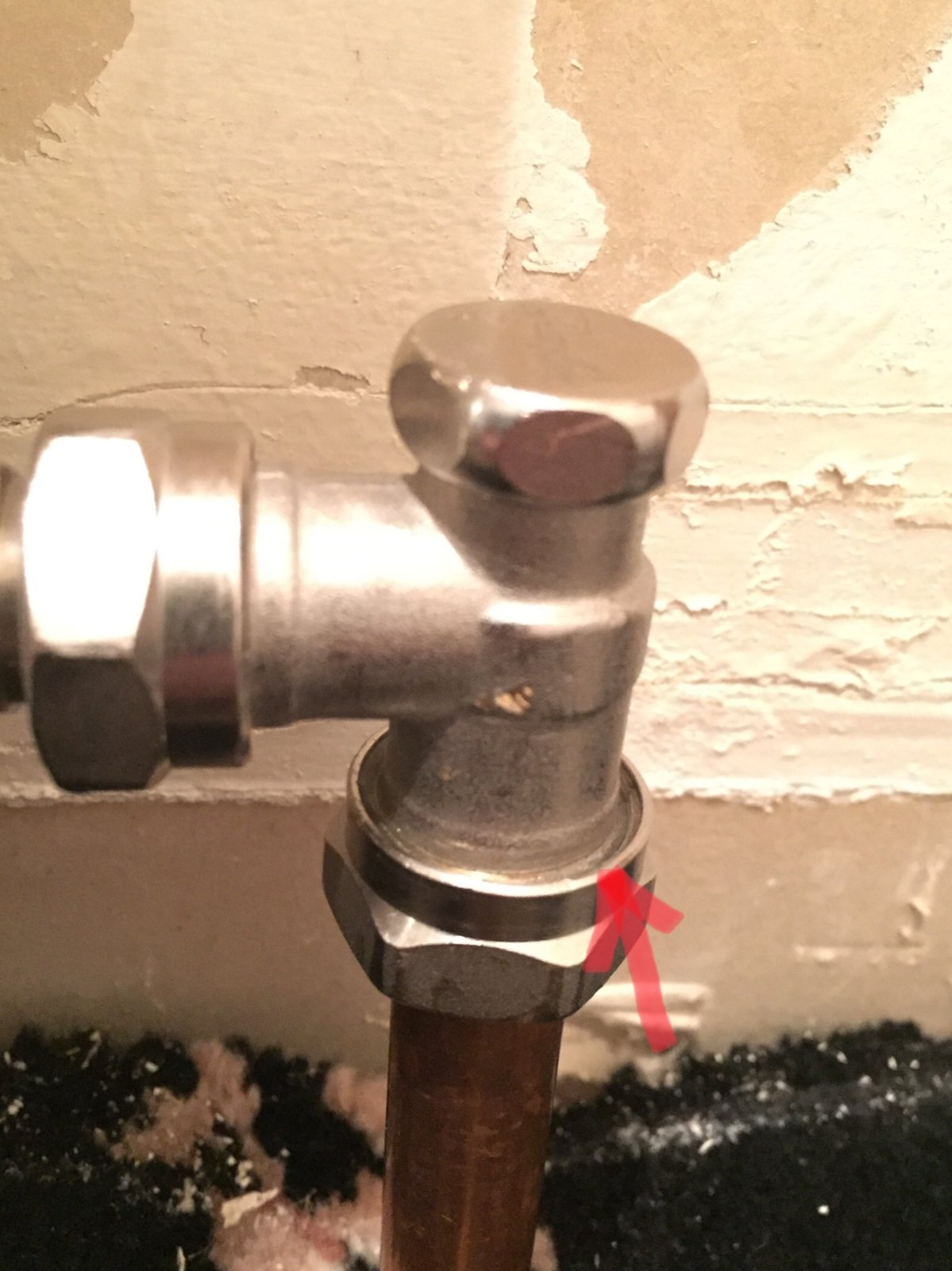

Its a lockshield valve. Looks like its coming up through the threads of the nut from the pipe coming up through the floor. 19mm
Slowly seeping up through these threads. Yes, sorry its 15mm

Yes its 15mm hold the valve body with grips and tighten the nut up will be fine
As above, get some decent spanners on it and give it a 1/4 turn. It is leaking between valve body and the olive. If that fails to fix it, you will need to drain down and apply a smear of sealant either side of the olive faces.
