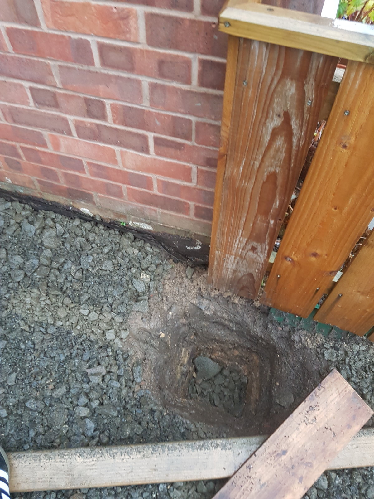

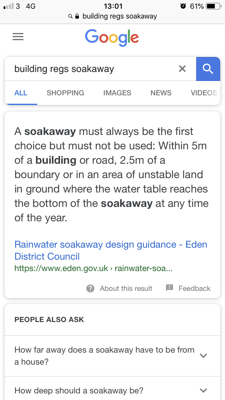

See if its just a genuine rule of 5mt that worrys me but is there no offial law ? as only 1m away. Might say can that not be moved but the drive slopes down towards house and also on angle to with right hand side higher than the left so not sure if possible. But also going to say want more sub base.
Just worried about the sump/soak away being close to house incase of subsidence etc.

thanks again Ian oh ok I understand should by law ( building standards ) it needs to be 5m away ?
the thing is I don't want to sound like a idiot who thinks he knows everything but my concern is being so close to building only few inches from next doors wall. but they are building standards approved so should know all of this. I may ask if the aco drains can go into the drain were the drain pipe from roof goes into to the right of the door.

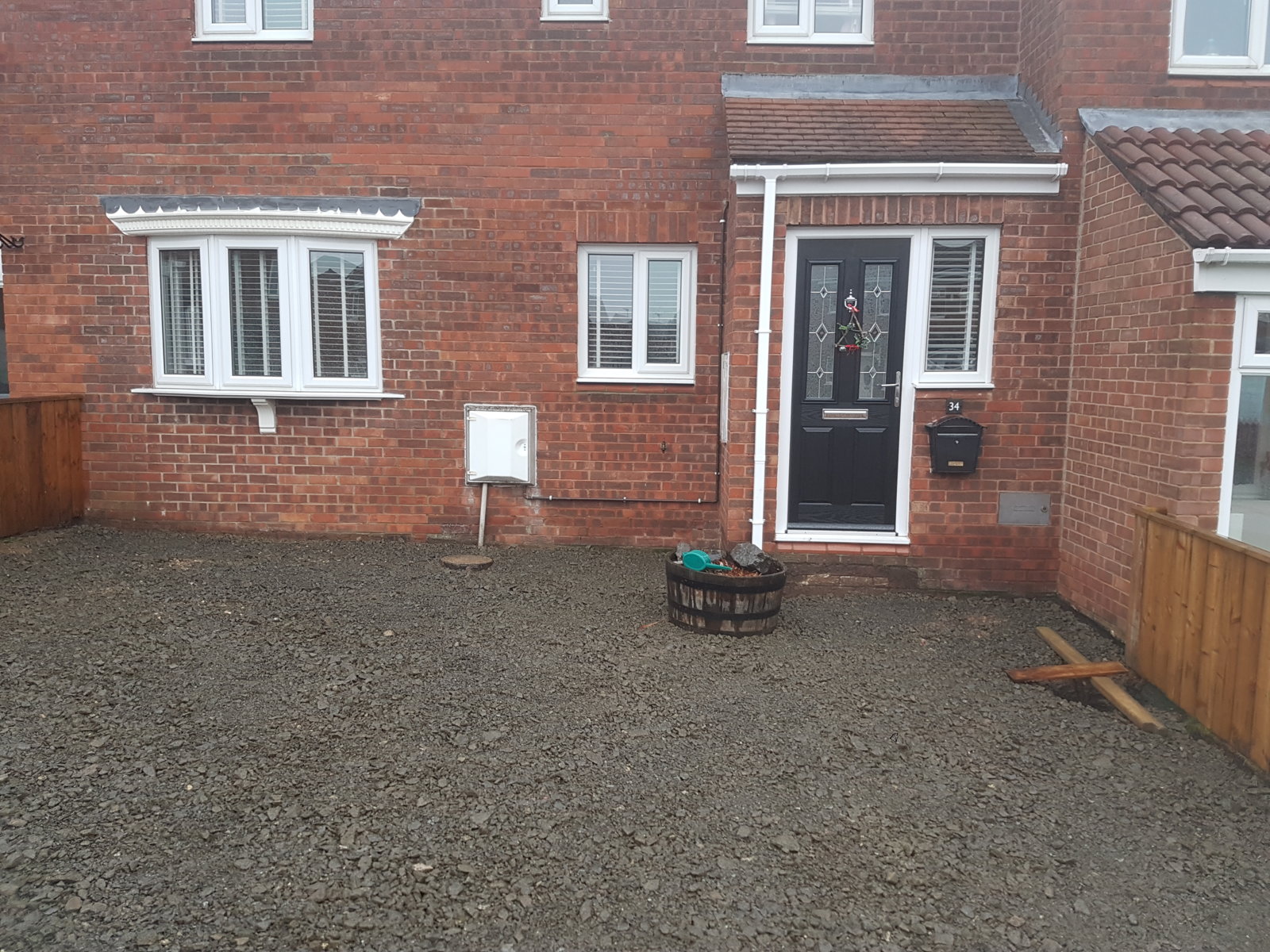

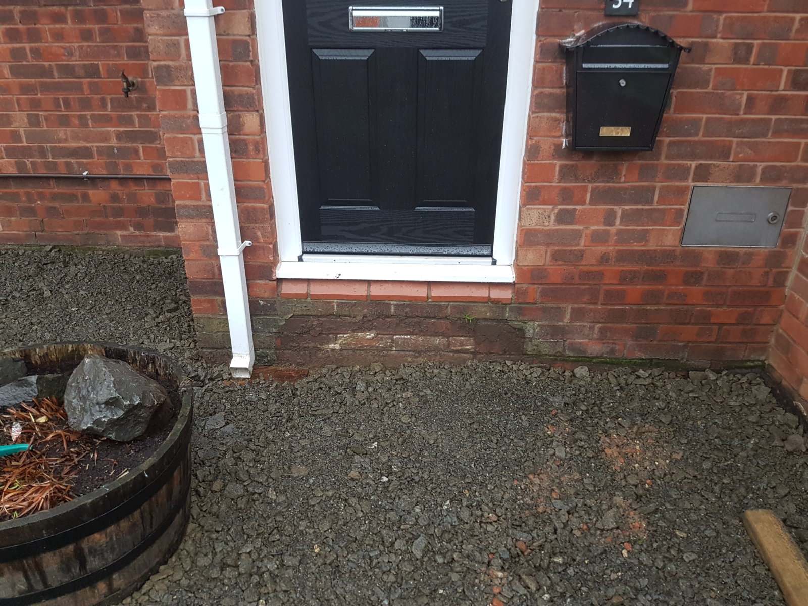

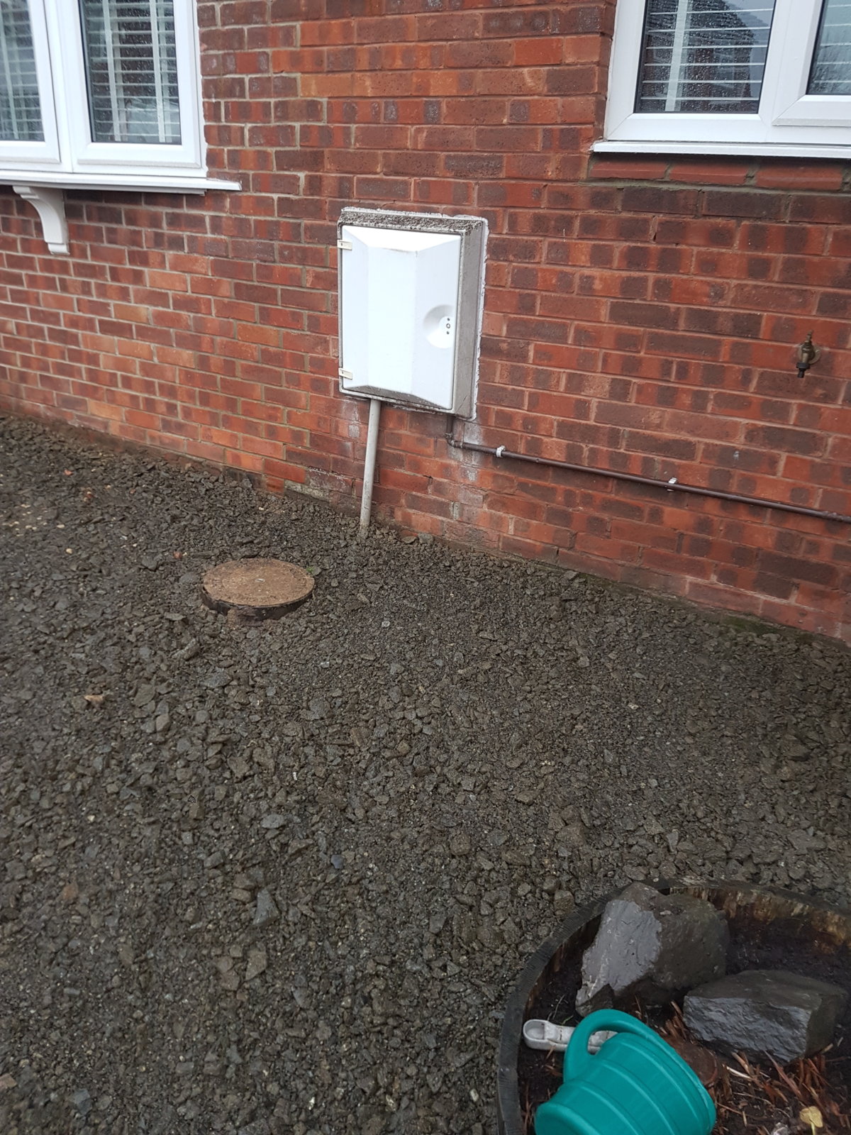

Thought would add few more pichures for you of the front of house along with drain on drive i susspect is sewage (round one)along with were drain pipe from roof goes into drain .Also the hole thats dug at the minute.
Looks like you have a damp problem under your post box, what is the grey box next to the post box?
Andy
Andy
The dpc is just below door and no damp problems in house at that side at all and tbh never ever opened that grey box so not sure ony thing there is telephone goes into the house.

If that's the soakaway ? I'm guessing 50-60 m2 of drive looking at pics?
I'm thinking you need a chat with boss man.
As a good deluge will flood you out.
I can't see the lie of the land but if that's the low point ? I see problems.
thanks again it is really appreciated everyone, he is coming to speak later so I can tell him my worry. yes if you look at the bricks the right hand side is the low point and were the water used to run.
