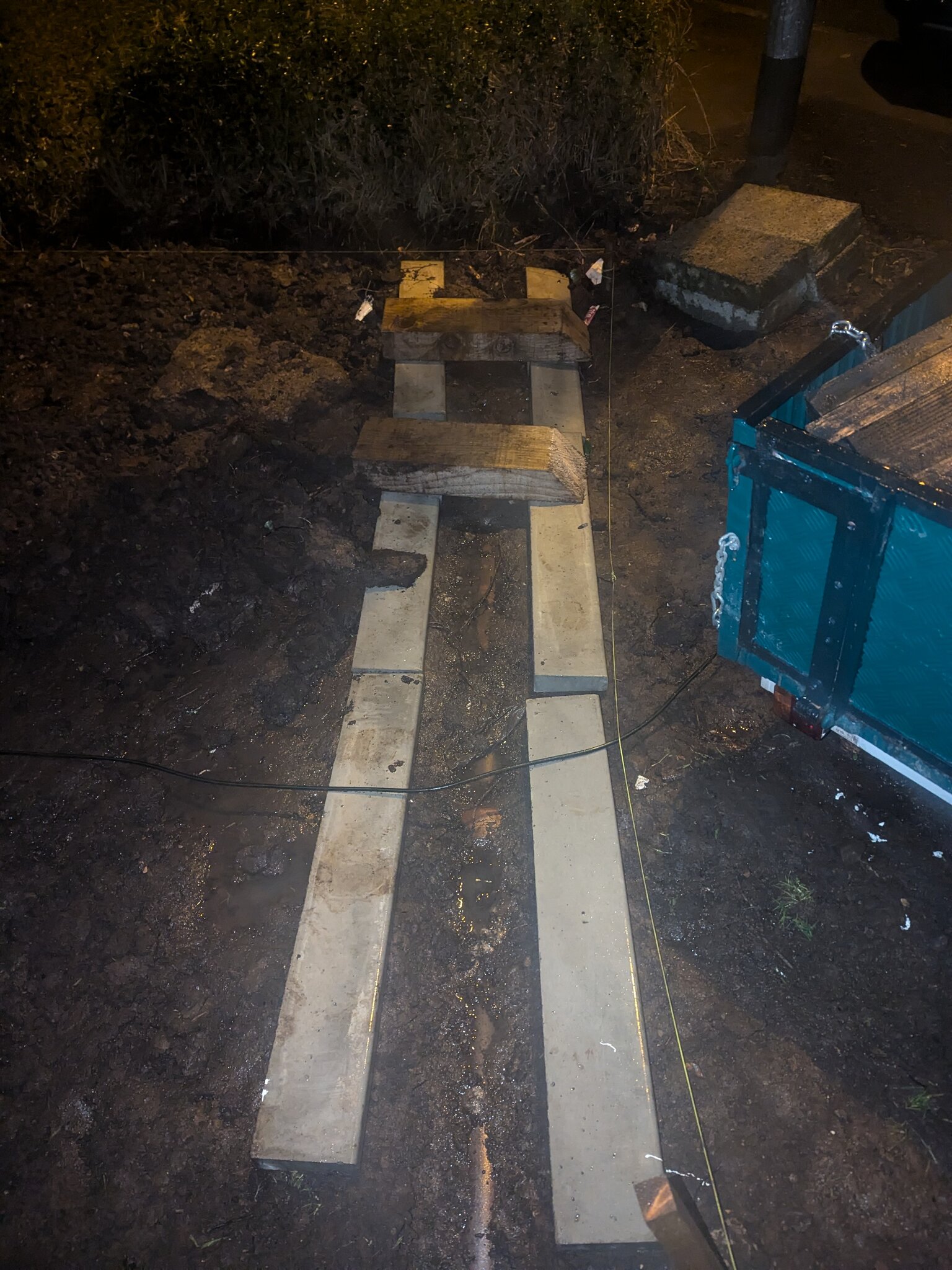

And then my plan was to build two trenches where the slabs are in the picture. deeper and make two strips of concrete foundations to just above the pipe. Then put a 20mm thick steel plate across the void.

The pipe is a neighbours drain gulley. Their house is around 600mm higher than mine.

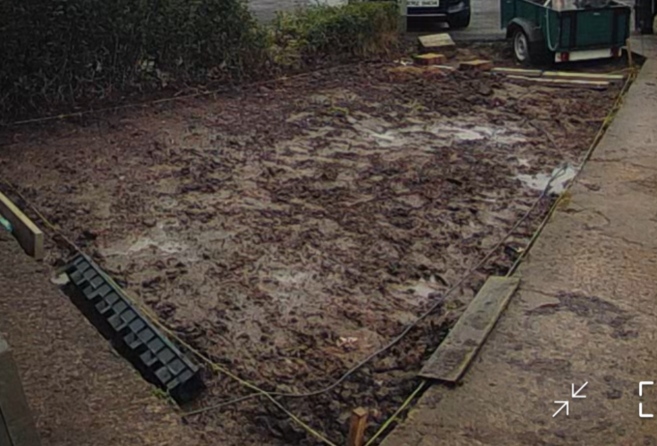

So in the bottom left you see the 'kerb' im going to fit around the edge. Its going to be 50mm above the pathway the whole way around.
The garden runs at a slope towards the house and towards the corner were that concrete 'kerb' is...
The top of the garden is where the pipe is... The top of it is 100mm below the pathway. In other words the bottom is 200mm deep.
I intend to use gravel grids they are plastic interlocking grids that gravel sits into. And the membrane will be non woven.

Now its clearer!! must say the ground conditions look a bit wet/soft, i take it pipe is crossing down by the trailer in the picture? as you say if you are renewing with plastic then there will be change to bed and surround with concrete, the drive will never see anything other than standard vehicles by the look of it.. shame youre not in mid wales I could give you a length of DI (ductile iron) 100mm couple of bandseals and you could drive a tank over it., yes to the geogrids and non woven terram, but do make sure youre formation as some strength to it, that ground looks like I would go up to my ankles if I walked across it!!
It's firm enough but it's clay even 2 feet deep so I'm probably fighting an uphill battle but the property near a 1-100 surface flood risk zone so I feel gravel at least makes it a huge retention tank for a period of time.
