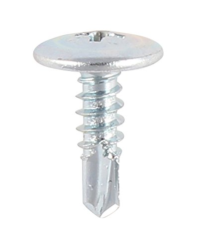

The main components in MF are the studs, C-sections (or channels) and top hat sections (for soffits/hoizontal pieces). Places like Selco will sell these components individually.
The MF is held together using self-drilling wafer head screws

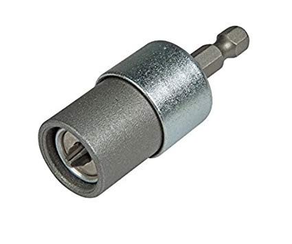

and the plasterboard is screwed-on using fine-thread drywall screws and a drywall screw adaptor for a cordless screwdriver
Your drill driver needs to be able to run at 2500rpm (approx.) and you should use 25 to 30 mm drywall screws for the PB. As Foxy says, that kit does look easy to use
