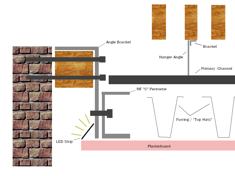

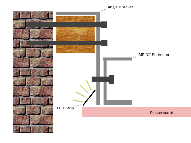

Thanks for the replies. It definitely seems like MF is going to be the easier and lighter way to do it. I'm still not sure about how to fix the C-section wall profiles though, as they won't be fixed to the wall. I'd need some way to support them. I'm thinking something like this might work:
I'd fix angle brackets every 600mm along a wooden batten at the top of the wall (something like these) and fix the C section to that. That would give me a 50mm gap, which I could overhang the plasterboard slightly to make a space to fit the LED strips. I know the C-section perimeter is supposed to be fixed directly to the wall all the way around to give support to the rest of the frame, I'm just concerned about it not being rigid / supportive enough. I think the hangers are supposed to be spaced 1200mm, so I'd do that for them. I just haven't had any experience with MF and a full ceiling's worth of plasterboard, so not sure if it's going to be super heavy and needs more support, or if it's not actually that heavy and supporting with the brackets will be fine.

Looking at the OPs drawing it is plain that they do not understand how MF is installed, what the various profiles do and anything I wrote previously...

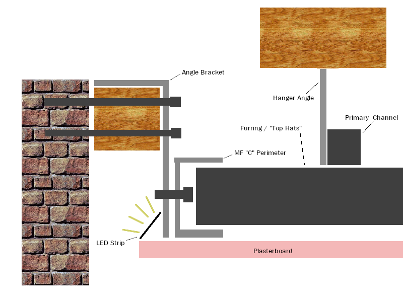

From what I understood of your description, it's basically the same as that but you said to install the MF6 as the last step instead of the first, I guess because it's not actually attached to the wall in my case. My diagram above was just showing a way of attaching the MF6 perimeter to the wall so that it's supported. I left out the primary channels, hangers, and furring sections from the diagram.
I've added the rest of the parts to the diagram. Side view:

It would, though that's not as per your drawing, though a flat would suffice. How will you finish the edge of the plasterboard and ensure it remains a nice clean line even after faffing about fitting the lights and perhaps having to change them etc? What you've drawn is pretty delicate.
I'm not sure about finishing the edge. I'll be getting a plasterer in to skim the ceiling. Is there some kind of beading or profile or something I can put around to keep a clean edge before it's skimmed? I don't think the gap would be enough to see up the side unless you were really looking up the walls.
