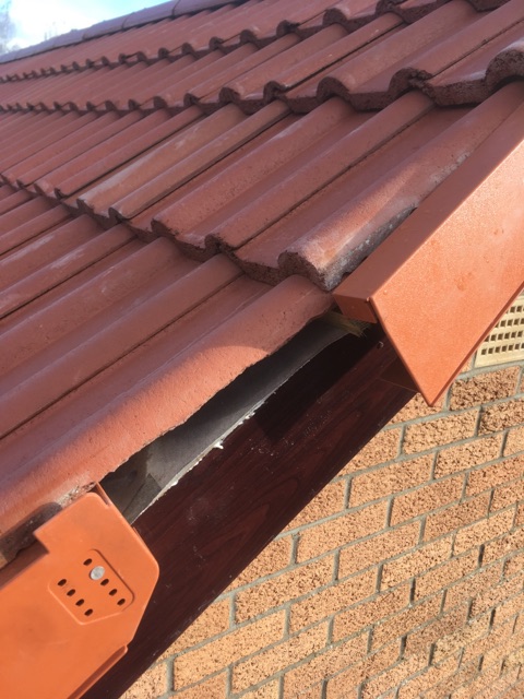

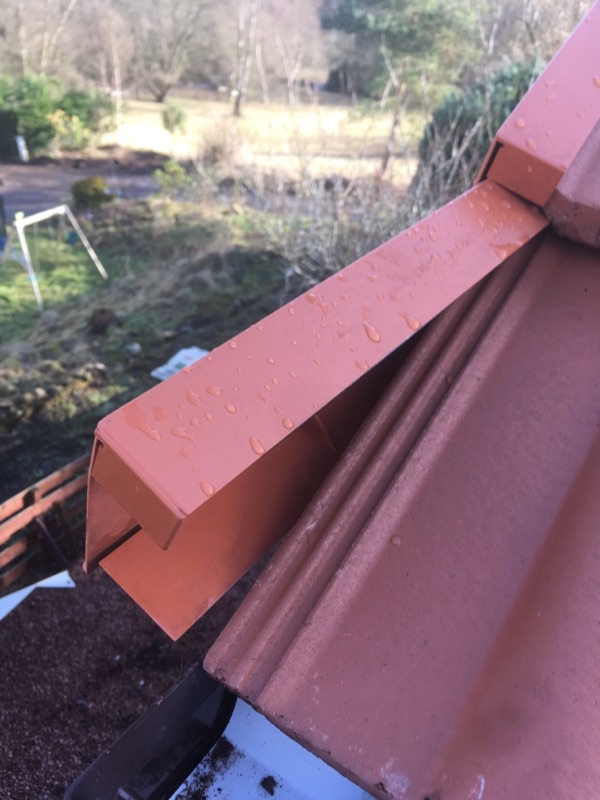

It's you're favourite unlucky roofing member here with another question .
Got our tile roof completely re-done a week ago and the roofer has gone awol after being paid and after strong wind and rain it is leaking . Yay .
Got another guy round, who I have been recommended. He has had a look and listed a number of issues with the roof. The biggest one being that the membrane under the dry ridge hasn't been attached with adhesive and is just folded under meaning driving rain will get in .
I know nothing about how this should have been fitted .does that sound right to you folks? He says it needs lifted and done properly .also the ridge tiles haven't been secured properly .
Cheers.
Also been sent pics from the guy who came round to look at the roof, showing what he felt was abadly done dry verge, which had used the wrong verges and hadn't been attached properly.
Seriously cannot win. Between sorting the ridge, verges, few broken tiles and flashing he is asking for £1900 .
