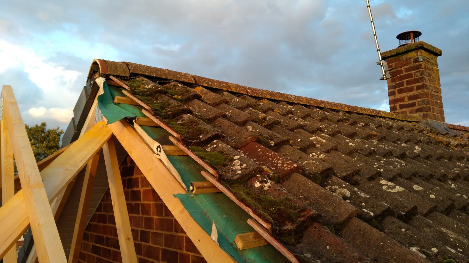

Hi Gary, I am planning on doing the same , I already have the klober dry ridge kit, and the Anglia's on my existing house also appear to be totally dry fixed, no mortar anywhere which makes me think (hope) it'll work.
The existing fixing from what I can see of it is that black roll of flexible rubber/plastic stuff which is the same as the kit I've bought.
Now I've got my trusses up i can lift the end existing ridge tile and post a pic if that helps.
Are the gaps under the your existing dry-fixed ridge tiles packed with filler pieces?
This is my neighbours:
Nope:
one is dry ridge ..(Dry fix) the other looks like ridge roll dry vent system ..

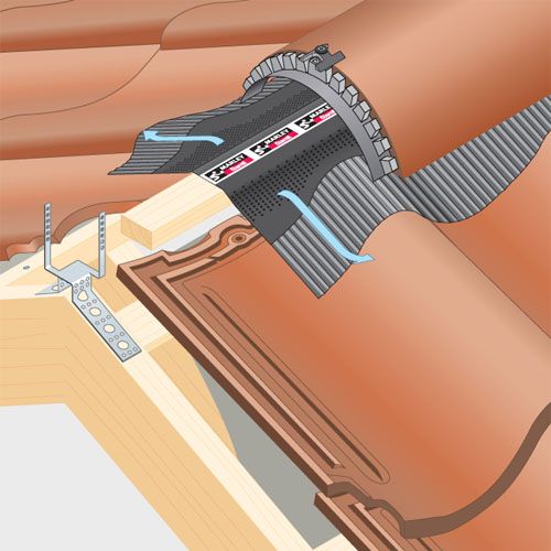

So, for a ridge roll that has a central ventilation strip that's insect/bird proof, is it acceptable to leave gaping holes as per 23vc's roof (nice house for a bird, but what's the harm...) or is it advisable to fit these profiles to fill the gaps:
https://www.roofinglines.co.uk/product/marley-anglia-filler-unit-vented
If I look at the datasheet for a Klober 'roll fix' it states that
Suitable for: ƒ Most popular makes of roof tiles and slates except Redland Delta and Deep Profile Clay Pantiles
Is an Anglia 'deep'? Does any of this matter!?
I wondered the same thing Gary, not sure if they are considered deep pantiles. Not sure how much an issue the potential bird nesting is, I hadnt thought of that
Cant you just use the dry roll kit and point the profile gaps under the ridge?
just bed the ridge, you can get joint fixing systems to give you the mechanical fix.
there is no point in using the roll and pointing the troughs. it will fall out anyway
Thanks datarebal, would you say just using the role (I've got the klober kit already) is OK for these tiles. As that's how they've been done on my existing roof and I don't think it's leaking although I can't be sure as it's all felted
That's the million dollar question... can I just use a ridge roll...
Anglia is a concrete pan tile really.
and definitely deep profile. You might get all sorts of birds and insects nesting in your ridge. whether the roll will mould down around the profile of the tiles is another matter. Marley do a ventilated ridge specifically for interlocking tiles and lists anglias as suitable tiles
That's my concern. However, when I look at a marley vented ridge, the diagram show it being used with deep profile tiles without infills:
full
https://www.roofingsuperstore.co.uk/product/marley-ridege-fast-system-6m.html
As you say - it specifically mentions the Anglia-Plus so I wonder if they've discounted the bird problem?
Technical
Maximum rafter pitch:
• 50 degrees - Modern, Double Roman, Edgemere, Ludlow Plus, Ludlow Major.
• 60 degrees - Plain, Mendip, Wessex, Anglia Plus.
