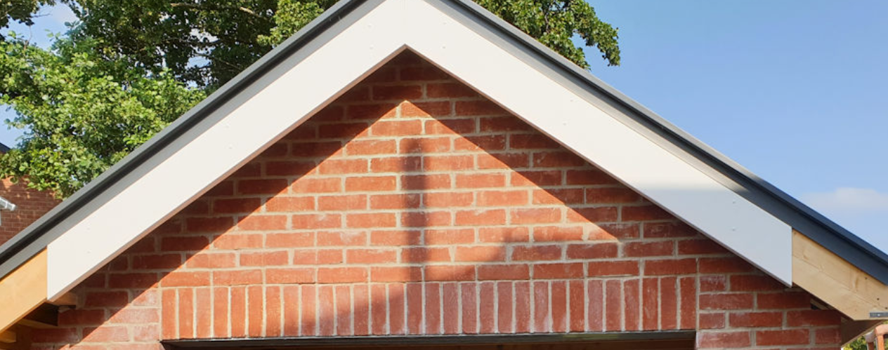

Does anyone use continuous dry verges? Wondering why not?
I have used continuous dry verge with slates
I only specify continuous dry verges, unless there is some specific (mainly aesthetic) reason not to.
Over the years I've found that many builders/roofers can't be relied upon to fit the individual types properly, or securely so some fall off very quickly. Not all builders/roofers but enough to need to design the risk and the problem out.
Also, on modern houses or those with barge boards, or any slate roof, continuous verges look better.
