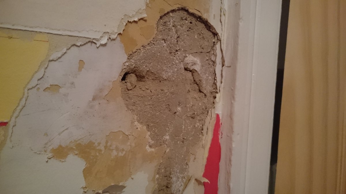

Just to double check. Here is what I'm dealing with. I gather I'm taking everything off back to the stone. This is incredibly soft itself, perhaps limestone?
Thanks again
Yes, knock it all back to brick/block/stone.
Yes it starting to fail, hard to say by pic exactly what material it is, but could well be a limestone rendered base-coat.
as PBD says that's the backing coat, take the whole lot off back to the brick, my guess is it will come of easily, but it will be dusty.
