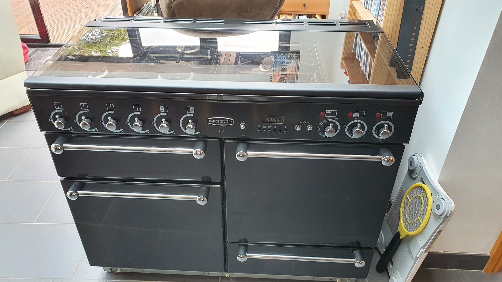

Is this the sort of thing (pictures seem few and far between)?
So, the hob is no different than any old stand alone cooker of the past.
It also has a plug on the electric cable - not sure if that is right.

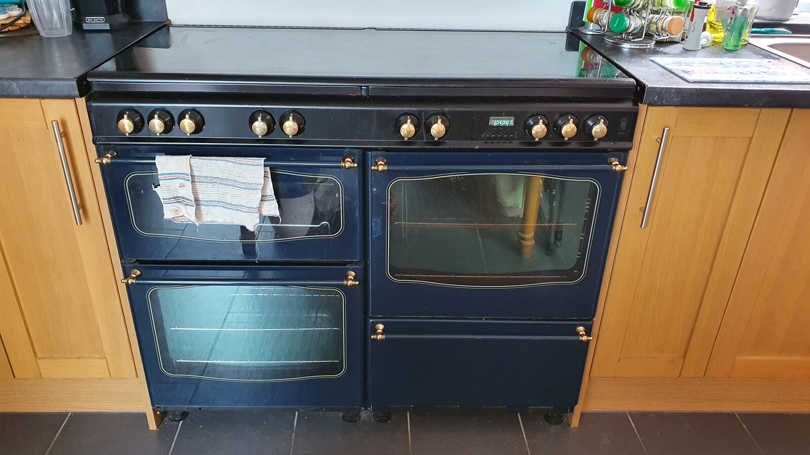

Single occupancy - we haven't rented it out yet - just preparing... I don't know why my wife got the 2nd hand one at £800 when for another £250ish I think... she could have had a brand new one???
As for providing the instructions with the cooker I asked that. It would have been so much more professional to have included them with the package.
Old cooker - pretty similar to the one above - and yes connected with a bayonet connector - and last time it was checked it checked installed with an 'anti-tip' device - not quite sure with that weight how you would accidentally tip it over - and the gas man agreed - but apparently a legal requirement now ...
New cooker...
