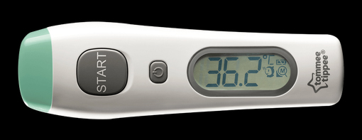

With an oil boiler it does not really matter that much, as long as every radiator gets warm, with gas the boiler will normally modulate (reduce output) to ensure if gains the latent heat, it will still work if not set right, but not as economically. Normally plumbers set the radiators so temperature drop with all running is around 15°C, however I tried with an inferred thermometer
![thermometer.jpg thermometer.jpg](https://cdn.diynot.com/data/attachments/248/248165-077b348ed5465a79efff5176c2f0c26b.jpg)
theory should work, practice the recorded temperature jumped up and down like a yo-yo.

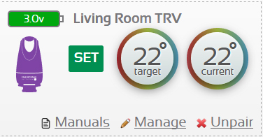

So I set by turning off all radiators and then turning back on until could just feel a little heat on supply side, then I used the computer TRV report
![TRV_report.jpg TRV_report.jpg](https://cdn.diynot.com/data/attachments/248/248166-cbb42787bb27078916de5093a6480bef.jpg)
until target and current matched, but it took some time, and clearly you need TRV heads linked to PC to do it. I actually at first only had two, and swapped them radiator to radiator to set lock shield, once set put the mechanical one back on, but adjusting between 2 and 3 until room at 20°C is easy with a TRV marked *123456 once lock shield set, but until lock shield set you simply don't know which one needs adjusting.
