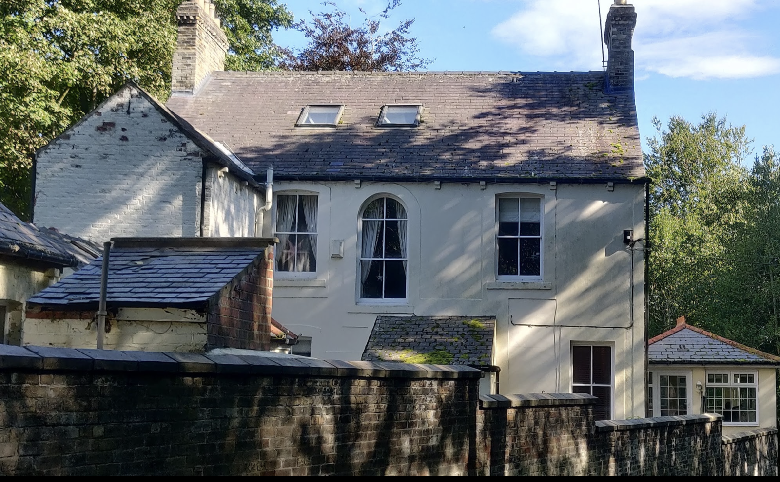

Looking to get our large brick house re-painted this summer. Reading a few review sites, Dulux Weathershield Masonry is consistently coming out at or near the top and it's also what the painter I got my first quote from recommended.
But there's more than one option... as well as smooth/textured seems there are the trade and non-trade and these are different products not just branding?
Looking on https://www.duluxdecoratorcentre.co.uk/ I also came across one I hadn't seen elsewhere, a "maximum exposure" variant.
Prices seem to vary quite a lot and since we reckoned my total order could be up to 100L that's potentially significant. Saw some random things like 7.5L of Magnolia for £29 and 10L for £74!
Any tips on choosing/buying this volume of paint?

Essentially yes - a large detached house with a couple of extension bits:

I would suggest that you could do with putting a coat of Stabilising solution on flaking wall above sheds before applying the masonary paint
Yeah there are some areas that are a bit cruddy. I don't actually know to what extent the preparation involves scraping and cleaning every inch, and to what extent masonry paint can be applied directly to non pristeen surfaces?
We plan to have full scaffold and take the opportunity to do a proper inspection and fix miscellaneous things, get it done properly rather than a quick slosh of paint.

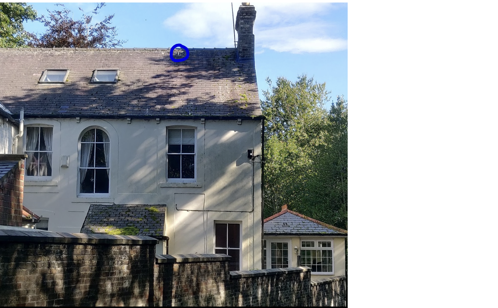

Out of interest... what is the bit in the following photo? Is it some kind of vent?

As a Decorator my specs would be as you say Scaffolding, then Pressure jet walls this helps to remove loose paint and moss, dirt, dust etc, let dry make good any damaged brick work then stabiliser on the bare brickwork, two/three coats of masonary paint as explained previous , personnally I am not too keen on textured but thats a matter of choice , it can be an expensive job so it needs to be done properly to make it last
Agreed.
Scaffolding is a no brainer. The costs of the scaffolding are more than compensated for by the reduction in labour costs.
