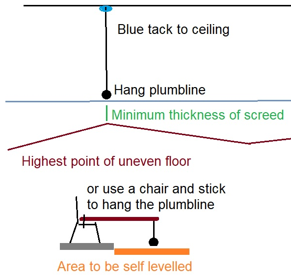

Is the question how to ensure the surface of the self levelling compound levels out with the correct depth above the highest point of the area to be covered ?
If so then you could find the highest point, the hang a marker above the highest point and pour compound until it reaches the marker.
