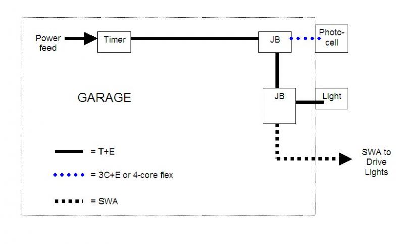

What I need to do is for it to go supply>timer>dusk till dawn thing>t junction to one light on the front of the garage and four lights down the drive. Because of the arrangement of the house and lights there's only one sensible place to put the dusk till dawn sensor so it doesn't switch off due to headlights or house lights. I'd rather it went dusk till dawn>garage light>drive lights, but that would need quite a lot of extra cable and would be difficult with SWA. The garage light needs to have the wire poked through from behind and will be screwed onto a wooden bit of the garage, so this would be easiest with regular twin and earth.
Depending on the make of dusk till dawn I might be able to use it as the T junction and poke the supply cable and cable to the garage light through the back, and have the drive lights coming out the bottom with SWA. Thatd do me.

What I need to do is for it to go supply>timer>dusk till dawn thing>t junction to one light on the front of the garage and four lights down the drive. Because of the arrangement of the house and lights there's only one sensible place to put the dusk till dawn sensor so it doesn't switch off due to headlights or house lights. I'd rather it went dusk till dawn>garage light>drive lights, but that would need quite a lot of extra cable and would be difficult with SWA. The garage light needs to have the wire poked through from behind and will be screwed onto a wooden bit of the garage, so this would be easiest with regular twin and earth. ... Depending on the make of dusk till dawn I might be able to use it as the T junction and poke the supply cable and cable to the garage light through the back, and have the drive lights coming out the bottom with SWA. Thatd do me.
I obviously don't fully understand the anatomy/geography of your setup - but, conceptually, what I was thinking of was something like (with all joins/JBs within garage):
... and you could probably combine the two JBs into just one.
Kind Regards, John
Edit: Picture edited to show correct cable type to photocell

I'll try and draw a picture later and upload it. But I like the idea of 333rocky333 of using four core and an inside junction box, that makes sense.
I think I'm confusing myself as the first dusk till dawn timer I saw looked like it just had entry's for two SWA at the bottom. One I can drill into from the back would be much better.
You've just made me notice! In the diagram I posted, it looks as if the cable from the Photocell to the upper' JB is T+E. It would, of course, have to be 3-core and earth (or, more probably, 4-core flex). I have edited the diagram appropriately!

Okay, so this is how i think it'll end up looking. It should be fine i think.

The three or four and earth depends on whether the photocell switches just the live, or live and neutral.
Yep, that looks like a slightly re-arranged version of my diagram, so it must be OK :)
I doubt that you'll find one which switches neutral - so you'll probably need either 'flat' 3C+E or 4-core flex.
You show the timer being fed from the CU. Is this to be a 'new circuit' (rather than a feed from an existing circuit)? If so, there may be a new can of worms here, because that would make it 'notifiable' work!

Yes it is a new circuit. But I having the garage rewired at the same time, and a new consumer unit in the house and putting in a circuit to power electric gates, so it's all notify able. I'm getting a sparky to do the new CUs so he'll check my design, do the final hook up and certify it.
OK, but let me tell you before someone else does (perhaps using a 'style' a little different from mine!) - it's not really meant to work like that. If you haven't already, you need to get the electrician on board now, to make sure he is agreeable to what you say above, since he will have to sign a declaration that he has undertaken the design and 'construction' (and testing) of all the work.
