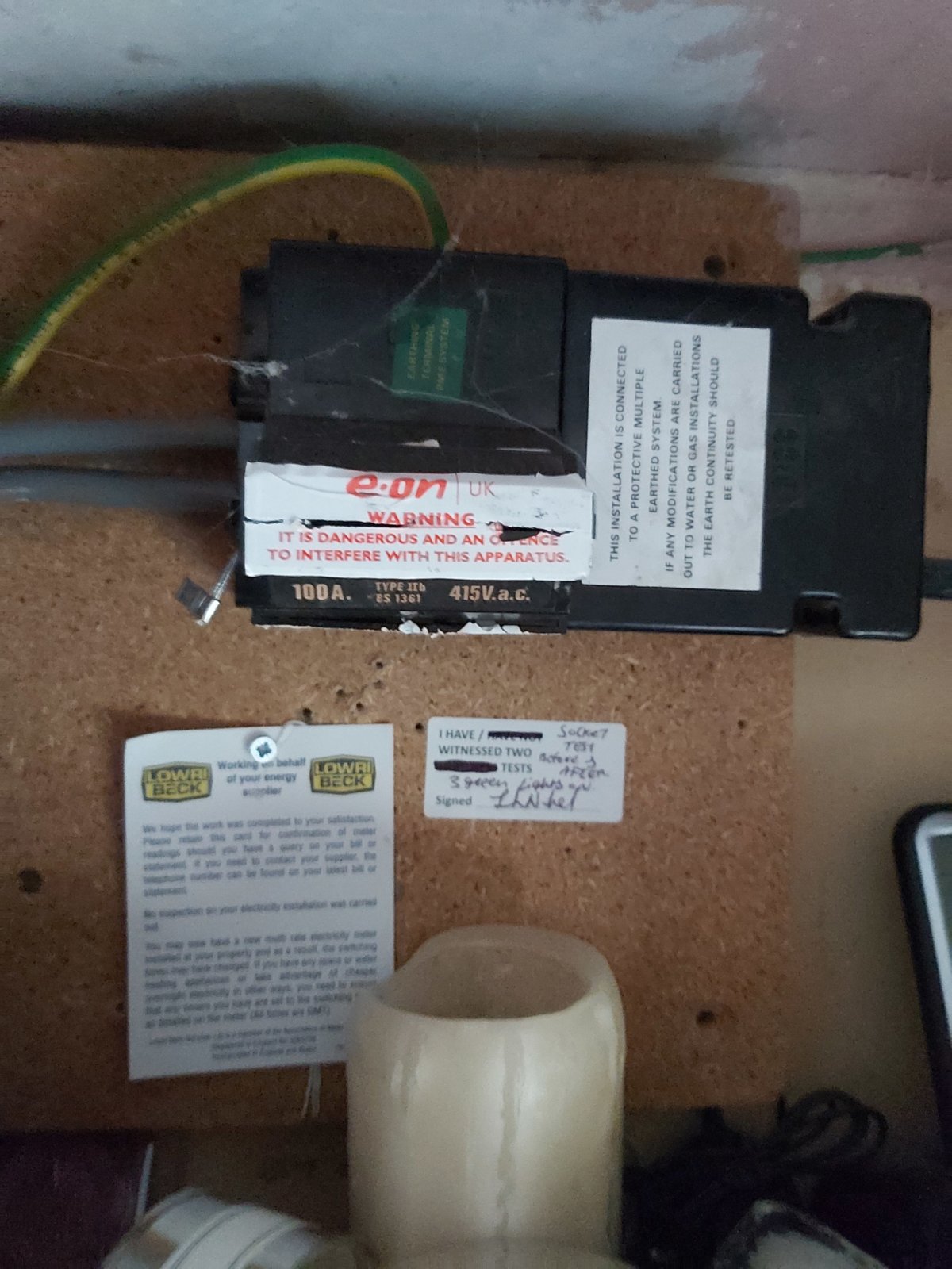

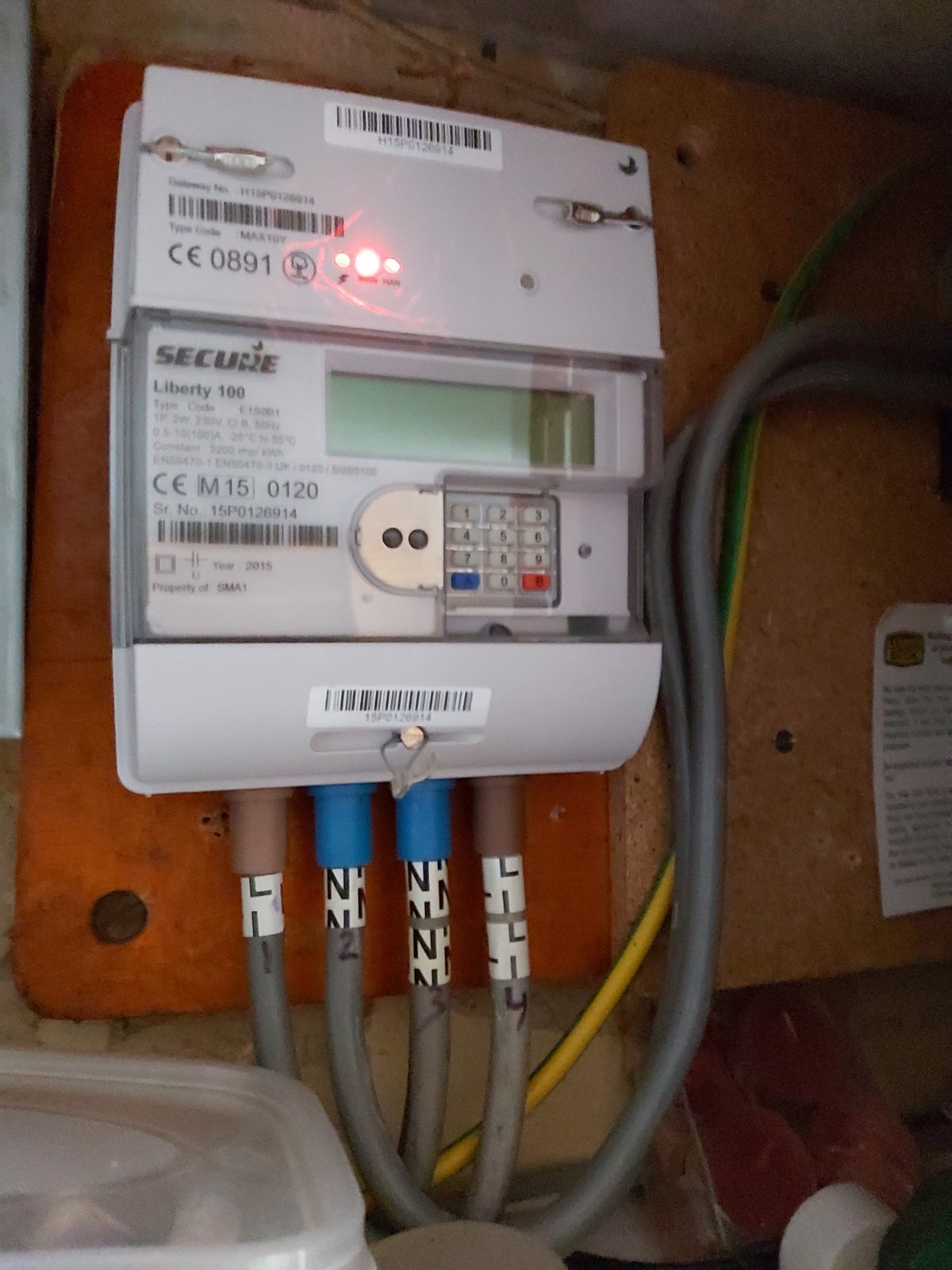

    Hi all,
    I live in a 1950s semi, and a few years back we had constant issues with the electric tripping. Especially with computer equipment. It was discovered that both ours and the neighbours were using the same feed, so they split the feed and put us on different phases (I am not a sparky, so I hope I am getting this right).
    Generally all is good now, aside from our new dyson, which trips the electric most times we try and use it. We have also borrowed a friends dyson, and that trips it as well. Is there any way of preventing this?
    Cheers

    Can you post a picture of your meter/consumer unit?
    Is it only the hoover that trips it?
    Always the same socket, or at different points in the house?

  6. jelliottelectrical
    jelliottelectrical
    Joined:
    14 Nov 2013
    Messages:
    122
    Thanks Received:
    18
    Location:
    Warwickshire
    Country:
    It could also be that the rcd itself is faulty, as it is an older unit, but as above it needs testing with a proper rcd tester.
    Out of interest how is the property earthed? Could you post a picture of your meter/cutout

  8. jelliottelectrical
    jelliottelectrical
    Joined:
    14 Nov 2013
    Messages:
    122
    Thanks Received:
    18
    Location:
    Warwickshire
    Country:
    If that’s the case is there another trip switch between the meter and the consumer unit? As with a TT system as you have described the non rcd circuits on that consumer unit will not disconnect under a live - earth fault, generally speaking

  11. jelliottelectrical
    jelliottelectrical
    Joined:
    14 Nov 2013
    Messages:
    122
    Thanks Received:
    18
    Location:
    Warwickshire
    Country:
    Ah seeing that, it does appear to use the suppliers earth so disregard my last post. I would still recommend getting the rcd tested, as clearly something is not right

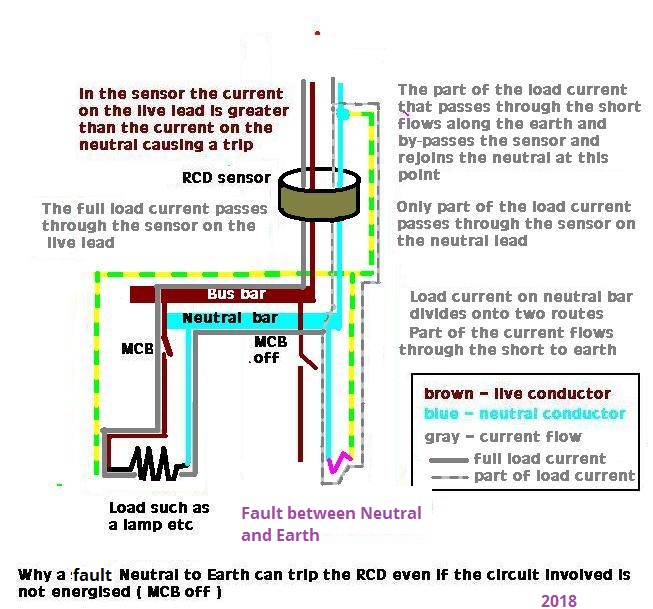

  15. bernardgreen
    bernardgreen
    Joined:
    3 Nov 2006
    Messages:
    26,044
    Thanks Received:
    2,595
    Location:
    Bedfordshire
    Country:
    It is most likely that the start up current taken by the Dyson's motor together with a "fault" else where are combining to cause the ELCB to trip.
    The "fault" could be a genuine fault between Neutral and Earth or not a fault as such but a lot of mains filtering capacitors in equipment that provide a path from Neutral to Earth
    For most loads the proportion of current that goes through the fault and by-passes the ELCB sensor is less than 30 mA hence the ELCB does not trip. But the start up current of any motor is higher than the rated running current and the proportion of that high current flowing through the fault will be higher and this may be enough to cause the ELCB to trip
  16. crystal ball
    crystal ball
    Joined:
    28 Apr 2004
    Messages:
    5,539
    Thanks Received:
    340
    Country:
    I had a call out to a similar fault, RCD tripping when TV or fridge were plugged in, eventually found a fault on shower circuit
