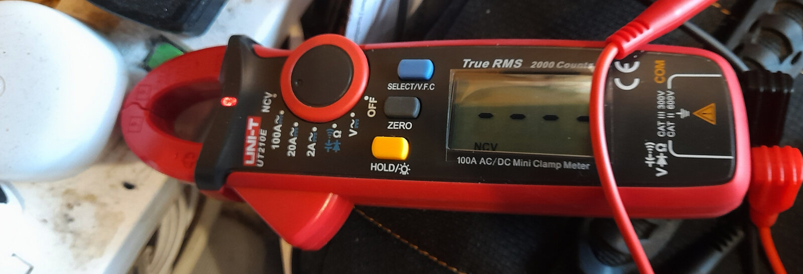

These VC60B.jpgTesting for live.jpg are the meters used, the first one uses 500 volt and is not really a DIY tool, the second measures the imbalance, they need skill to use, so it is a case of them returning to find the fault, and you clearly will not be paying them until sorted.
