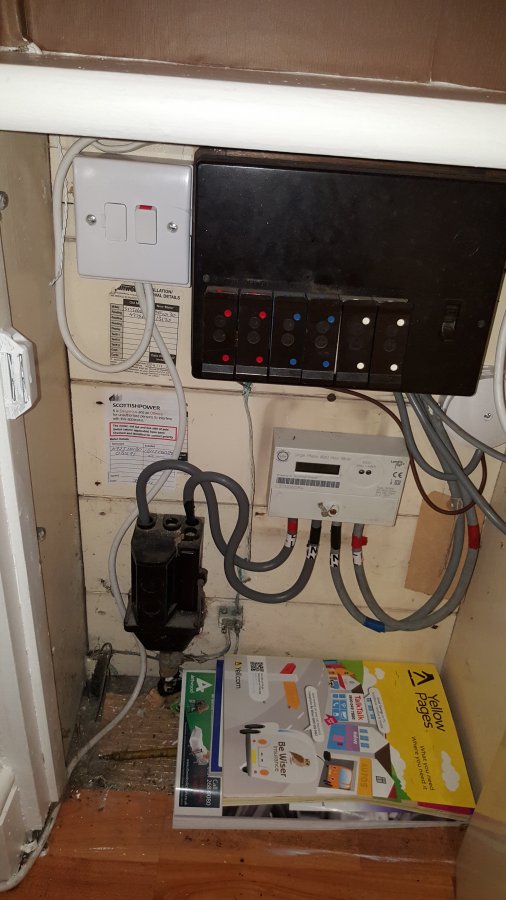

Ye, been there ,done that ! I was so skint i rewired my flat! Post some pics of your wiring including the fuse box and meter wiring then we can see how old it is.

Just posted a pic of fuse box
Had new conservatory with all new wiring... and there all handy man jobs. Sockets fitted all over the show added on over the years. Even them old sockets with no switch just plug in and it works.
