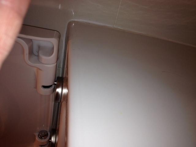

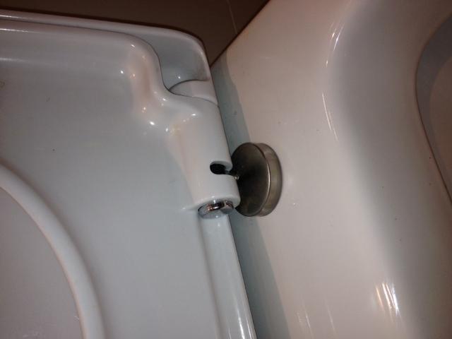

Hi,
This should be easy, but I can't work out how to tighten this toilet seat!
What am I missing?
Thanks in advance!
Notting
Push both chrome 'buttons' on the seat then wiggle/pull it off. From there the chrome caps come off the pins through the pan, and then you can tighten the screws.
They are a crap design and you will always struggle to get them really tight, and stay that way.
