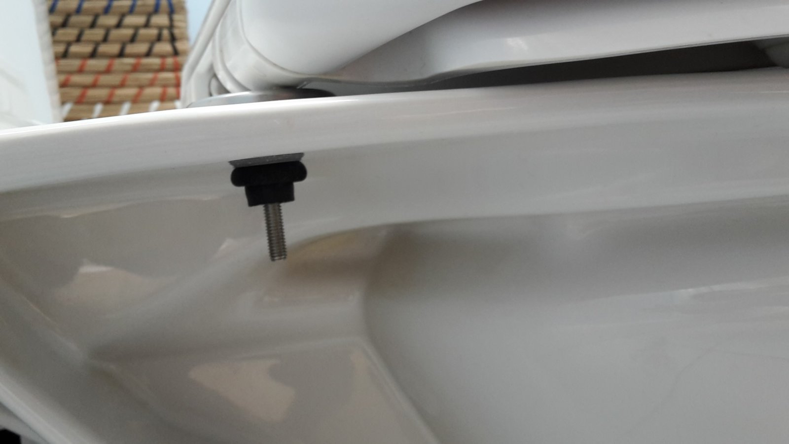

Hi,
I've tried an adjustable spanner (doesn't grip) and grippers. Shouldnt this be an easy job to tighten up a toilet seat? Am I missing a trick?

Thanks. I've worked it out. The toilet seat unclips from the screws so you can then tackle it from either side. It was so easy that I feel annoyed with myself!
Take the seat off, then pop off the chrome cover off the top and you should find a screw under there. Tighten that
