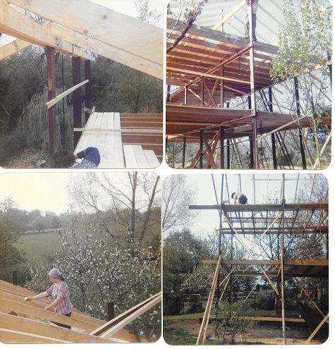

Timber frame or timber panels ?
This is true timber frame construction
