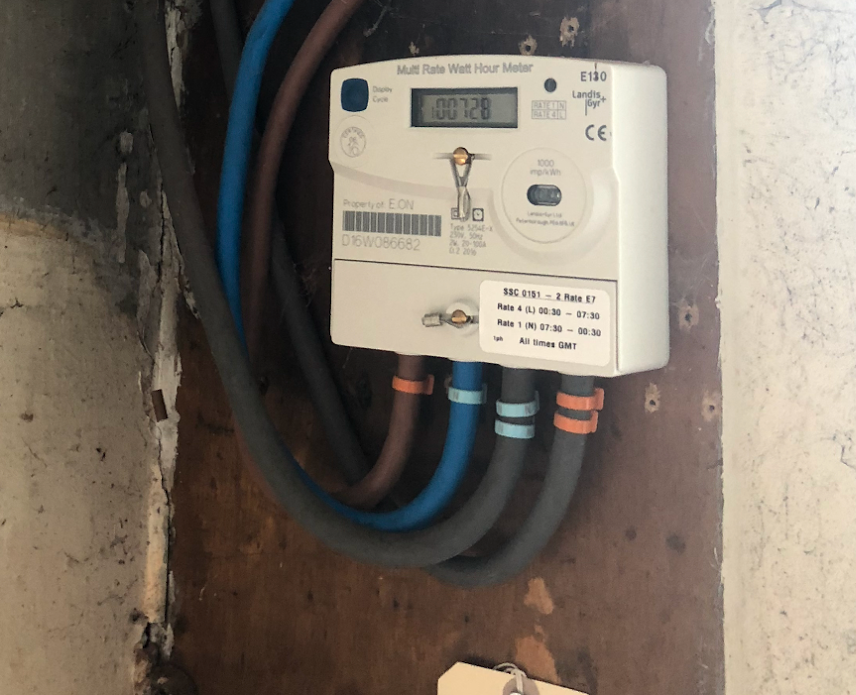

a guy on the EV forum posted this pic of what he has

There are two types of meter. 4 terminal - which means that the whole house goes onto E7 at midnight etc.. and a 5 terminal one with effectively 2 output 'lives' one for E7 and one for the rest of the time.
The second one is the one you don't want.
When I chatted to the meter man, he had both on his van, I thought he'd be far more familiar with the idea of electric cars, but once I explained what I wanted, i.e the same as you, i.e the whole house to switch over, then it was ok.
