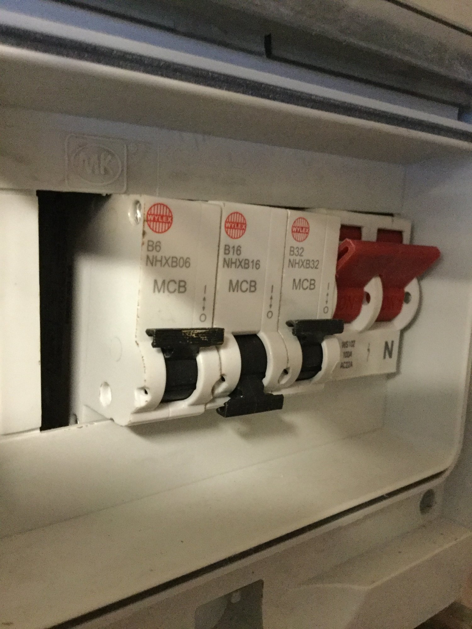

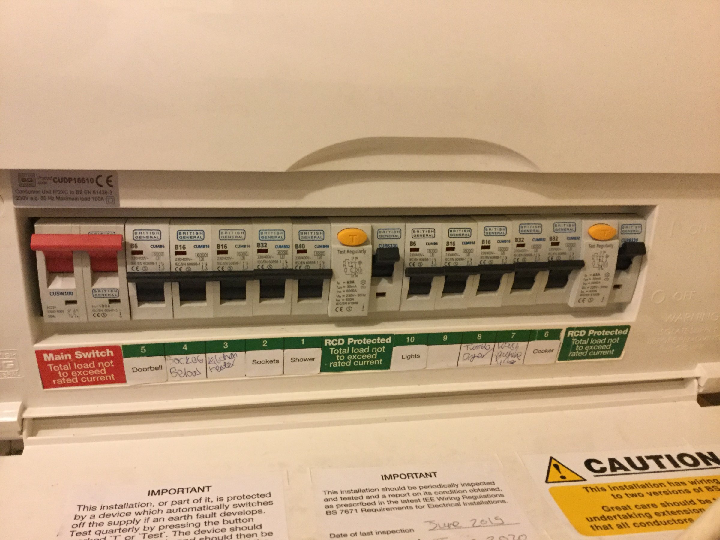

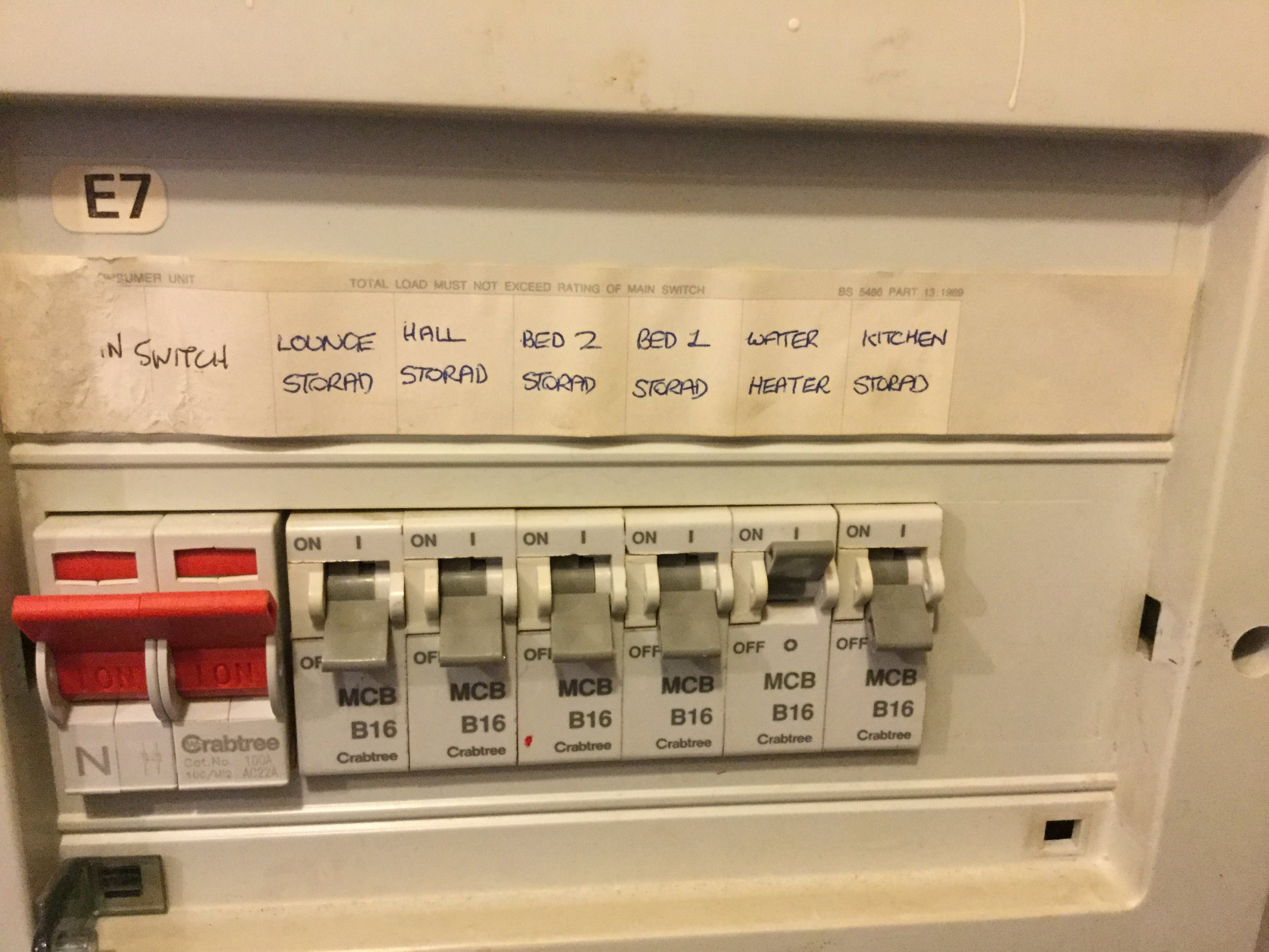

Post a photo of your meter, consumer unit and associated things.

Consumer unit
Economy 7 Consumer Unit for heaters
Outbuilding Consumer Unit
Based on that first photo, I reckon you get all your electricity at the cheap rate when it is active.
(I don't think I've ever seen an installation where this wasn't the case.)
Based on that first photo, I reckon you get all your electricity at the cheap rate when it is active. (I don't think I've ever seen an installation where this wasn't the case.)
It wasn't the case when I moved into my present house, nearly 30 years ago. It was on an E7 tariff. There were separate 'normal' and 'low rate' meters, the latter (just feeding storage heaters) supplied via a contactor (controlled by a timeswitch). Hence only the storage heaters benefited from the cheap rate.
