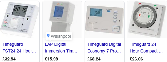

16 amps is the usual choice, example: https://www.screwfix.com/p/lap-digital-immersion-timer/1804r
A search for 'immersion timer' will reveal plenty of other options.

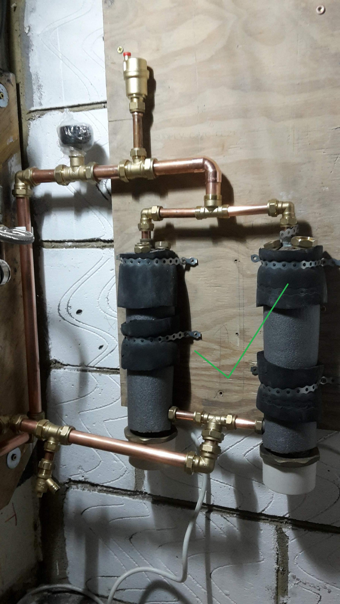

In this post I have shown pictures of my set-up, and talked about some of the options and costs.
It shows a picture of before
and after, this picture also shows the controller used, and how much I used in 7 days 1771514664379.png the advantage of the controller I am using is it shows how much I have used, I would not think an Iboost+ would help you, but it shows how much used. So standard tariff looking at £3.34 a week, with a split tariff, around £4.27 peak rate, and £1.14 off-peak so maximum saving is around £3.14 per week. It is unlikely your rates match mine of £0.085 and £0.32 per kWh, Eco7 tends not to give such a saving, I only have off-peak for 5 hours.
I agree if you have off-peak, you want to use it, but the figures you quote, makes me think something else is wrong. There is a whole range of timers 1771515575051.pngto show just some, but it may not need a timer, my home was never designed for an off-peak supply, So just a single immersion heater, I could get the dual model 1771515868266.pngbut for me it would not help. The

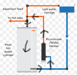

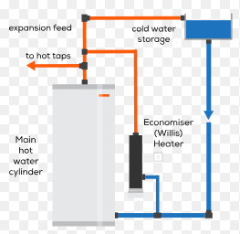

bath and sink, the Irish, I must take my hat off to them, worked out a far better way, 1771516303518.pngthe Willis system heats the cylinder from the top down, so the longer you run the immersion heater the more hot water you get, so you could if you so wanted, have a range of thermostats at diffrent hights and select how much DHW you want. The Willis system has been promoted for solar panel use of late, as it will give hot water with little or much sun, and store the extra when the sun shines, but the English and Welsh plumbers don't seem to be able to get their head around the system, seems the Irish are anything but tick.
.... the Irish, I must take my hat off to them, worked out a far better way, View attachment 408147the Willis system heats the cylinder from the top down, so the longer you run the immersion heater the more hot water you get ......
I think I must be dim, because I've always struggled to understand how the Willis system (as depicted in your diagram) can possibly work.
I cannot see why heated water from the Willis heater should travel downwards into the cylinder, which contains colder water. It will rise to the top of the column of water in the expansion/vent pipe, but I don't see why it should move downwards - and, since the connection to the taps comes off the expansion pipe below the connection to Willis heater, I would expect it to draw water (for the taps) from the colder water at the top of the cylinder.
What am I missing?
I assume it starts a flow, and the gate valve regulates the flow, but can't find the Willis website. I liked the idea, but I am not sure how it will work with varying output from the immersion heater? My immersion heater controller can run between 200 watts and 3000 watts, with pulsed DC, and I was not willing to take the plunge when I simply don't know how it would work.
I note there is a heat exchanger version for use with wet solar panels. There have been a few Irish inventions, 4 wheel drive cars with motorcycle engines, and the gyro-copter which I sat in the transport museum in Holywood Ulster Transport Museum a few times, it said there was an unrecoverable fault, which could cause them to fall out of the sky, but did not say what.
I was working in H&W for a time, and it was very interesting.
The heated water will rise up through the heater via thermosyphon, as it does it draws cooler water from the bottom of the cylinder, heating the cylinder from the top down.
As I said, with a Willis system simply as shown in the diagram you posted, I cannot understand how heated water would/could ever get into the cylinder. Nor can I see how any valves could alter that. I find it hard to believe that anything other than a pump could force heated water(hence lower density) to travel downwards into/through cooler water, despite gravity and Mr Archimedes.
Maybe the system is significantly more complicated (perhaps including a pump) than your diagram (and most other diagrams one sees) suggests?
I'm still pretty lost! ....
When all taps are closed, a small amount of water heated by the Willis heater will rise up into the expansion pipe, with the displaced cooler water moving downwards into the cylinder and/or the feed from the Willis heater. Since no water is being drawn, no water will be drawn from the bottom of the cylinder. So long as the taps remain closed, I cannot see why water at the top of the cylinder should get significantly heated - which would mean that there would be no significant heating of water in the cylinder whilst the taps remain closed.
When tap(s) are opened, water flowing to them will be a mixture of that from the top of the cylinder (which I would expect to be pretty cold, if taps had previously been closed) and from the Willis heater, the proportions via those two routes being determined by the relative resistances to flow in the two routes. What comes out of the taps would therefore seemingly be a mixture of heated water in the Willis heater (until it runs out) and of the (I would think cooler) water in the cylinder.
