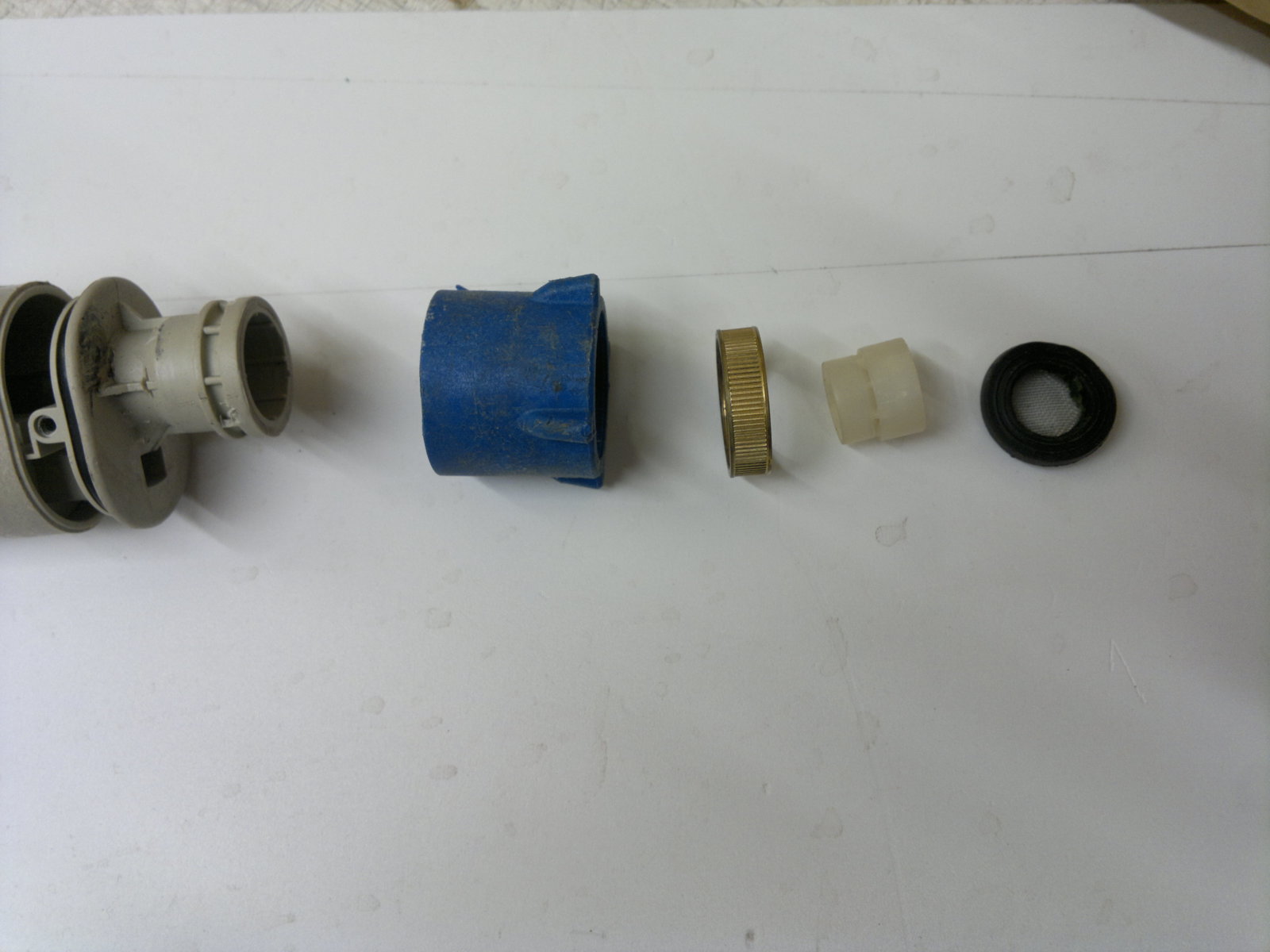

I took a hammer and chisel to one of these to find out why it was leaking from around the blue top part.
A german made part - very tough. AEG spares reference: 3792785028
https://www.espares.co.uk/product/es1405845/washing-machine-inlet-hose
Repair should be much simpler than one might think, and an all round wind up - prompting me to post this.

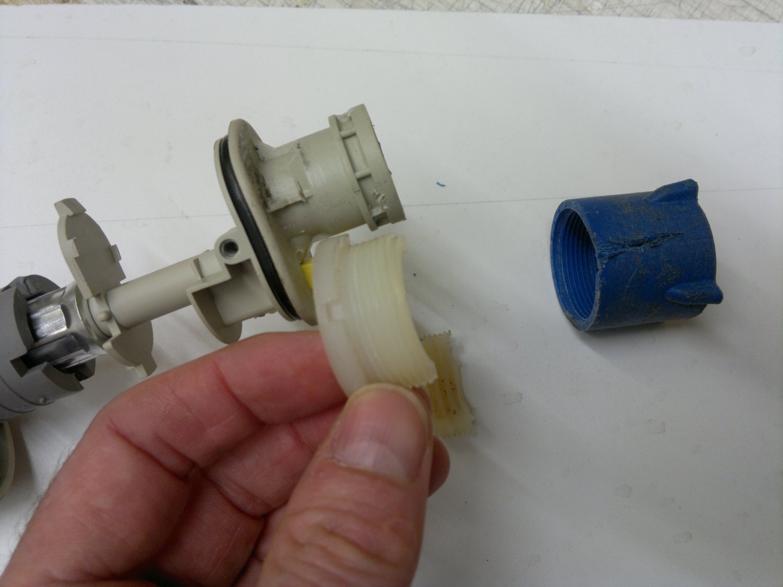

I believed a rubber seal had perished somewhere inside I couldn't get to - ie under where the ratcheted blue and cloudy white plastic components spin around (with yellow latch pushed in), I put my mouth over the blue component and finger over the other end - and blew - air escaped when I turned the ratched blue part.
But I was wrong , and need not have smashed mine apart.

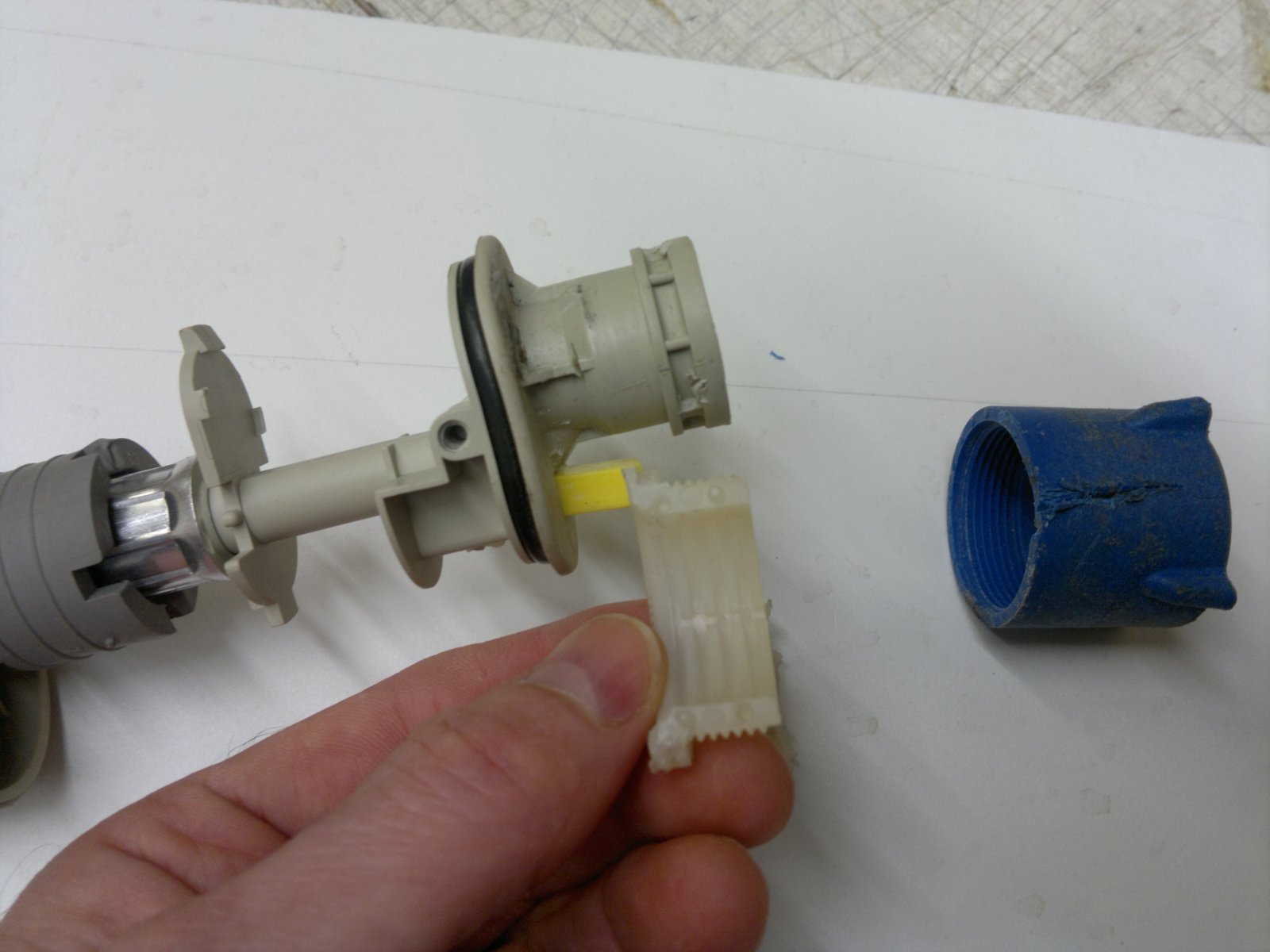

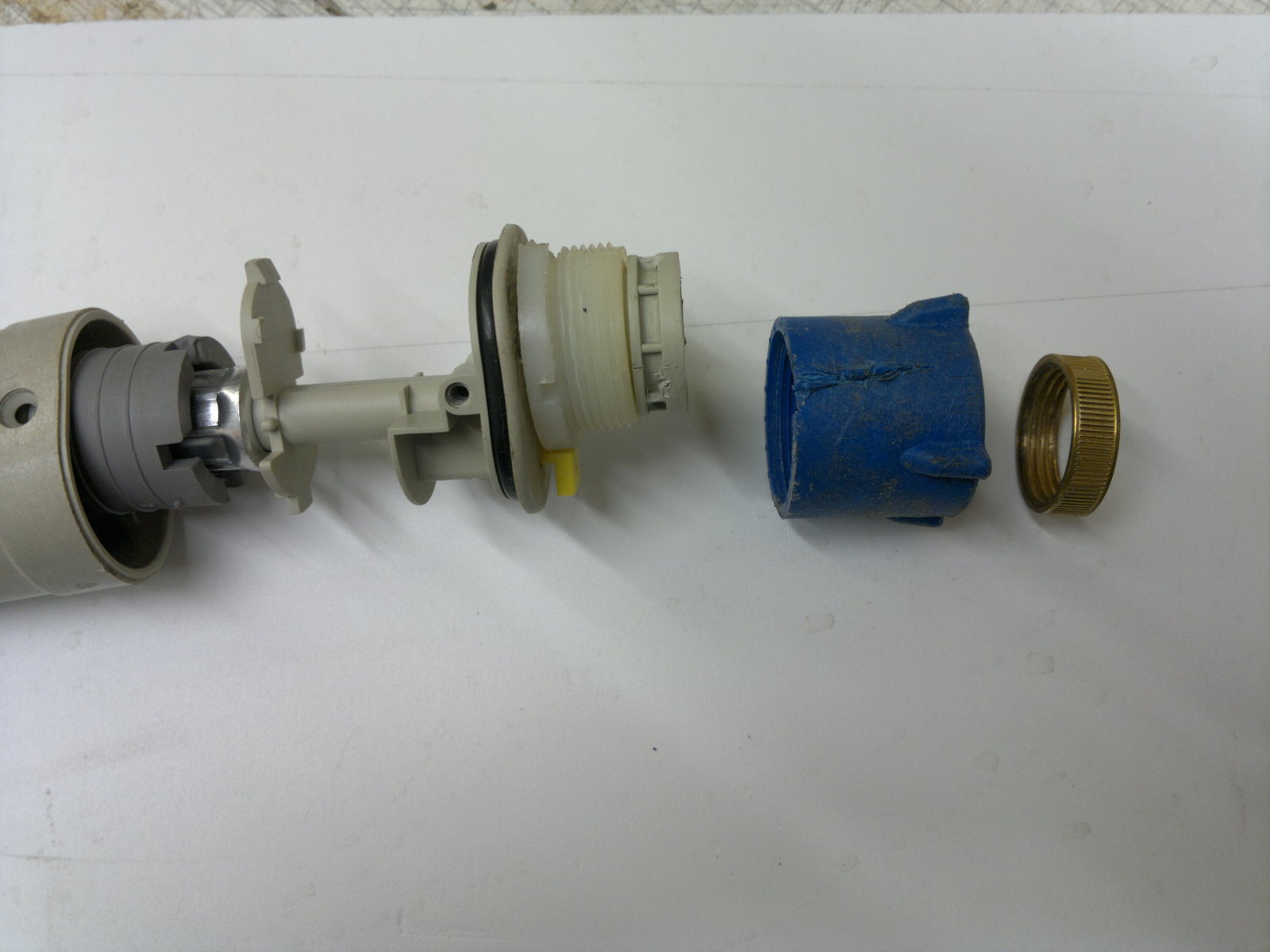

Having chiselled off the blue component - it appeared that the blue part is threaded, and screws onto a split plastic component that acts as a retainer (the cloudy plastic part in my finger).
I couldn't see any 'hidden' rubber seals that allowed the blue part to rotate but hold back the water pressure, it was much simpler than that.

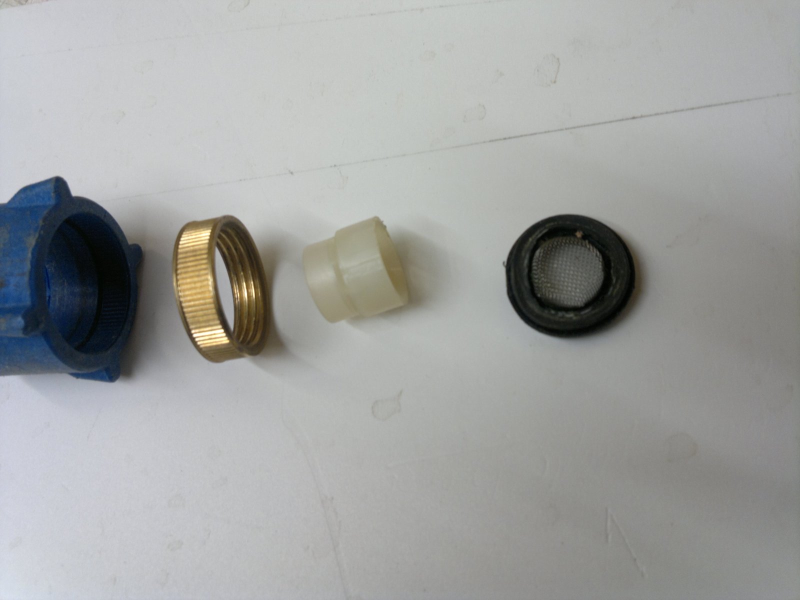

Once removed - you can see that the simple rubber seal with gauze that sits inside the blue part - is pressed against the top of the lip of the lower part that the retainer fits around.
It appears this rubber part had stiffened and perished over age.
I have Googled to find a genuine replacement (EPP-WS 40010188)
- but so far no joy.
Ebay has equivalents:
