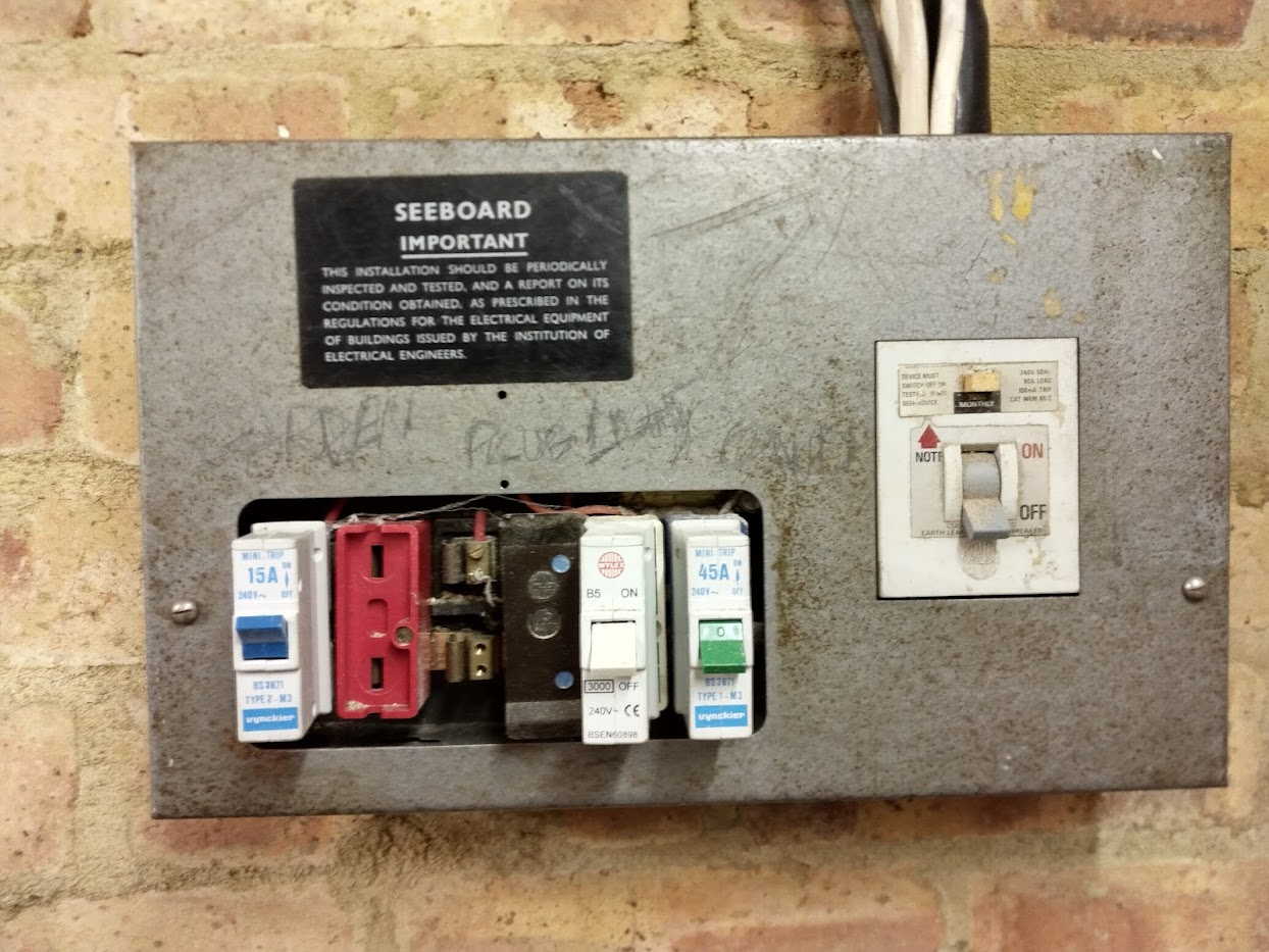

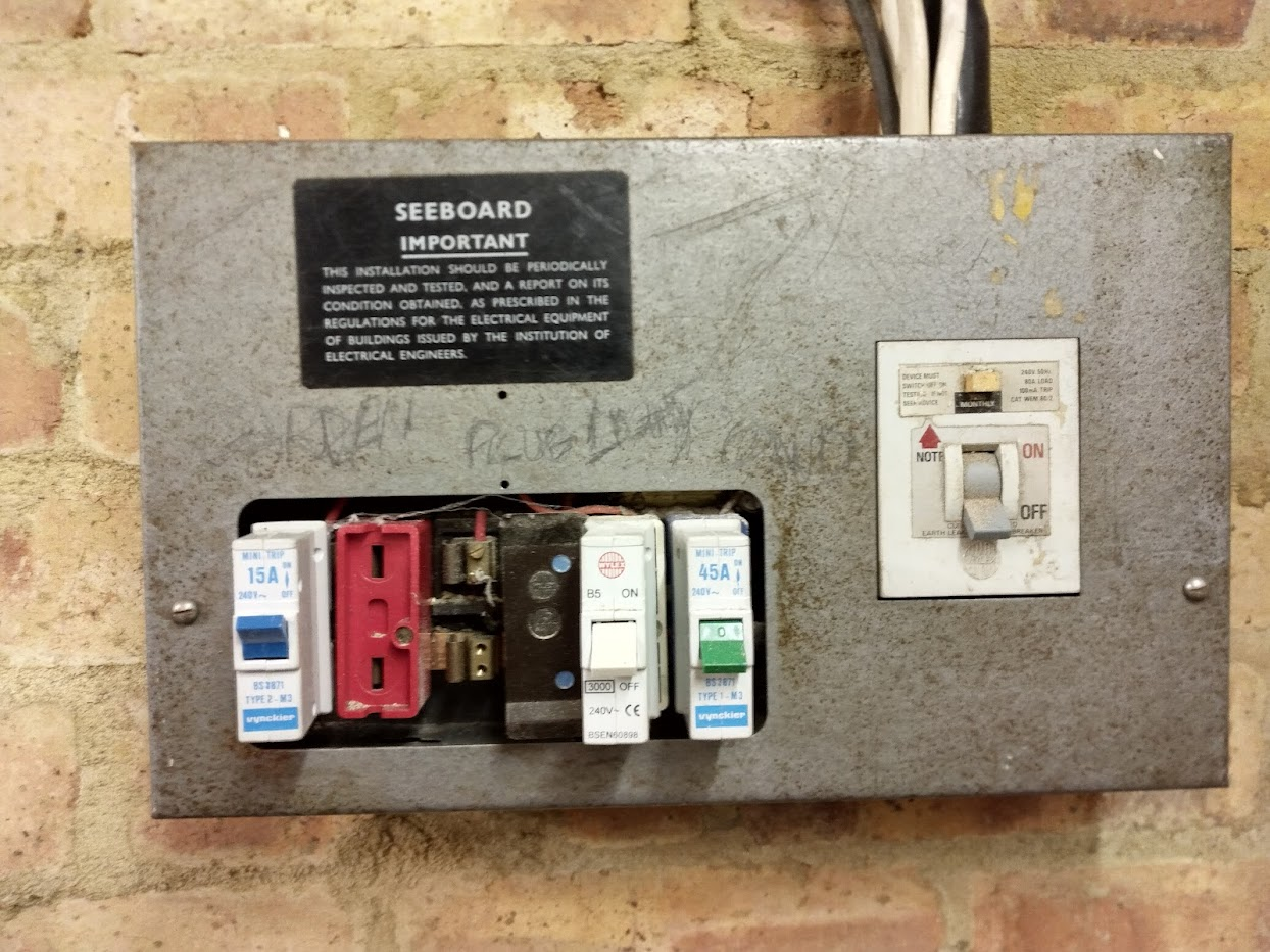

So the 'early next week' has been today.
Opinions on what this should be on EICR please :unsure: :LOL:
More pics to follow when internet access catches up.
Missing fusebase / blank - (C1)
Missing 'spark cover' where - It is necessary to maintain a suitable IP rating (C2)
...............................................................and where re-wireable fuses are fitted (C2)
45A device in way not rated to accept it (C2)
Undersized wiring on 45A fuseway (C2) could be a C1 depending on what it goes to, looks like 1mm
No schedule or labelling (C3)
RCD is of type AC (C3)
Sounds like a laundry list, but I'm guessing sunray could probably fix most of them in half hour with bits from his bucket of spares
It's at the kind of point though, where if you don't have a bucket of wylex standard spares, then replacing the unit may well be the most reasonable option.
That's obviously true for many, but I suspect a good few others (like me!) do have a bucket full of what would be needed, without much opportunity to make any use of them!
Having said that, although it is metal, I think (but am not certain) that the RCD (of which there is only one) says that it is a 100 mA one, so that might be another reason for 'starting from scratch'.
Kind Regards, John
