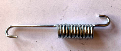

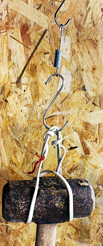

Update ... the infamous spring (and a new clutch cable) have just arrived (from Germany). The spring is very 'strong', and I anticipate that installing it will be an 'interesting' exercise. I really can't expand it at all by pulling 'manually' and, as you can see, it's not even significantly stretched by a ~6 kg sledge hammer! I'll report back when I have 'treid' (and hopefully succeeded). I hope to get it done over the weekend but, after that I'll be away for at least a few days, so it might possibly be a while before I can report back!!
Kind Regards, John
Try leaving the drive belt off, and swing the axle rearwards to connect the spring......then heaving on the axle itself to reconnect the belt.
I bet you’ve tried this!
John
I haven't tried anything yet but, yes, that's what I was planning to try. I have to hope that it works, such that I can rotate the axle enough to fit the spring without having to 'stretch' it at all, since to do such stretching would probably be very difficult.
I hope to get a chance to try in the next day or two - so 'watch this space' ;)

I have a metre length of high tensile wire - maybe half the thickness of fencing wire?
It has a hook at one end and bent to a Tee at the other. One good heave and it's there.
John :)
I have a metre length of high tensile wire - maybe half the thickness of fencing wire? It has a hook at one end and bent to a Tee at the other. One good heave and it's there.
That would be my usual first approach with a spring. Maybe it's just that I'm getting old (and 'weak'!), but with one end of the spring in a vice, the best I can manage by way of "one good heave" has little effect on the spring :-)
Kind Regards, John
Another weapon in my arsenal......
A length of 6mm threaded bar, heat flattened at one end and drilled to accept the spring hook.
A piece of flat steel bar spanning the area of the mower deck, drilled 7mm in the middle.
Spin a nut on the threaded bar and the spring will stretch without any trouble at all.
John
