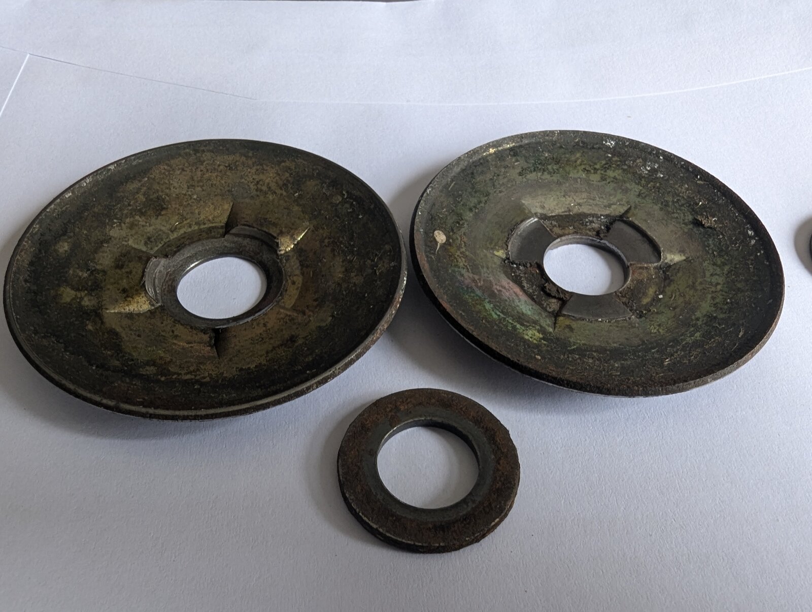

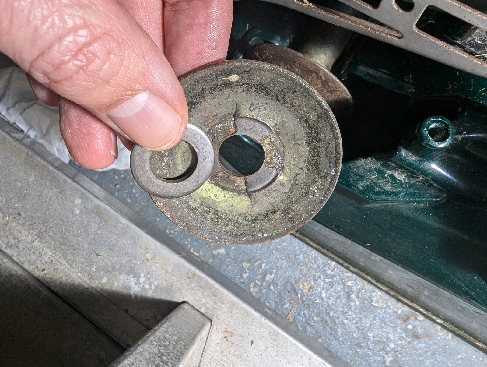

Thanks for the reply. I've taken the pulley components apart and the washers all appear to be fine, but the pulley halves (which should be identical) are both showing signs of wear to their outer surfaces, which may go someway to explaining how loose they are.
This is the outer pulley half with the indentation caused by an adjacent washer that also fits around the drive-shaft...
...and this photo shows indentations on the outer surface of each, for comparison. The inner pulley half is on the left, with an indentation caused by the part of the drive-shaft it butts up to. Note that the indentations are not identical, so aren't part of the pulley design and must have been caused by wear and tear. The washer in-between is the washer that sits between them.
While the indentations don't look like much, it may account for a good few milimetres of play in the system. Here's a photo with the bolt and outer washer removed and the remaining pulley halves and spacing washers pushed hard up against the opposite side. which shows a gap of around 4-5mm which is why they're so loose.
I'm thinking it might be worth buying two new pulley halves ? They are still available and relatively inexpensive (£6-8 each)

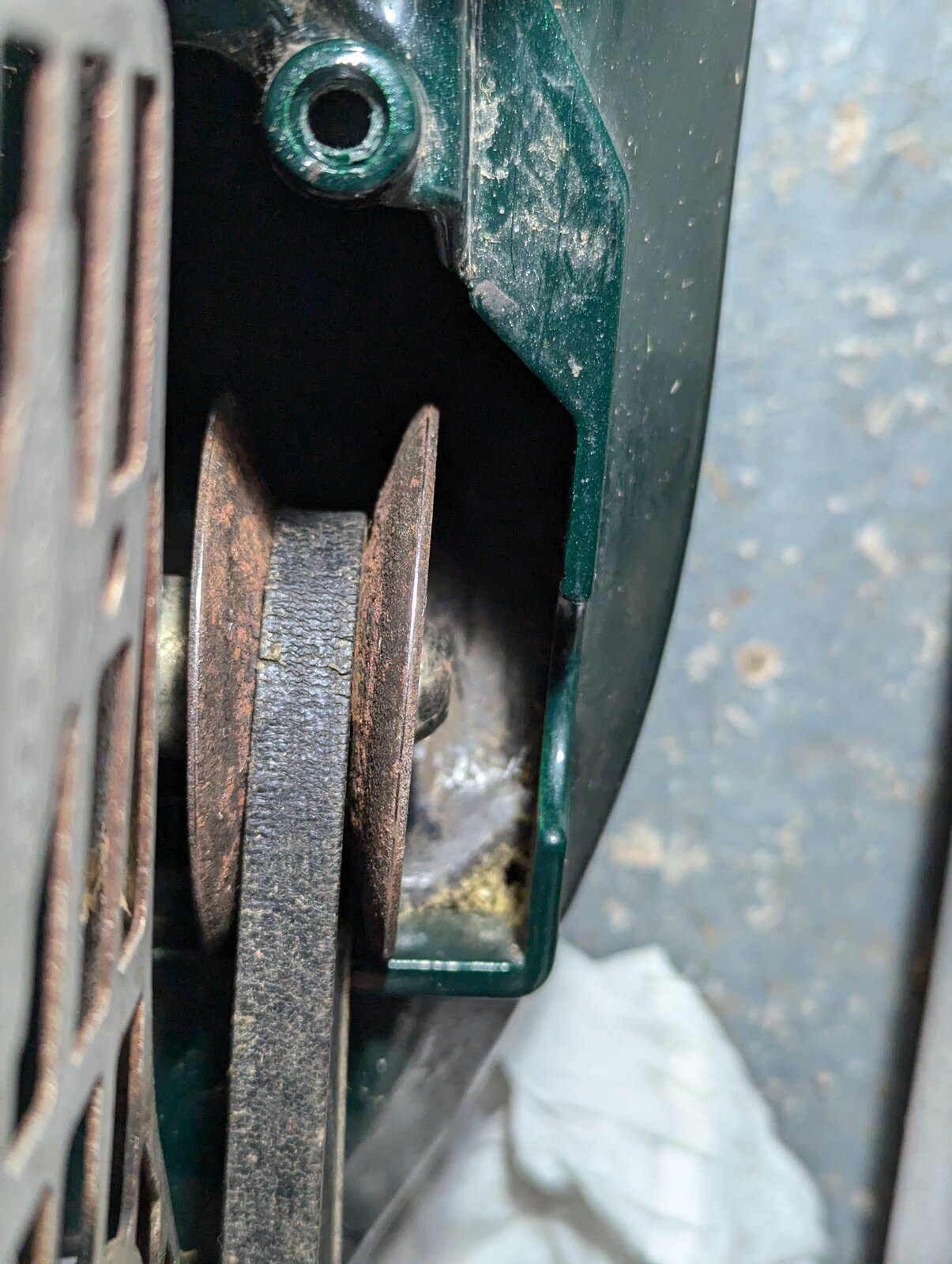

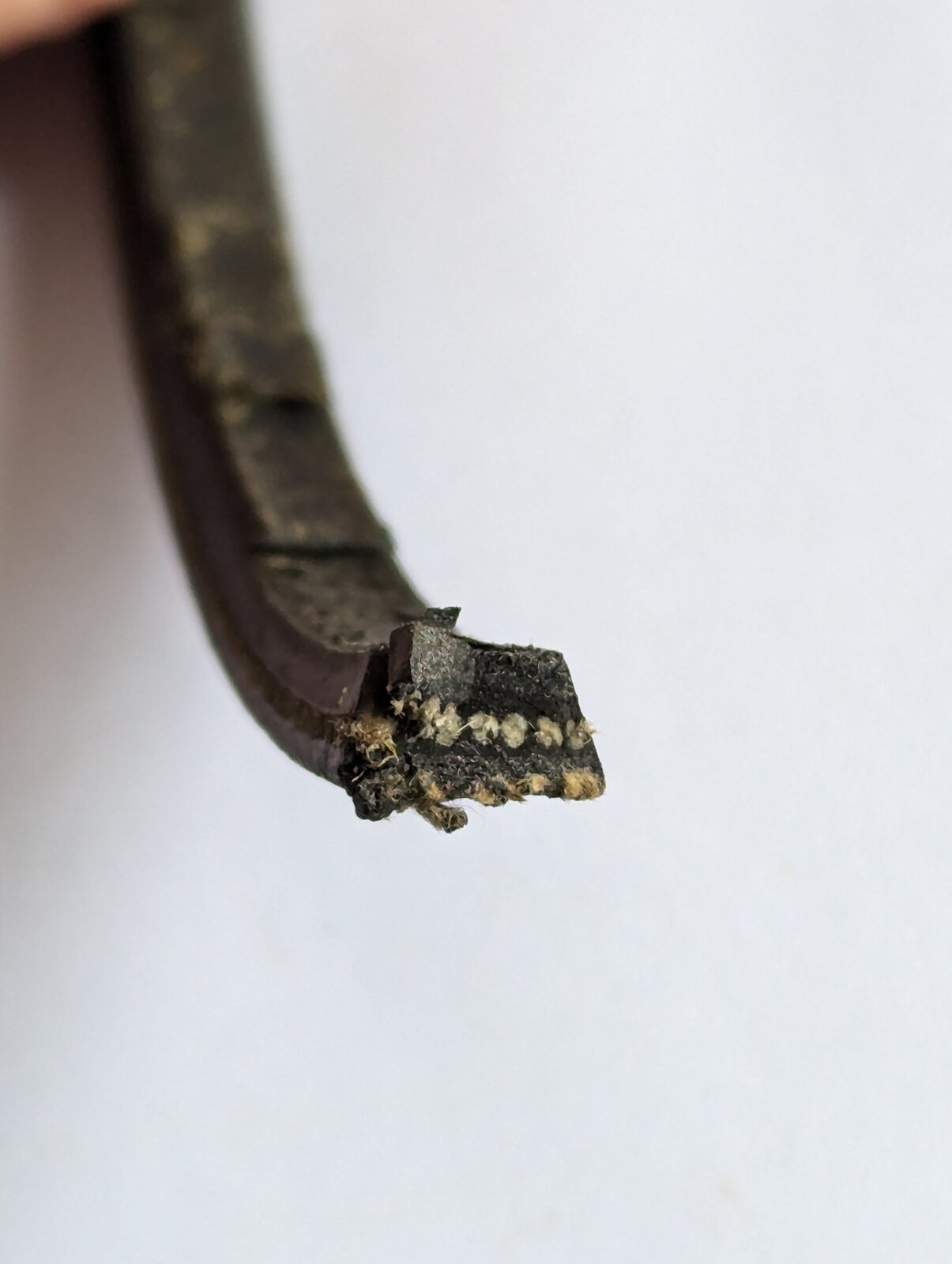

FWIW, this is the old belt - I cut it off years ago due to not being able to push the mower when auto-drive wasn't engaged, no matter how I adjusted it (I presume that it had stretched or worn down, meaning that I had to adjust it so far to one extreme in order to get it to pull that it was still partially engaged when the lever was released, giving far too much resistance and making pushing it manually almost impossible).
When the old belt is pulled tight temporarily around the pulley, the pulleys are still slightly loose and the belt sits so far down in-between them that it must surely be touching the washer that goes in-between the two pulley halves.
For the life of me I can’t see why that pulley needs to be split.....unless that’s the only way to get the belt on!

Looking at the pics again, maybe my comment about actually getting the belt on may be correct? Access looks pretty tight.
John
Yes, there doesn't seem to be a gap big enough to take the belt off without needing to remove the outer pulley half. It's hard to tell from the photos on the online listings, but it's possible that the (later) all-in-one pulley option was a bit smaller, which would allow for belt replacement without needing to be removed. There are definitely no springs in that part of the auto-drive system - it's just two pulley halves and two washers on the drive-shaft, with a bolt and outer washer holding them on.
I don't know much about these mowers but I think that the drive-shafts spin all the time on certain models and that the auto-drive lever simply pulls on the small tensioner wheel near the back roller, which pulls everything tight. I'm not really sure how this works, TBH. The pulleys are definitely free to spin on the drive-shaft, so the auto-drive system would need to be under a fair amount of tension in order to work, which was why I was thinking that the V-shaped belt would be forced down between the two pulley halves and push them outwards and up against the adjacent surfaces, providing the friction needed.

Yep - think it's looking like I'll need to replace both half-pulleys and get a new belt.
Apart from a snapped height adjustment bar (which looks like a common problem on these mowers, but a fairly cheap and reasonably easy fix), the mower is in pretty good shape and the Briggs and Stratton engine has worked flawlessly since 1997. The only thing I've needed to replace on it was one of the cables (clutch, I think). I've been neglecting the servicing a bit though, so will give it an oil and filter change while it's out of action.
