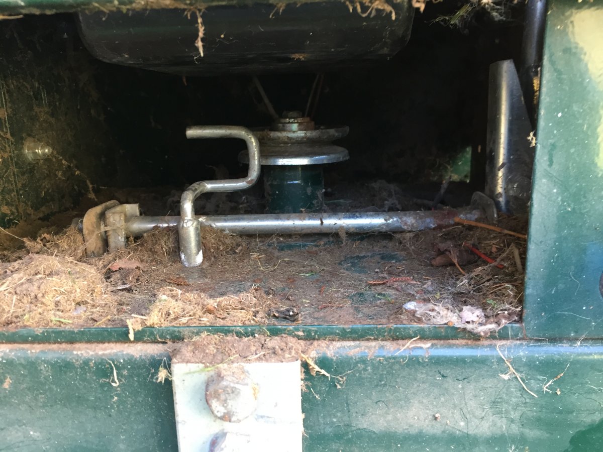

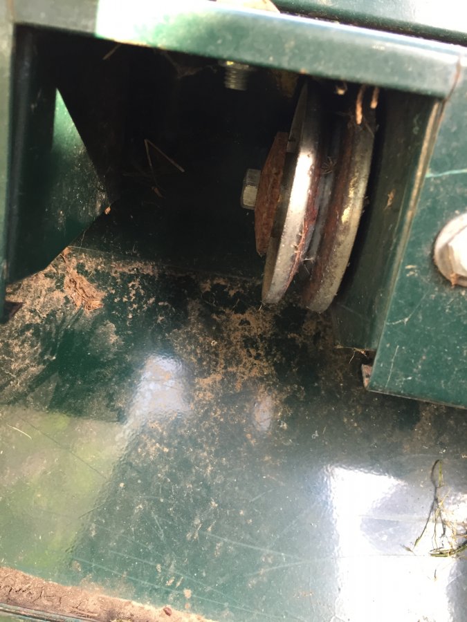

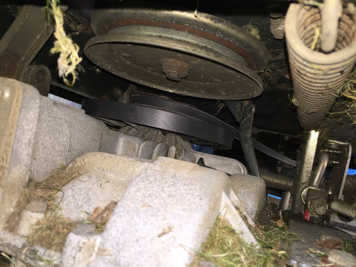

Yes, that's spot on and I think it might be the middle pulley that I'm missing. I have included some pics. The first shows the pulley on the mower directly behind the seat. The second the pulley on the collector. As you mention, these are connected by a belt which twists 90 degrees. The final picture shows the pulleys in the section on the mower under the section in pic 1. That third picture is not great but there is a pulley that runs from/to the bottom section of that unit to the main part of the mower. However, the top pulley (quite clear in the pic) does not seem to be connected to anything. When the PTO is engaged I assume (from your description) the pulley in pic 1 should drive the pulley in pic 2 and therefore the collector? I also assume that the pulley in pic 1 should be driven by the section in pic 3? However, pic 1 pulley does not move at all which I assume is because there is nothing connected to the pulley at the top of pic 3. Sorry, not the clearest of explanations but hopefully it sort of makes sense.
There are 3 belts in the current setup though (when the collector belt is in place) which seems consistent with your description and that makes me wonder whether I'm not missing a belt after all. Is it that the belt at the bottom of pic 3 should actually on the pulley at the top of that pic. Now I think about it this sounds quite likely as it is difficult to see what it is attached to currently - although, if it had slipped off, then I imagine it would be more obvious.

Ye gods, a head scratcher indeed! I'm just about certain this machine has 4 belts when everything is up and running......look at the main engine pulley - is there a spare vee groove there? I think a belt goes from the engine to that big pulley (last pic) and then to the other pulley in the corner of the chassis. This pulley is actually adjustable on a slot to allow belt tensions to be set.

Ok, will have another (closer) look. When you say vee groove, I assume you mean another pulley section/wheel to take a belt?
Actually, what does the belt running to the bottom section of pic 3 do? If there is a belt running from the engine end of the mower to the section under the seat then what would that be for other than powering something at that end?
I'm hoping that the engine has a spare 'vee' for that elusive belt ......that's what I meant by that one. Hell, there has to be some way of driving that PTO!
The large pulley you mention takes the belt clear of the transmission, if I remember - it was 10 years ago since one of these machines came my way....but we'll get there in the end!!

One thing I am still not clear on is why the belt running to the section under the seat wouldn't be used to power the PTO. I understand it takes the belt clear of the transmission but couldn't it be used to kill two birds. Also, inherited mower from wife's grandfather and he had looked after it well. I'd be surprised if there was a belt missing as a result. The main PTO belt was at the back of the seat - for example.

Anyway, I'd be inclined to follow the path of the horizontal pulleys and see where that path could go. The belt on these won't twist or rise or fall, it will be exactly in the horizontal plane - you can tell that by the truth marks on the pulleys. It therefore makes sense that another drive pulley would be around somewhere!
It does seem a good while since they operated though, looking at the rust trace. One minor discovery though, this system seems to be somewhat similar to the now obsolete Countax Rider 30 - so there may be something to look at there.
Here's a long shot.....the belt on the lower pic seem recent. Is there any possibility that a longer belt could actually connect to that large pulley after driving the transmission, so the engine would drive the transmission and the PTO using one belt? Ignore this if the pulleys aren't in alignment.
