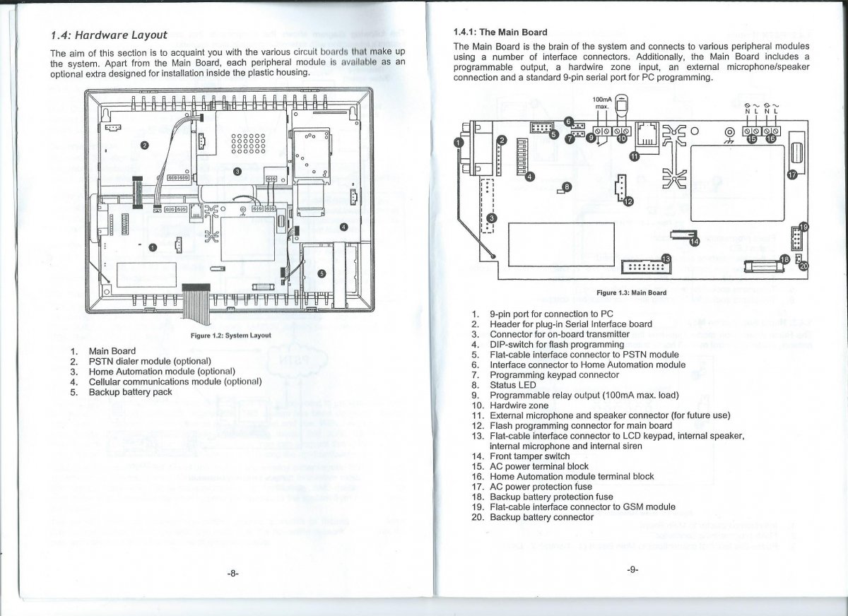

I've moved into a house with the old EL Infinite system (i.e. not the newer Prime models). The previous owners have given us the Master Code but not the Installer Code.
I want to run diagnostics to see what modules are installed (e.g. if there is no GSM module then I intend to install one, perhaps also tinker with the Home Automation module if it's installed). Anything I do triggers off the alarm so I don't want to do anything until I can somehow recover the Installer Code.
No reply from Electronics Line. These are 4 digit codes so 10,000 combinations ... I don't even want to think about going down that route. I suspect it locks you out after x number of incorrect attempts anyway.
Any ideas / recommendations?

The default procedure in the manual requires me to go into the programming menu which in turn requires .... the installer code :cry:
So what about just uninstalling the whole thing. What if I just cut the power to the house, unscrew the panel and disconnect the mains and backup battery. I've attached a scan from the manual, once the panel is off would it simply be a case of disconnecting 15 ("AC power terminal block") and 20 ("backup battery connector")?

I phoned the last time I needed to do one, the default procedure was involved.
the alarm functioning? you can completely down power it, depends on how its been programmed as to how it will behave.
