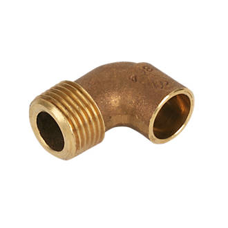

I have a shower mixer which doesn't have an inbuilt check valve and I was planning to add one in the space behind the body of the unit. Right now the way it is configured is this is attached to the 15mm cold feed and so the threaded end pokes out of the wall:
The showers flexi hose threads onto the male end shown above and everything (outwith the need for a check valve :rolleyes:) works.

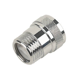

I need to introduce a check valve like this:
It makes a good connection between the male elbow and the flexi hope - until that is the body of the shower is offered back onto the wall, at which point the flexi hose is compressed and the flow is blocked.

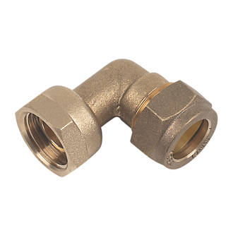

I attempted to add a right angle after the male elbow, so as everything would fit behind the body of the shower mixer. This would work in terms of space, but unfortunately I couldn't get a good seal between the male elbow (first pic above) and this bent tap connector:
Why does this tap connector not fit the male elbow???? :( I thought it was just a 1/2 inch thread that would be compatible with my elbow?

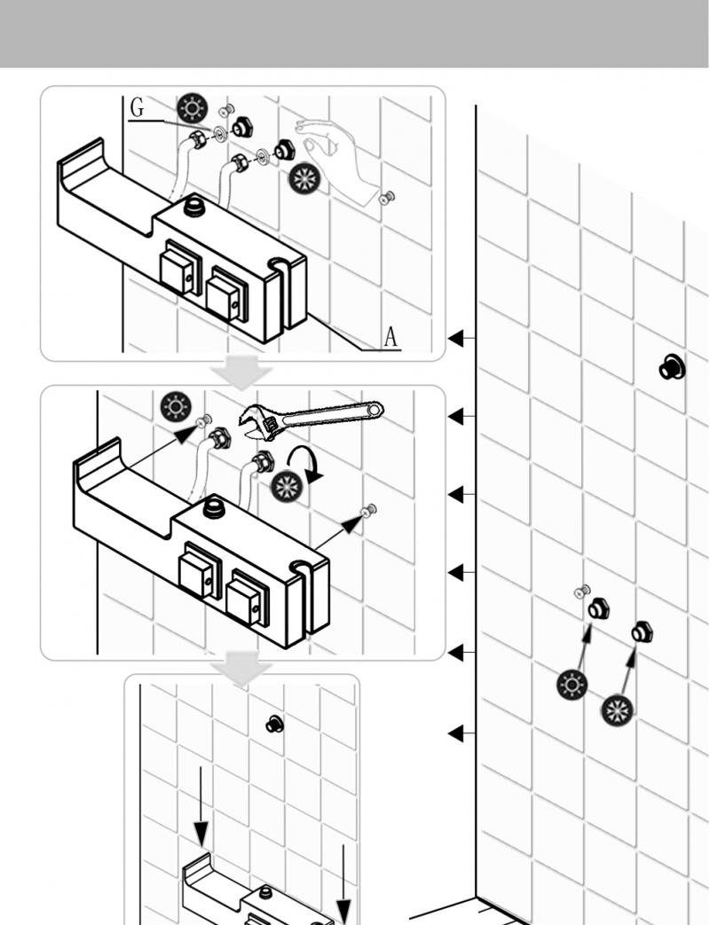

Pic/details of the shower would help.
Is it a Hudson Reed, multi outlet, hang on the wall, type unit by any chance?
NRVs usually go on the supplies before the wall outlet connections!
Can you not get to the supplies elsewhere such as in the loft or wherever they T off from other pipework?
Not without a LOT of hassle and work. Its one of these incidentally:
The tap connector has a little spigot inside which retains & supports the washer. This spigot will be too big to go inside the male elbow therefore the washer is not compressed between the mating faces. Therefore no seal.

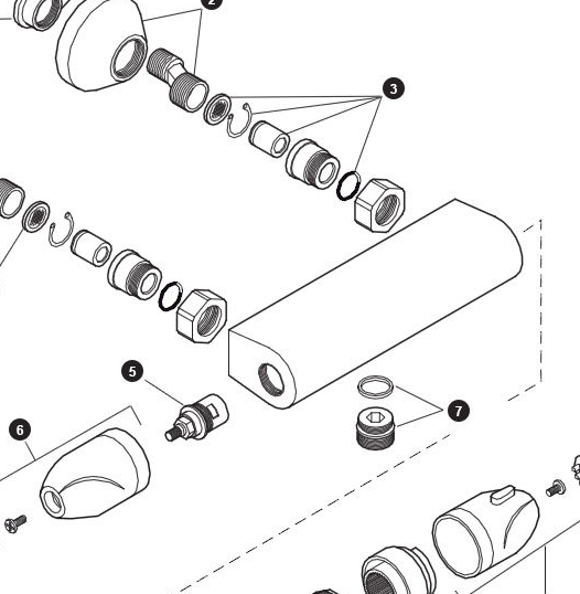

Are you sure that your shower valve does not have built in check valves which may have gone faulty or been lost during fitting?
The shower mixer valve looks unusual,can you post the name of the mixer or a pdf link of the install instructions. There may be a chance of fitting check valves in the shower mixer body.
Seems the hot & cold supply to the shower mixer are not of equal pressure :idea: are they ?
The shower below is a Mira Coda so not yours. All the bar mixer showers that I have dealt with have NRV fitted as below. It is the little cylinder that is held in place with a circlip. Many showers do not have a circlip so I have known them fitted without the check valve or with only one. If you knew the make & model you could buy replacements but showerdoc are quite helpful and may be able to advise. I think that if you remove the flexis from the valve body you will expose the place where the check valve ought to be. If you have one in there or two but with one of them broken getting replacements will be easier. Is it a new shower?
