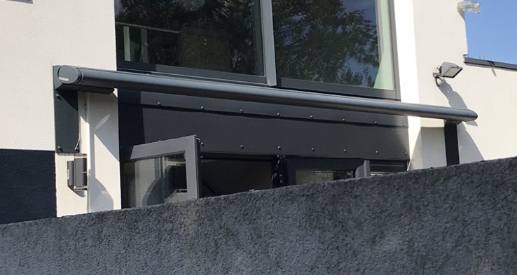

Spotted this in someone’s house and I wondered if anyone knew what the brand was and how easy they are to fit if my electrician wires it up for me?

The hardest , most critical, part is getting a secure fixing to the wall. The pull out force on the upper bolts is high when the awning is extended.
Looks like Weinor, even a slight breeze puts great pressure on the fixings, think of a sail on a yacht transferring the wind energy to forward motion
