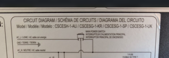

Electric Fan Heater Thermal Cut Off
That model number, on the label, traces to what appears to be the fan motor. Likely the heater model will be on a label on the outer case of the heater.
As Harry says the 16W relates to the fan assembly.
OK - but if the fan is 230V (and 16W) then, contrary to what Scally-Ho was suggesting, the heating elements will surely also be (wired for) 230V, won't they?
I believe it is quite easy to conclude that this unit containg a 230V fan and 230V heating elements is in fact designed for use on 230V.
Especially as:
Copied from the manual I linked to:
Copies from OPs photo:
As you will be aware, that is precisely what I have concluded (despite earlier suggestions to the contrary).

Thanks for the replies.
The elements are sitting slightly loose at present as I removed the casing around them to check. There are no issues with air flow, and the heating elements never glow red, which makes me think there is never any current passing through them.
I suggest that you TEMPORARILY short-circuit the thermal cut-out,
to see if the heater "operates" for longer than the few seconds that it now does
and
that the "elements" then start to heat.
Do not carry out the test for longer than about 30 seconds
but,
if the "elements" do start to heat,
you will have proved that you have a faulty thermal cut-out,

There are better (safer) ways to check if the thermal cut-out has operated, i.e. measure the voltage across it.
But my feeling is that if you don’t know how to “debug” a basic circuit, then this high-power potentially-dangerous device is not the project where you should start.
